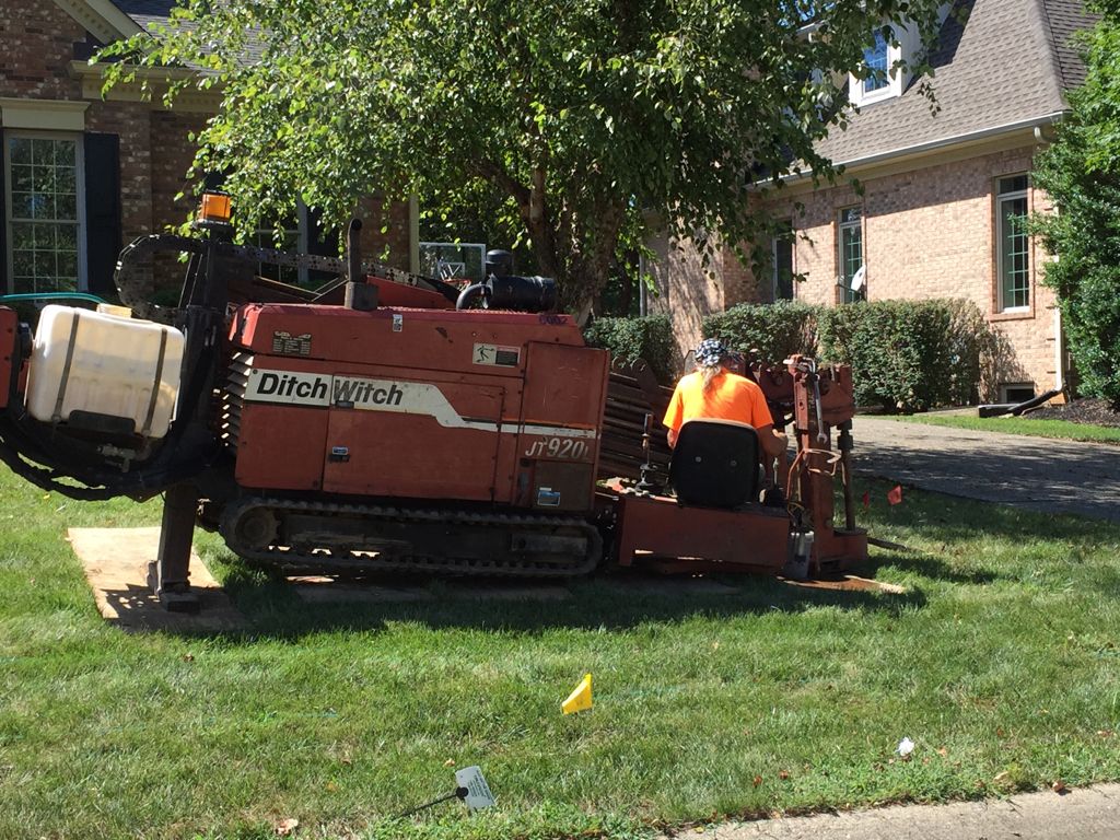

If you got money to spend call out the big boys to Directional drill 3 or 4 foot deep and have them pull a couple of hdpe pieces. :) I don't have the cash or I would do (2) 4" from satellite garden to house.
I'm in love with these drills lol
