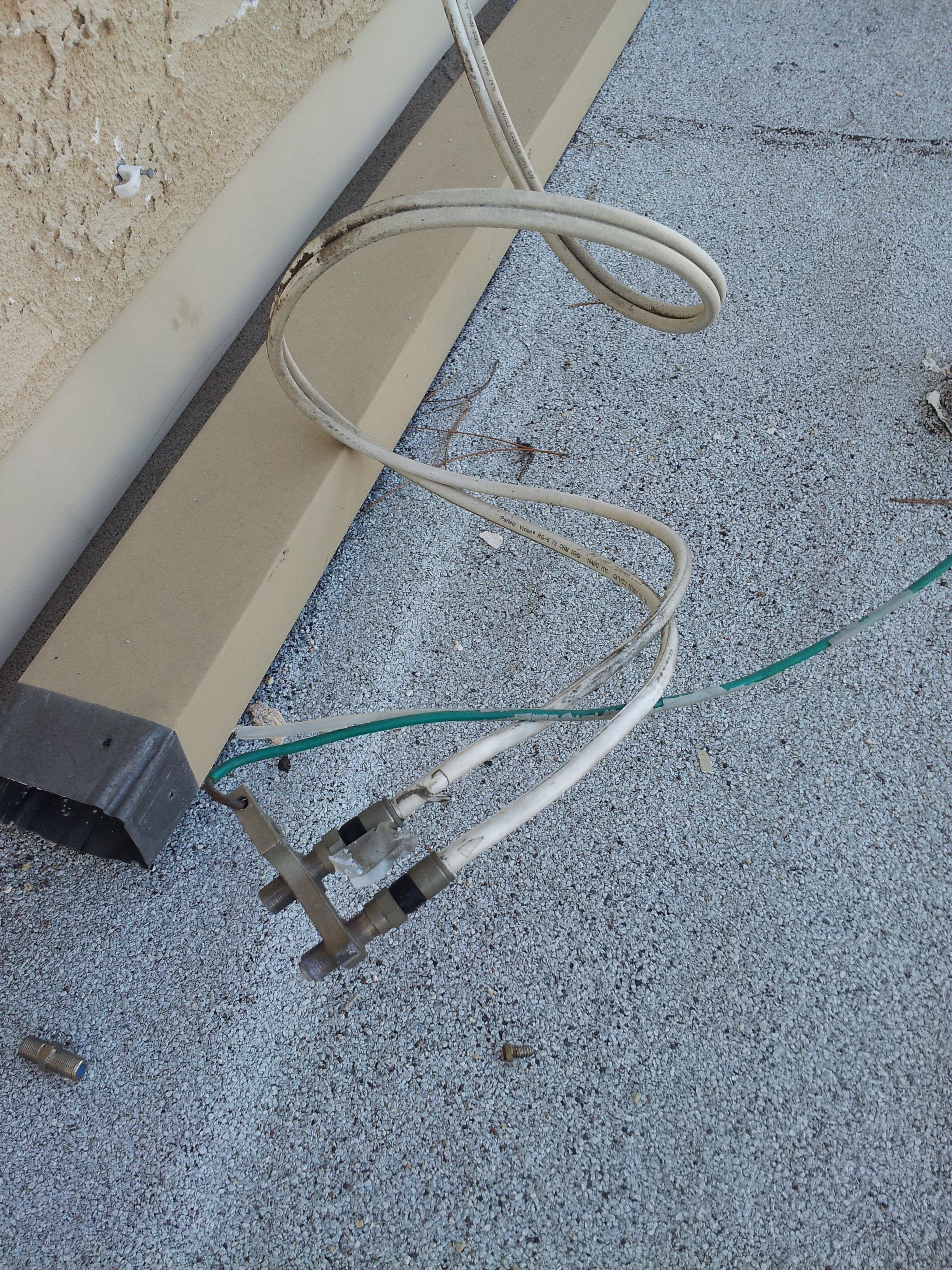

It has two wires coming off of it that are connected to ground (see picture): 20120530_175201.jpg

You can run 2 lines from the ground block straight to the receiver. All you'll need is 2 BBC's or you can swap the LNB for a SWM3 or 5 (depending on location) add a power inserter and you're good! You won't need a splitter for just 1 receiver
:welcome to Satelliteguys GabeA23!
If there are two lines coming from the dish, then it's not a swm type. If you are using a receiver, then connect one line to the back using a bbc inline, IF it's not an H23. If it is, you don't need the bbc. If you are connecting a dvr, then use both lines and bbcs on both of them like Hutch mentioned, unless it's an HR23 model. Then you don't need them. Good luck and come back and ask more questions if you need to! BTW, no power inserter is needed.

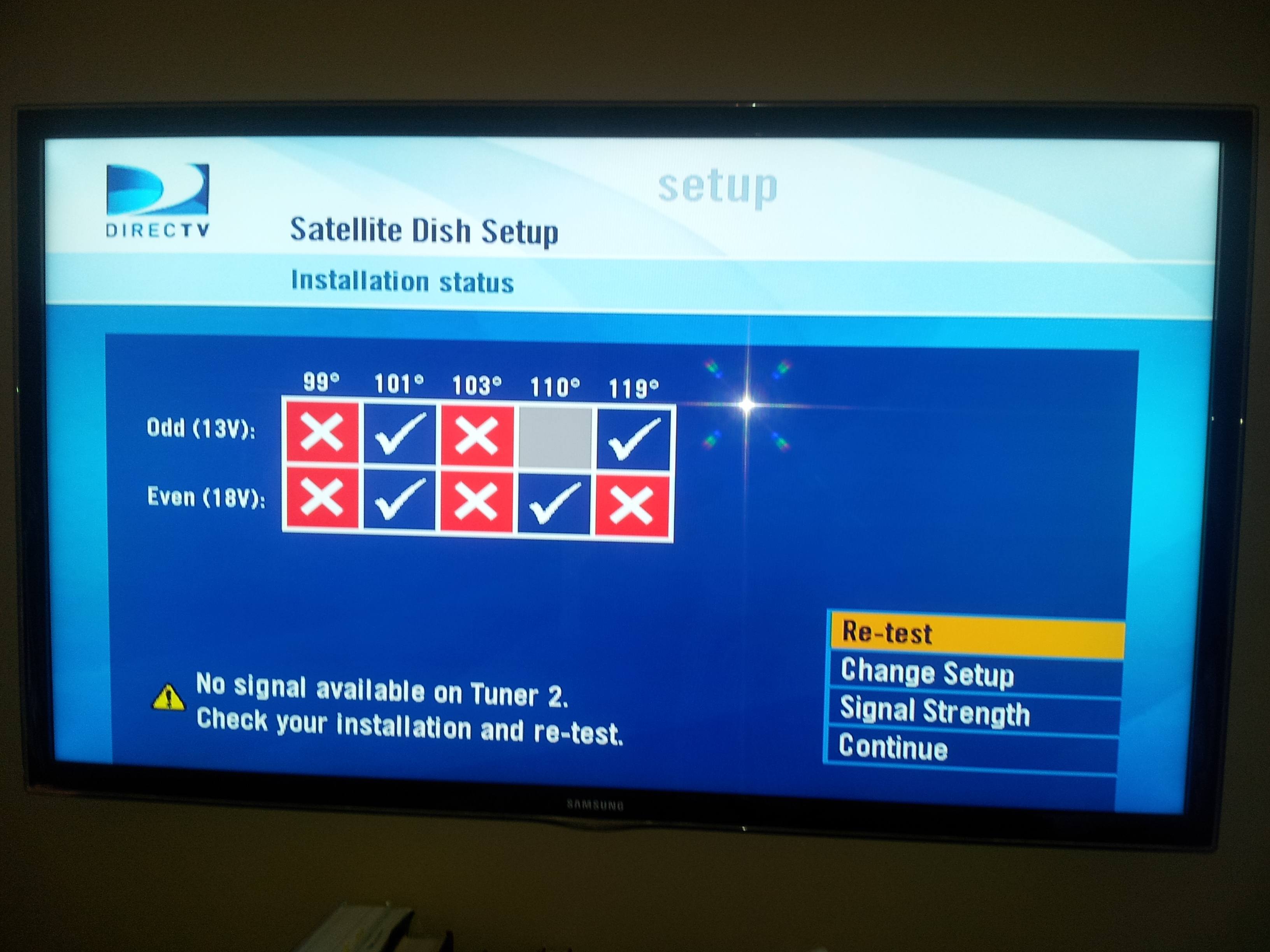

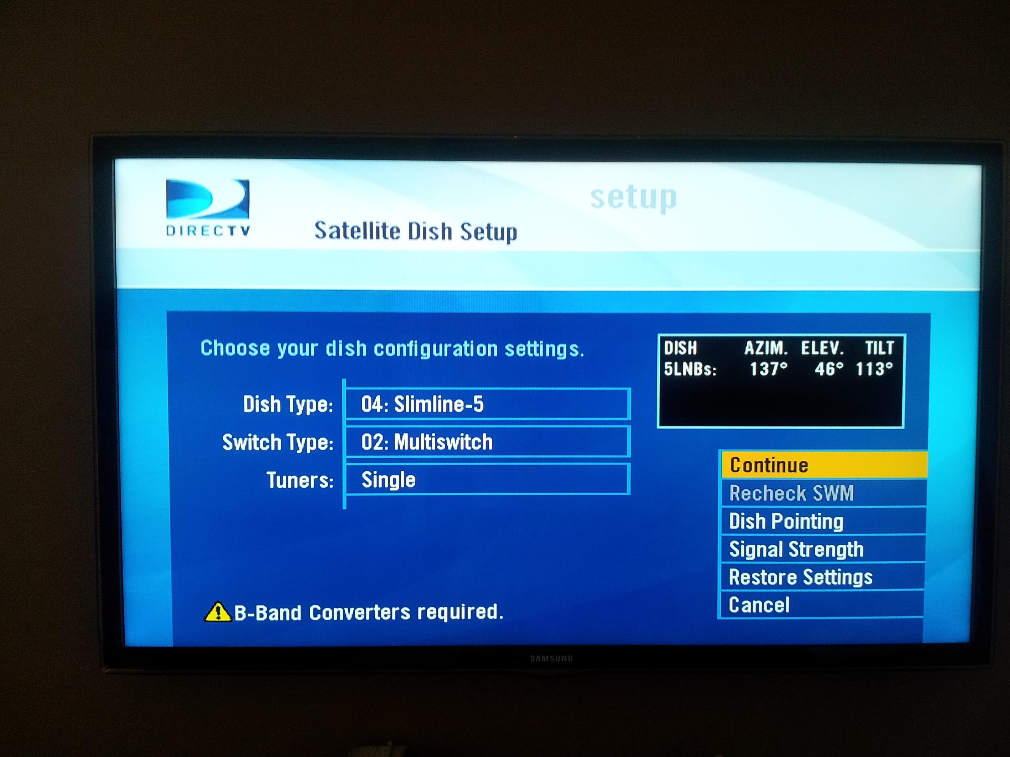

Woooo! Got it setup and it works beautifully. I'm not getting a fair number of channels that I think I should be getting. Could this be due to the fact that I inputted my dish as a "Slimline 5" during the dish setup, since there's no option for an AT9? I've included two pictures of what my configuration settings look like.
Thanks again!
-Gabe
Thanks again!
-Gabe
<img src="http://www.satelliteguys.us/attachment.php?attachmentid=77688"/><img src="http://www.satelliteguys.us/attachment.php?attachmentid=77689"/>
You're missing all kinds of channels I bet! Your dish is either way out of wack, your LNB is bad, or you failed to put on BBC's
I'm guessing your alignment is off. Can you post your signal strengths for all of the satellites?
