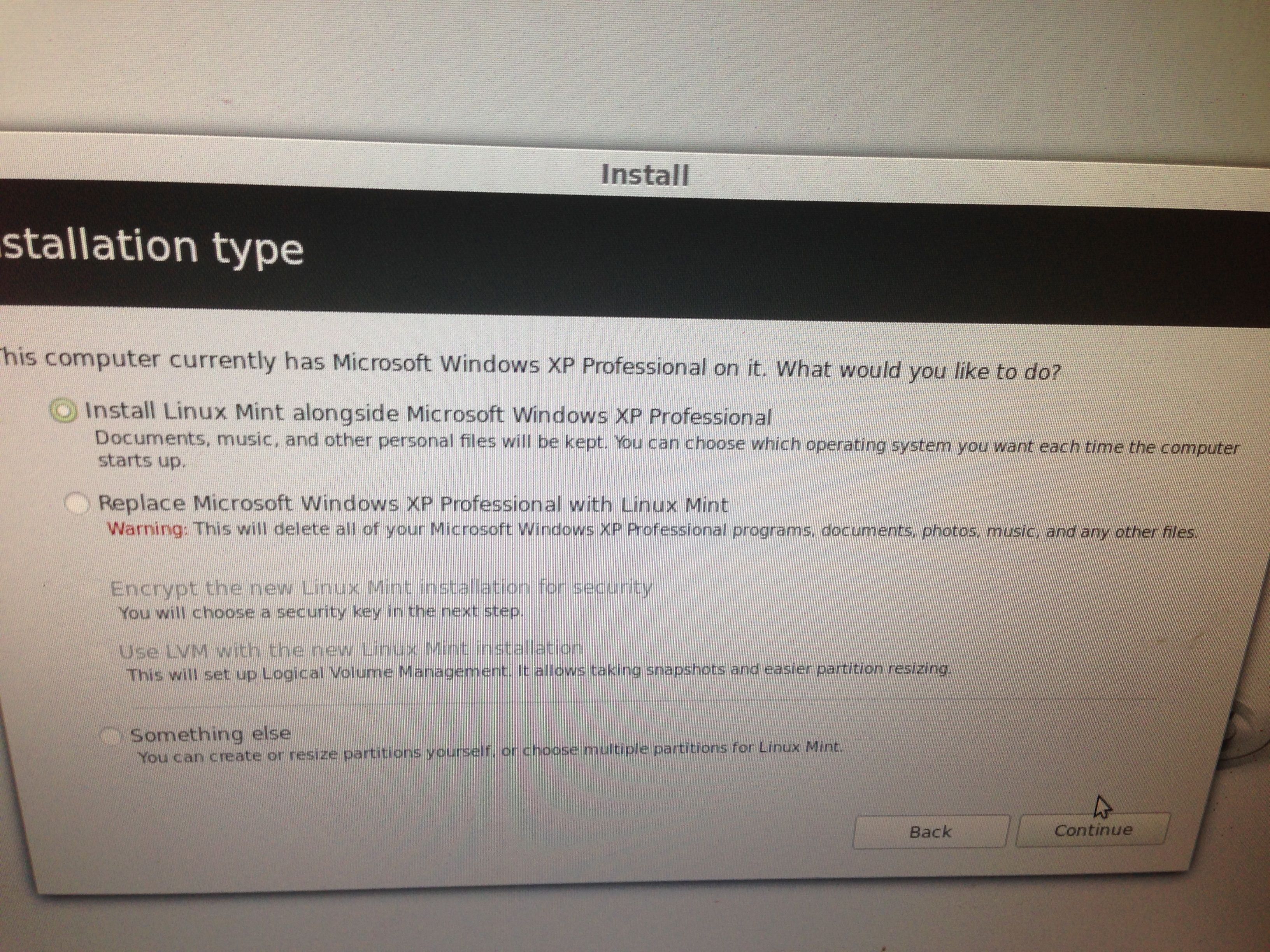

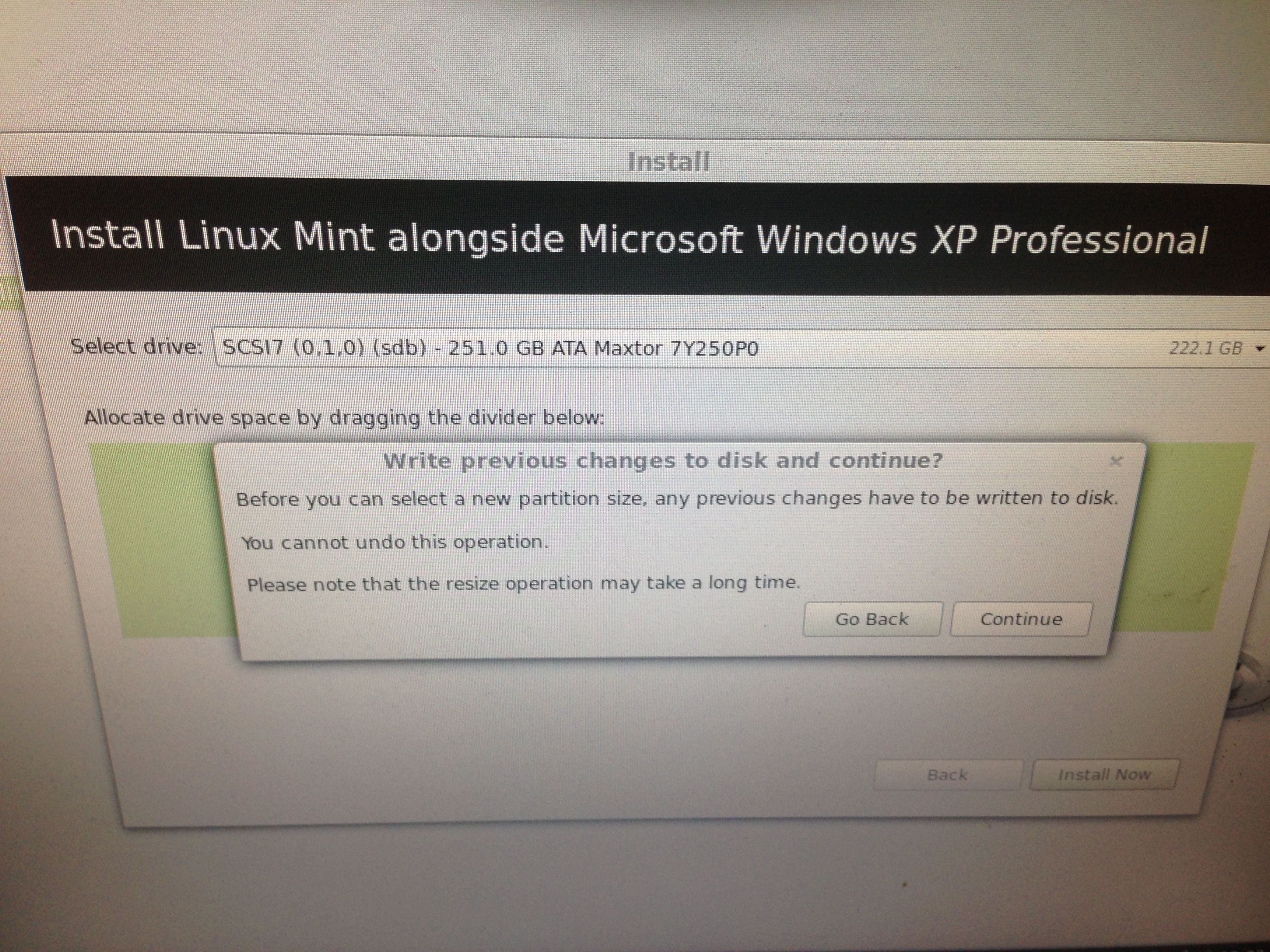

With some fiddling (disconnect generic DVD & just use the Sony), I am able to boot from the DVD and enter Linux Mint (slowly) and start the conversion process. First, I get:

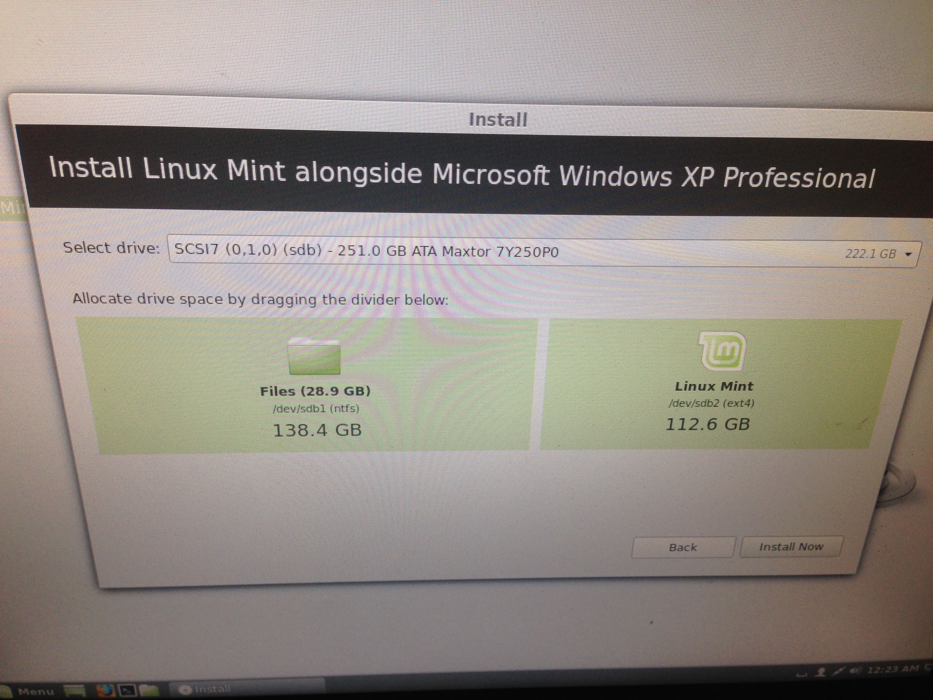

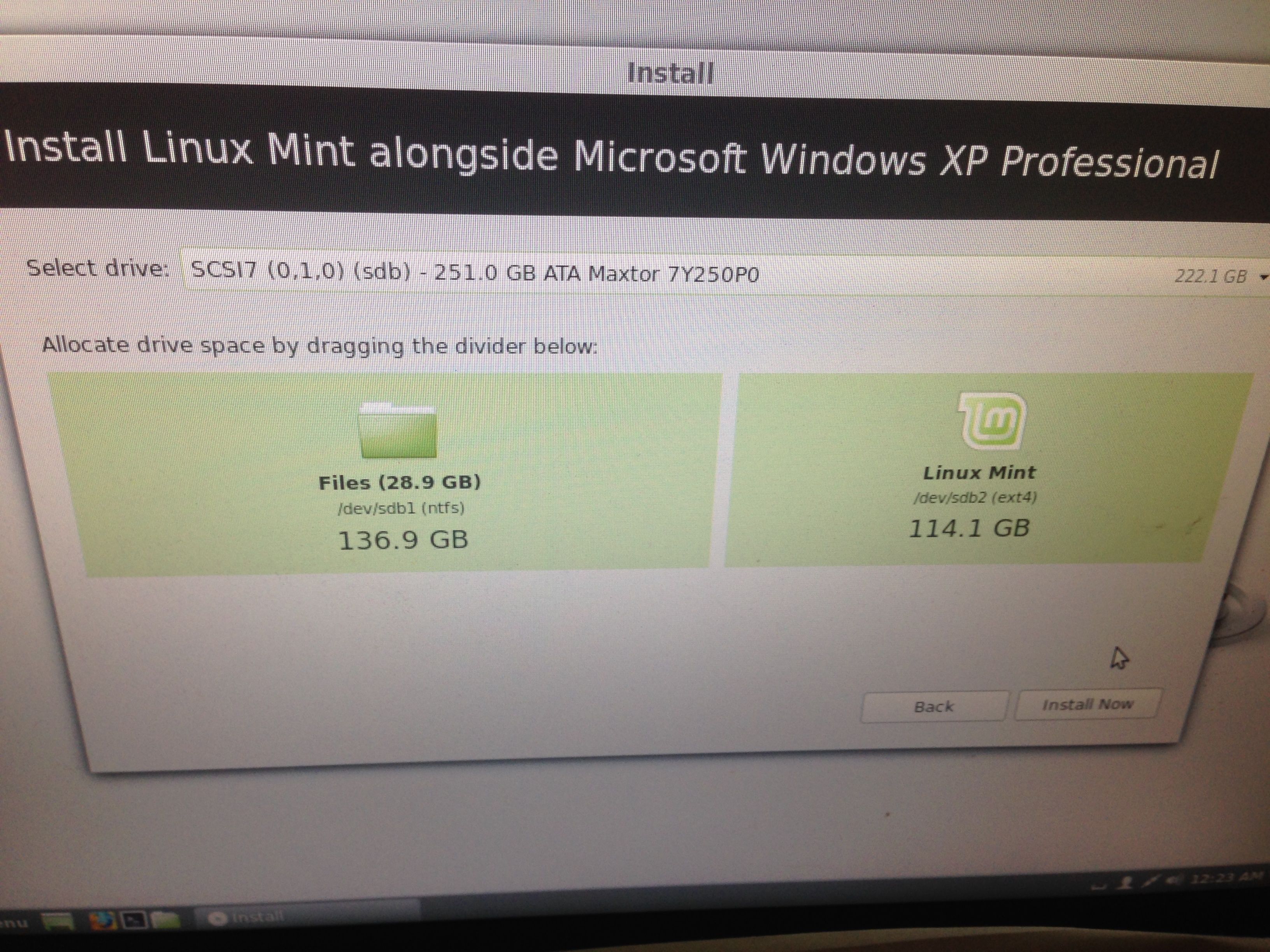

Selecting dual, I get:
I went with that, and get:

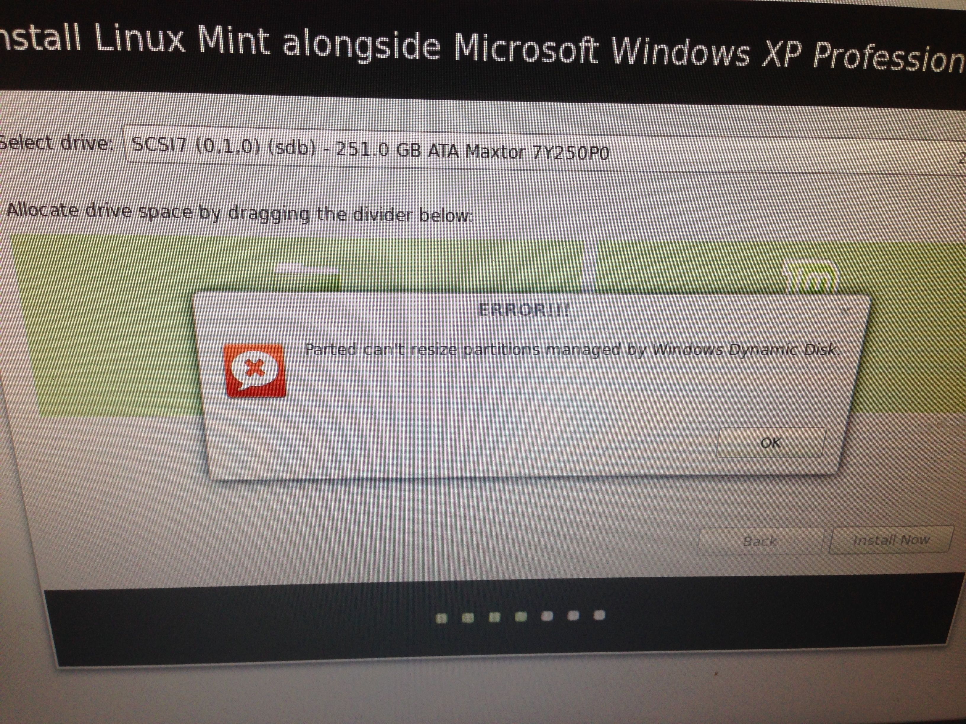

And so then I get:

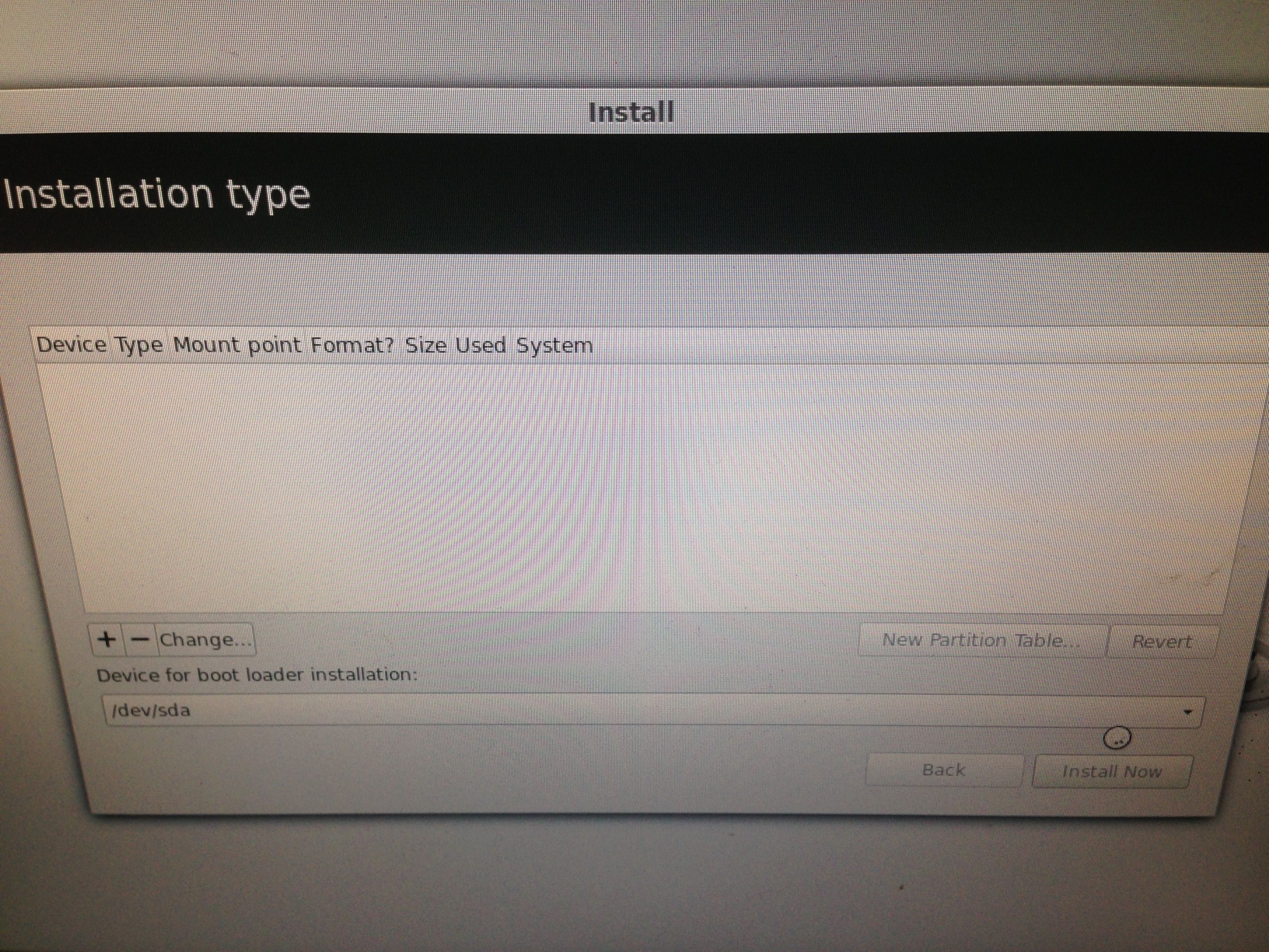

Double ungood. So I went ahead anyway and got:
Which went nowhere. I repeated the process and fiddled with the partitions, as below:

OK, I tried the demo of AOMEI Dynamic Disk converter and learned to save my $30 (the demo does nothing but demonstrate how easy it is, you must PAY to actually complete the job). It did not give the option of converting the C: drive to basic. I'm not surprised, IIRC that HDD is too large for basic in the first place. Playing around with partition sizes is impractical. So I hooked up a 120GB SATA that was installed in the PC that I had forgotten about. WOW! It had backups from a PC of about 15 years ago, an AMD K6. I must have moved that backup set from HDD to HDD until it ended up on a SATA. Anyway, no point in just converting D: (the second IDE HDD), I suppose. Well, I supposed wrong, but it was unnecessary and I saved my $30 anyway. I am determined to do this on the cheap.
The mobo BIOS is ver 1001, WAY obsolete (I learned to disable "full screen" on bootup so I could read -quickly- the BIOS ver), but it recognized the SATA drive. XP, however, did not. Not even under Manage under Computer, just flat invisible. No problem, I booted up under the Linux Mint DVD, and Mint saw it. So I'm now installing Linux Mint on the SATA drive, repartitioning it to give Mint 70.1GB and be dual boot. This, according to the screen, will take quite some time.
Well, it would not repartition the SATA drive- Dynamic disk, again. So I tried with the default partitioning (46GB), as a "just in case it works anyway." Of course, it did not.

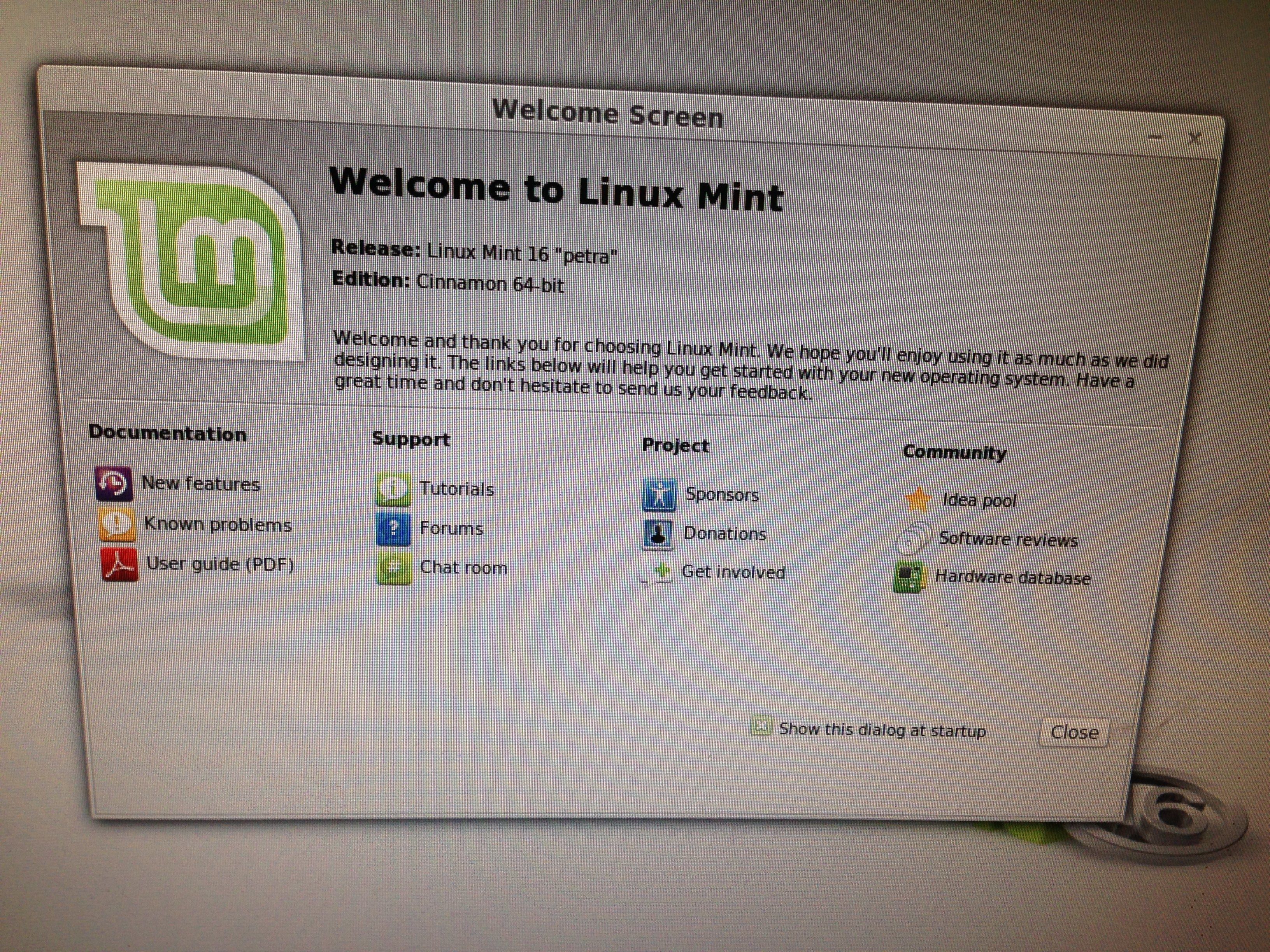

COMPLETION
Anyway, after it was done, I discovered I could no longer boot to XP anyway, even though it is a separate HDD. I might test it later by removing the SATA drive and see what happens.
So I went into SETUP and changed the hard drive configuration to where the SATA was the first in the list of HDDs. And restarted. Works like a charm. I now have a "Welcome to Linux Mint" dialog box on my screen.
So I plugged in a Dish EHD and - IT WORKS! Perfectly visible.
Now to download and install Pascal and then the work begins!
