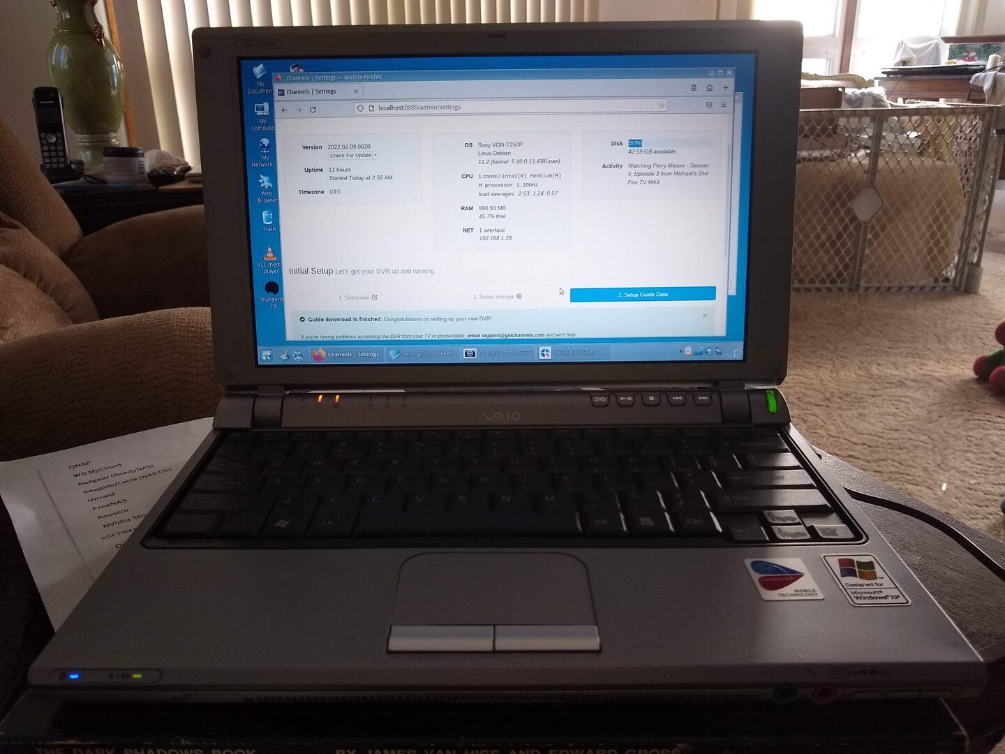

Here's a photo of the laptop. I have the wifi adapter working right now, and left it on all night to get that battery charged. It finally took a charge after being dead for 10 years! Lithium.
Anyway, this laptop is 11" x 7.5" in size, and came with Dolby audio, and a full DVD burner/player! The lcd is 10.5" diagonally. So far, it's working perfect as a Channels server. I even set it to record Metv "Perry Mason" last night to its internal drive at 11:30pm, and am watching that now. Completely flawless! Even over 2.4Ghz wifi!
