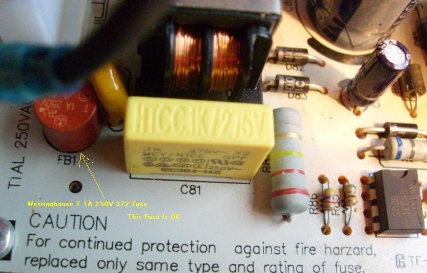

I was changing the coax out and turned the box off and I must have hit the power button twice for it was still on when I tried to reconnect the coax and I got that little spark and nothing. I should have checked it! My fault! The box will not power up at all, dead front display! I have power on the AC side of the power board but on the DC side no power at all but small voltage ripples on the multi-meter. I sent Coolsat an email and got back that they suspect that the STB is a clone but it has the hologram stickers on it and it has all the right parts in it according to their website picture on how to spot a clone one from an authentic one. I am not sure on what to do with it as yet but I think if I trouble shoot the parts one on one I will find what went out in the power supply. Coolsat told me that there was no fuse in the box but there is.
An AC fuse off the tail cord going in. To my surprise there is nothing that looks burned out or no bulge in any caps. I just did a fast look at it and really have not had the time to trouble shoot it yet. I believe that the problem is simple when I find it. I asked Coolsat for a schematic on the box but they never answered that question for me. I guess that takes away from their service department. I am planning to fix this box and get rid of both of them for standard DVB CNX Mini boxes. I have had my eye on the CNX brand for awhile and I like the design of the little Mini.

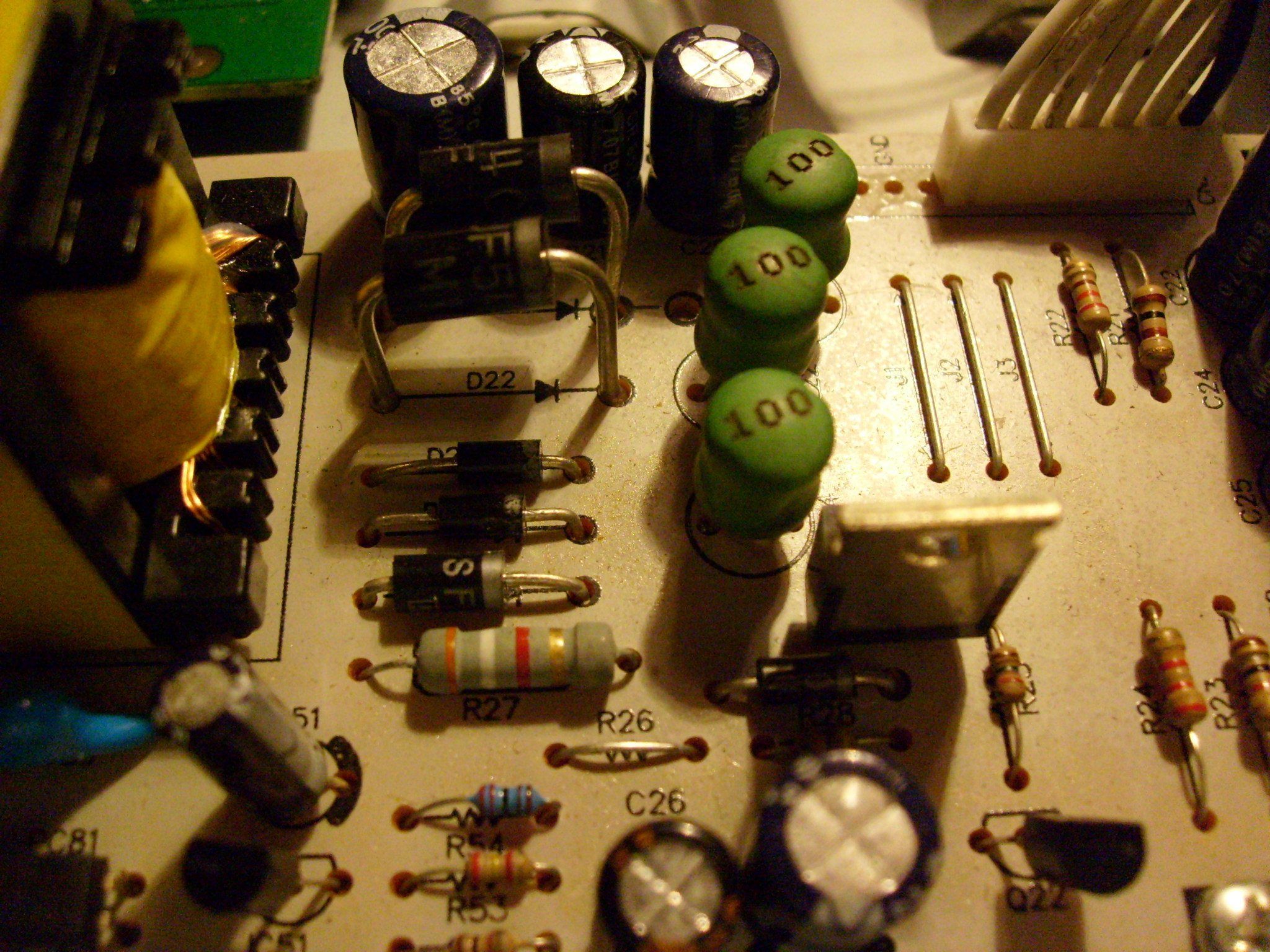

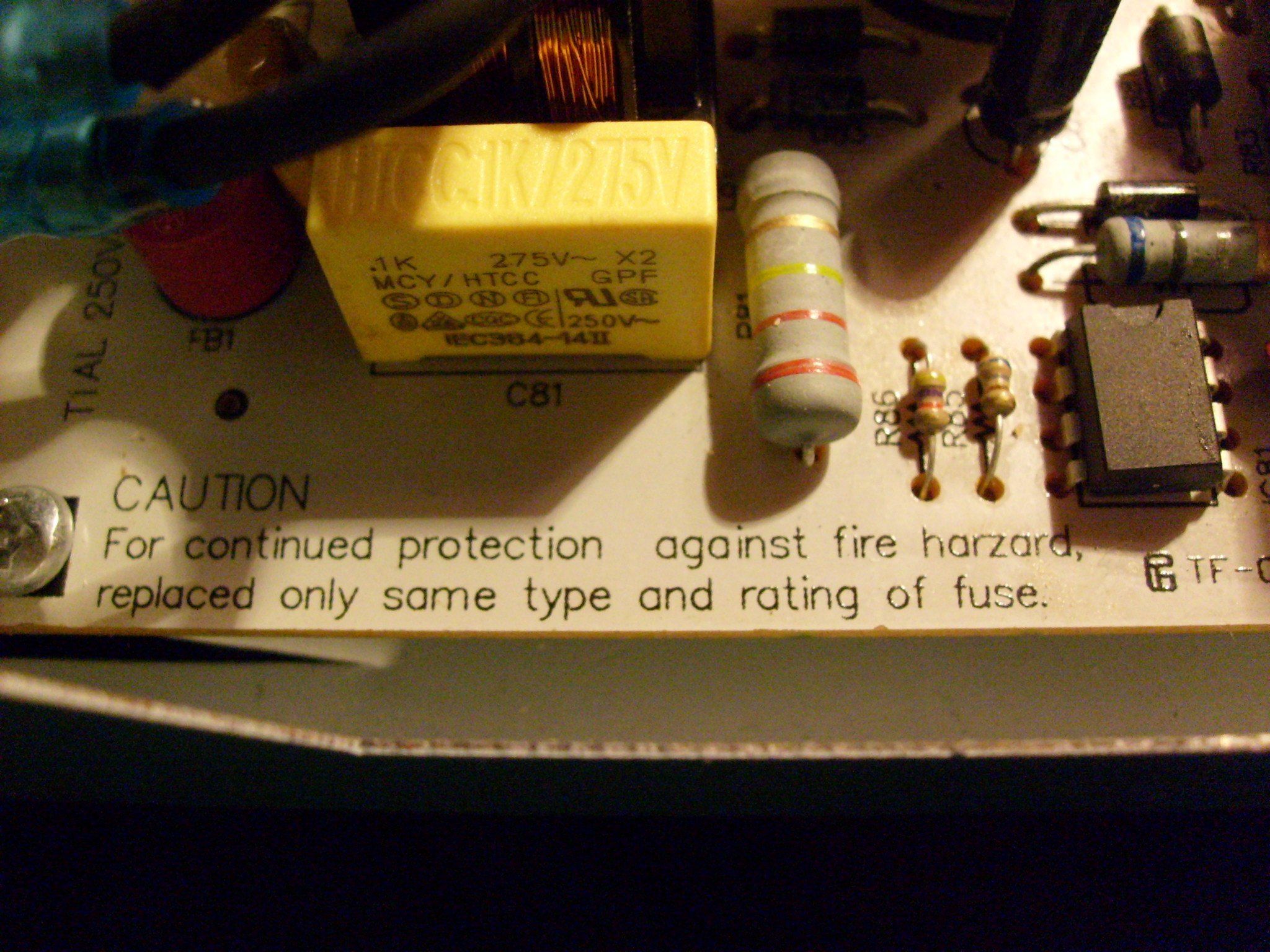

FTAman - that's some of the best close-up photography I've seen in a while.
The 2000x1500 pix would be great for trouble shooting.
