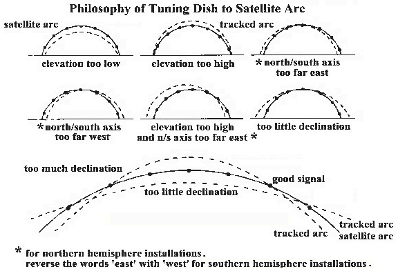

First, repeatability out of the positioner is a must. If the feedback isnt reliable your will never know where your at. You MUST have good reference points to get the arc right.
Next, I sort by position and print an FTA list, identify the known strong tp/freq/sr/pol/birds making a quick ref page bird by bird. This makes it easy to jump from bird to bird, and know what you are looking for. Noting the positioner counts [if they are accurate] as you pan the sky is a good idea too.
I dont know about the CS 7100 but my 6K is supported by a proggy called Channelmaster. An .ndf file can be built using known good sat/tp/freq/sr/pol data and u/l'd to the unit. Also on my 6k, I have to go to manual scan to select/edit tp/sr/pol data, and if in sat info area, the 1st freq in the list [seen in manual scan screen] is what it tries to get signal on, so if that tp/sr/pol isnt valid for that bird, no Q.
If you must edit in your data manually, put the known good info in the 1st position.
This site -www.geo-orbit.org/sizepgs/tuningp2.html#anchor469886
has the best "C-Band 101" instructions and info in one place I've yet to find. You may notice that other sites on the web have "gleaned out" portions of the text/graphics and put it up on their site. The graphic at the bottom of page 3 is an excellent visual explanation of arc, elevation, declination and true south position. There is a wealth of other sat info there too.
I'll try to u/l the graphic-
Good luck ,and get that feedback pulse gen and/or wiring issue fixed.
My current project is to get a 48" offset feed Primestar/Invacom QPH bolted to an old polar mount assy that had a 7.5 ft mesh on it to track 58-129. It's being a 'challenge' but I'm gettin' close...........
