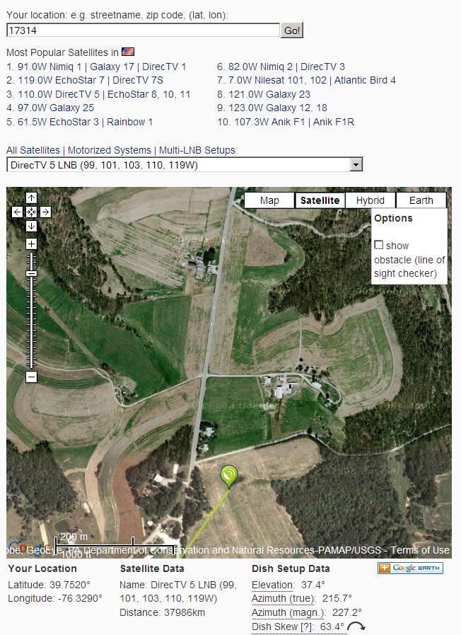

Hello all, first time on your site.I Need some information on direct tv satelite coordinates for a high def install, I now have the regular directtv service but understand that the shot is a bit more south and I'm in a real bad spot, my zip code is 17314, thanks for your Help, Pete

I think the OP actually wanted the aiming parameters for DirecTV.
Dish pointer is the place to go and use the lat/long that DandiDon supplied. You street address will also work.
If you use the street address you can zoom in on the map to see your house with the azimuth angle indicated on the map. You can move the mounting point around to find the best path through trees, etc.
