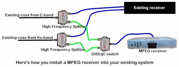

Yes you could add a KU LNB to the existing C-Band setup. That would probably be the easiest since you already have the big dish. Add a FTA reciever and you can get some of the free stuff up there. Below is how to add a FTA reciever to the existing setup. You can use the analog reciever to move the big dish and change polarities.
