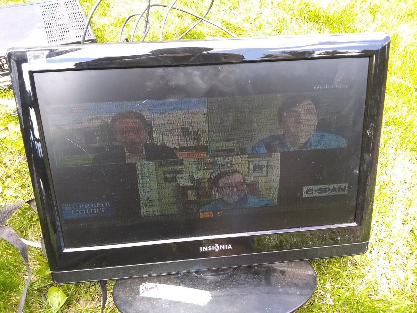

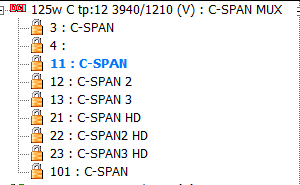

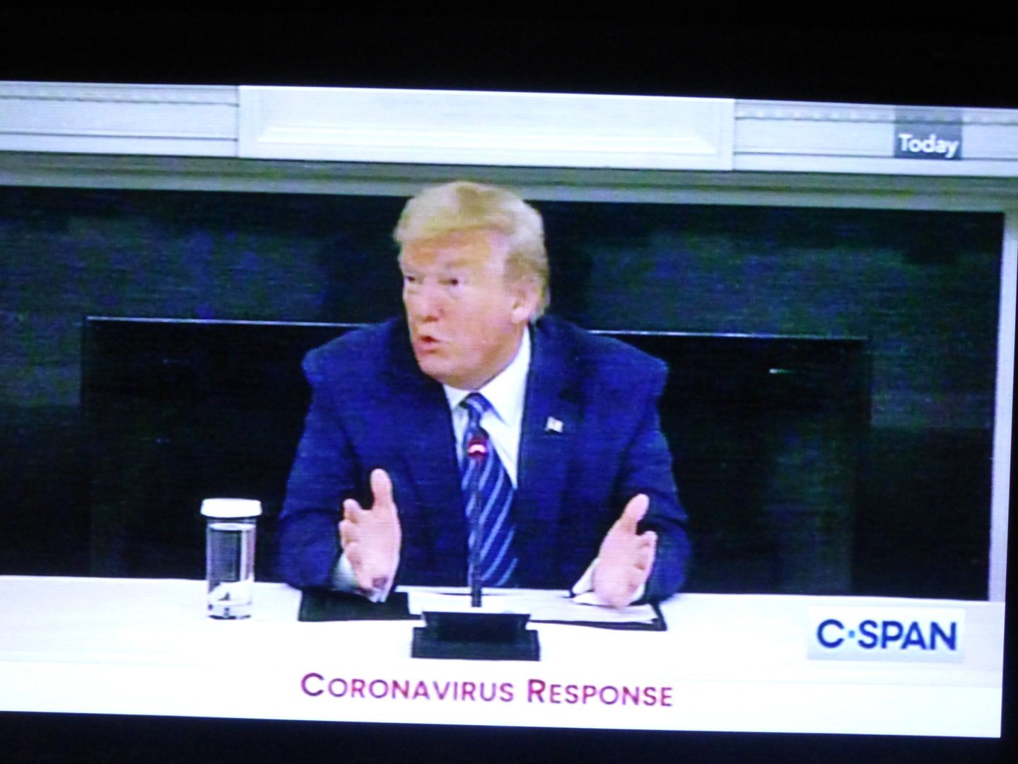

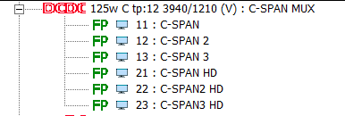

The 125w CSPAN mux is DIGITAL. It is NOT analog. For short periods about 3x a year, this signal becomes watchable. And yes.... This signal can be watched on the DSR4410 when its in FP or ZK mode. No, the DSR4410 cannot do Analog and cannot tune the C-Span on 131w.

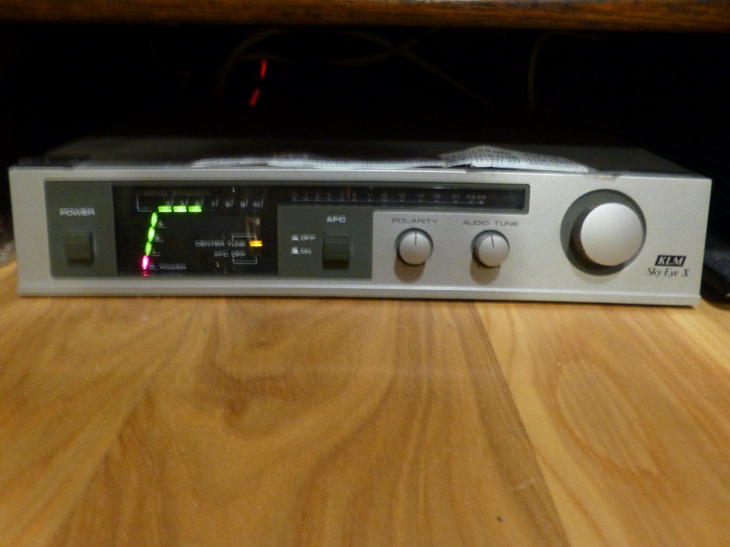

If I recall correctly the signal is offset a bit on the transponder,you have to fine tune the frequency a bit to get it to clear up.There should be a fine tuning adjustment in the menus somewhere.
Really old school receiver will have a tuning POT somewhere.

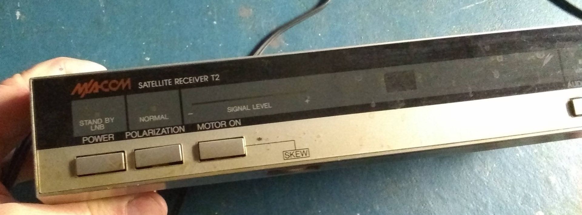

On the GI receiver it was 7 and on the Macom it was channel 6

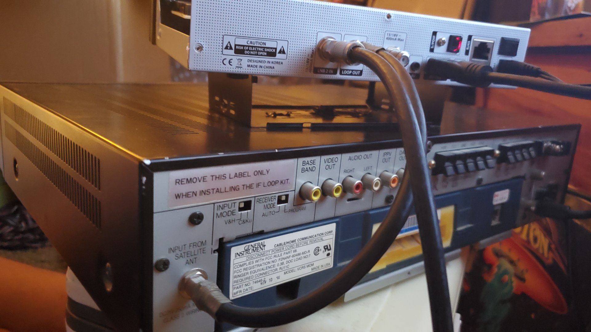

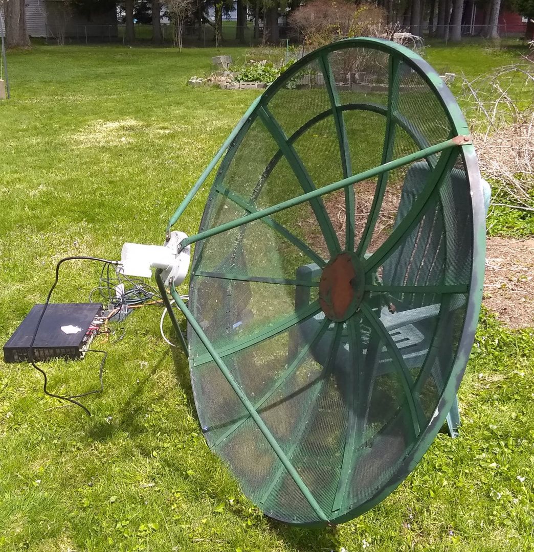

I bought a Toshiba TRX-80 on a cheap offer from ebay. I plan to use it to move my dish once I get my sensor wired. I planned to feed it with a Loop Out from an Edision Mini OS, but I suddenly can't get that receiver to turn on...
So can I directly connect the Toshiba to my Titanium LNBF? I just want to see CSPAN before the feed goes down. Any ideas are appreciated.
Sure can,you will need to get into the receiver menus and set it to use an LNBF.It's been so long since I used my old Toshiba I don't remember just where the setting is tho.

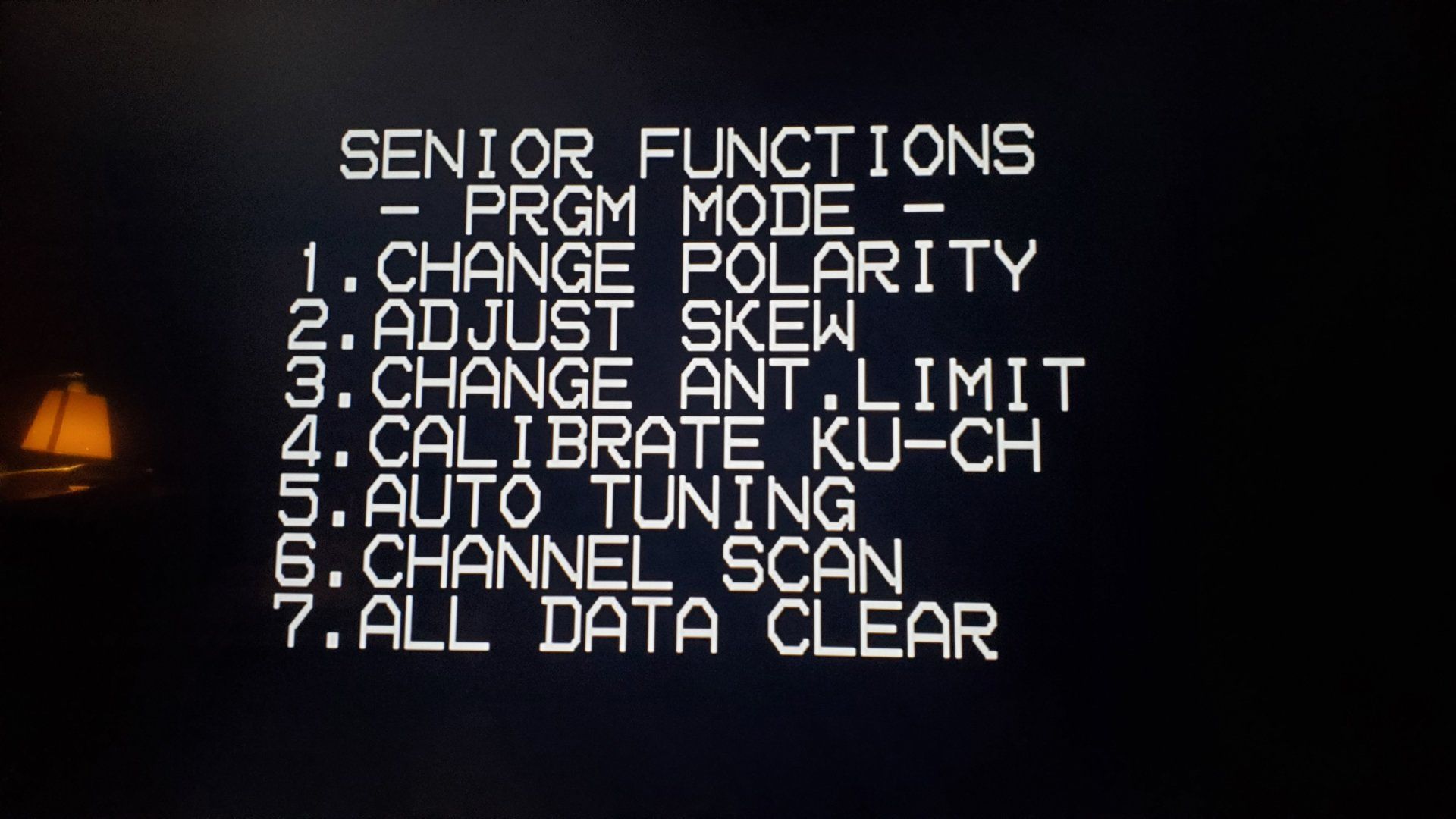

This toshiba has no LNBF setting, so I am trying to slave it to an Edision Mini OS. I have the tuner B of the edision on a vertical TP on 131 and Loop Out connected to the Toshiba.
Anything else I need to check? I'm not getting a signal on the Toshiba. But the on screen display menu works.

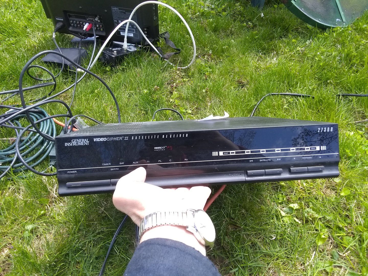

Maybe later I'll see if my trx100 still works and play with it,that may be a long shot.
Also,take the VCII box out of the receiver and toss it,it has no use or value anymore.
