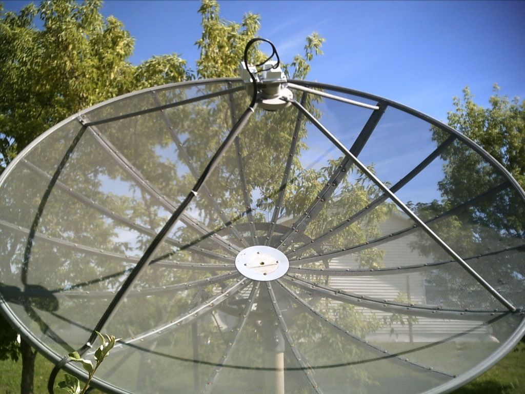

Also a switch question on my setup. I am using a dual c band scalar feedhorn for c band. I ran 2 cables down one from each lnbf to the 13 and 18 v on my zinwell then it goes to a 1 x 4 diseqc switch. I get lots of transponders on this 91 sat, lots are scrambled but I do see some in the clear. Couple question about my setup.
Which lnb up on my feedhorn is v and which is h? Looking at it from the front I have one at 9 ocklock and one at noon can someone tell me which is which? and does it matter which I hook to the 13v and which I hook to 18v? And do I have to make a sat in my receiver for both of them and maybe label one 91-13 and 91-18.
Thanks for any help.
Have both coolsat 4000 and 5000. And that is great about in the clear. I have funeral and work to go to so will get to work on it later tonight. thanks folks.
With everyones help I got all 3 CW feeds working. I just need to figure out how to get both h and v to my receivers with the dual feedhorn I have. I have the one that is at 9 oclock going to vertical 13v on the zinwell and the one at 12 oclock going to the 18v on zinwell. The lnb on the left is 9 oclock and center is at 12.
