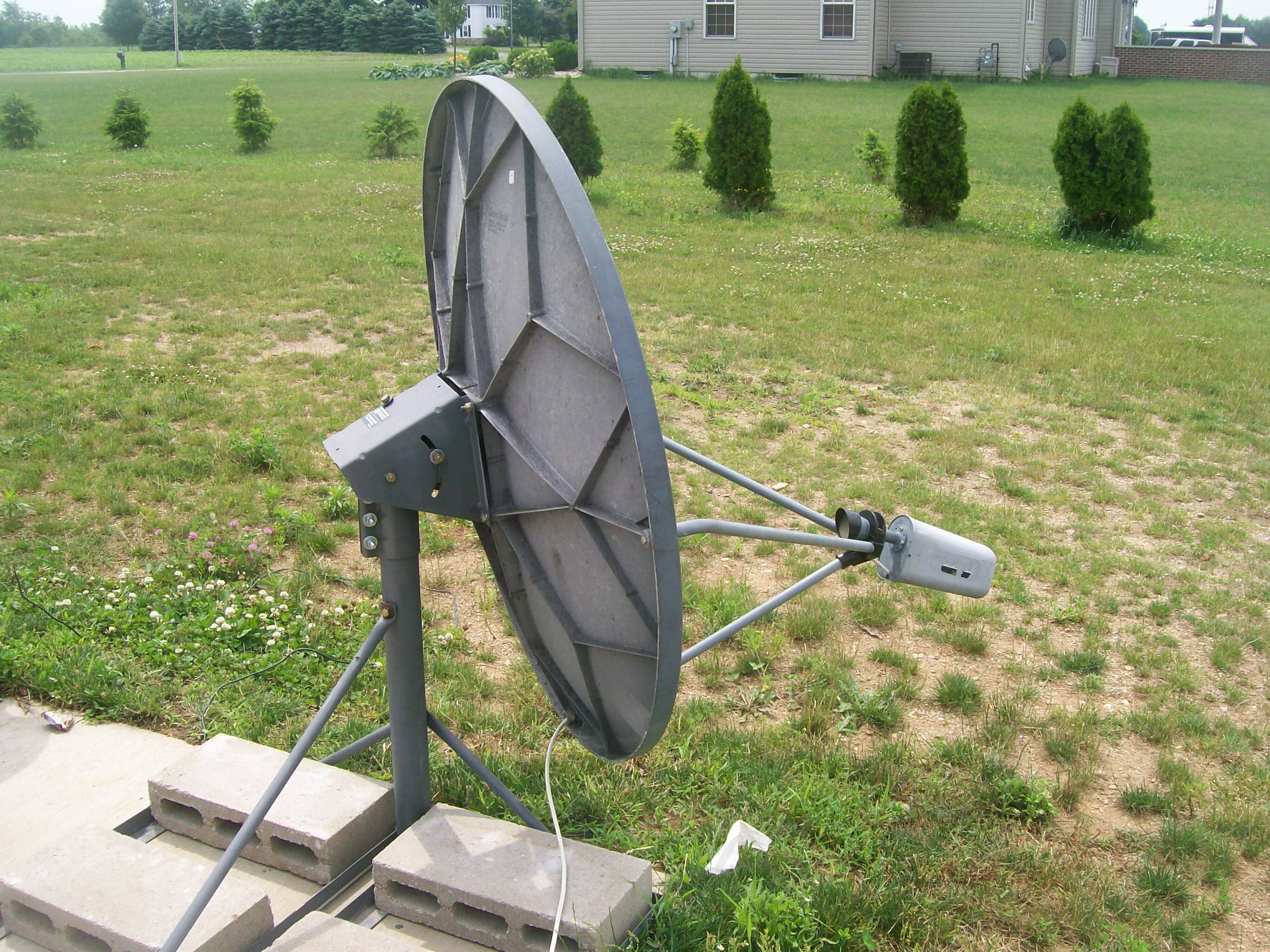

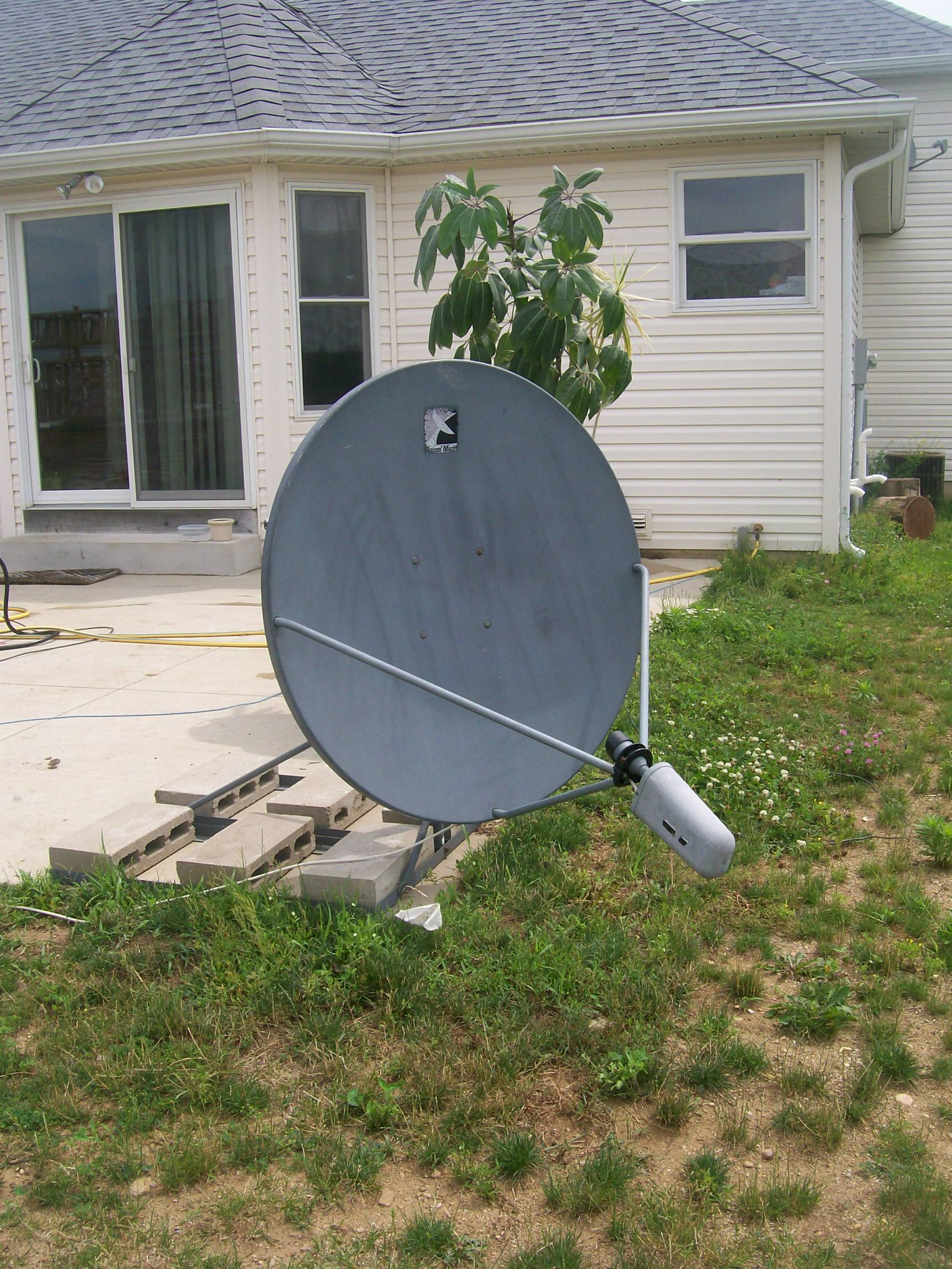

I dug this 1.0 meter Channel Master dish out of a dumpster at Menards. What could have it been used for?

I got a .75 Channel Master. It looks just like its smaller brother. Worked good on G10R. Its rather large for a data dish, but you never know. If you look at the LNB that might give you a clue.

in house music possibly?
anywho...nice dish :) would work great for KU Band

Great find there, same as my 1m primestars, even the lnb cover looks the same. Should do a nice job on fta.

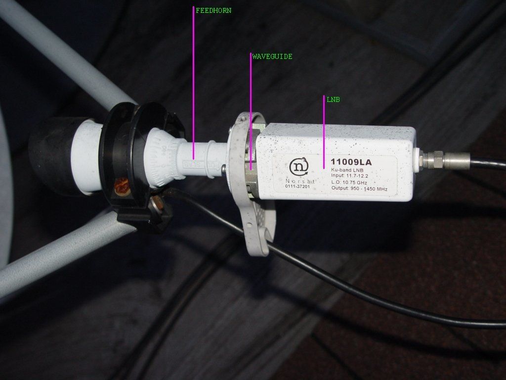

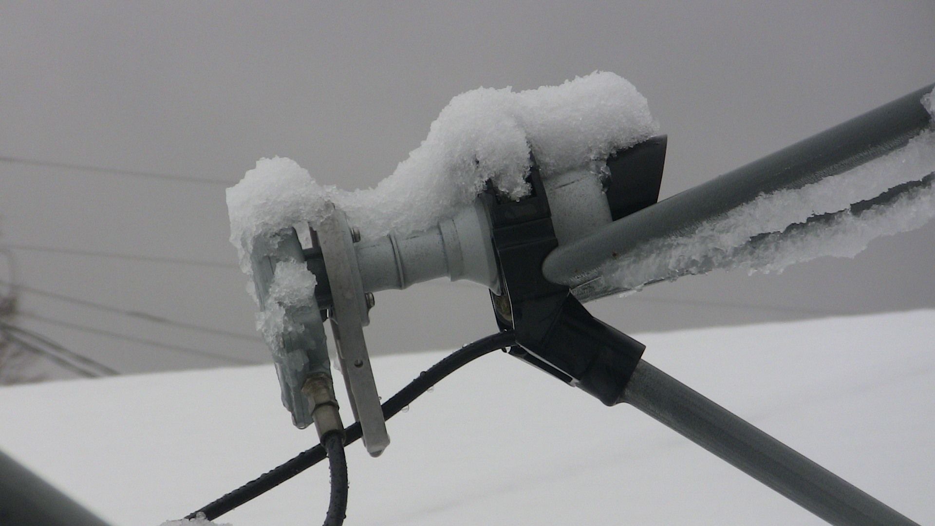

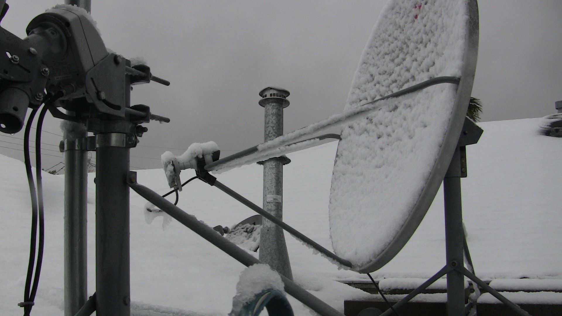

Wow... complete with the roof mount! That dish and NPRM are identical to my G-18 setup. Just replace the single-polarity LNB and waveguide (which is what you'll likely find under the cover) with a FSS stacked LNB from a Superdish :)

Or use a Hughes c120 lnb. It bolts right up to the feedhorn and fits under the cover and works great. I really like the covered lnb setup. Keeps things protected from the elements.
