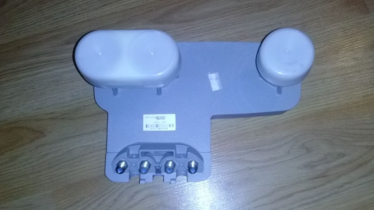

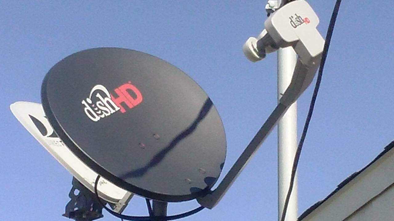

this one was on eastern arc before, but I had new service installed yesterday and the guy pointed at 110, 119, 129 with a new LNB.
I kept the LNB from eastern arc setup and posted its pic.
Now I have to figure how to get eastern arc back in and I probably need a new bracket too dont you think?

the installer is telling me the new dish HD will not work with eastern arc even with the eastern arc LNB.
He is telling me he has to switch the dish to a KU dish. He is full of it, right?

Well, that statement is incorrect. However, if you have a 1000.2 dish you can only get an LNB for it that will receive 61.5/72.7 on the eastern arc. In order to get the 77 as well, you need the LNB you pictured above paired with a 1000.4 dish.

That LNB is for a 1000.4 dish not a 1000.2 as pointed out a 1000.2 EA can't see the 77 sat.
to be clear, below I have a 1000.2 dish that can't see 77 and a 1000.4 LNB that can see 77?

Correct, the 1000.2 is point at the western arc 110 119 and 129 with eyes roughly equidistance apart. The 1000.4 eastern arc lnb is designed for orbitals 61.5 72.7 and 77. The combined twin eye on the left of the lnb receives 72.7 and 77 (note the small distance between the two). Although you could point the 1000.2 west at the 77 the eyes are not properly spaced to pick up the other two.
Also You need the full 1000.4 assembly, you can't just put the 1k4 east lnb on a 1000.2 and change the skew and elevation. The bracket arm and reflector is a different size so you might as well start from scratch.
