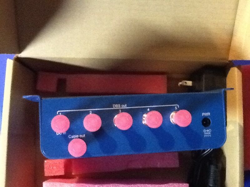

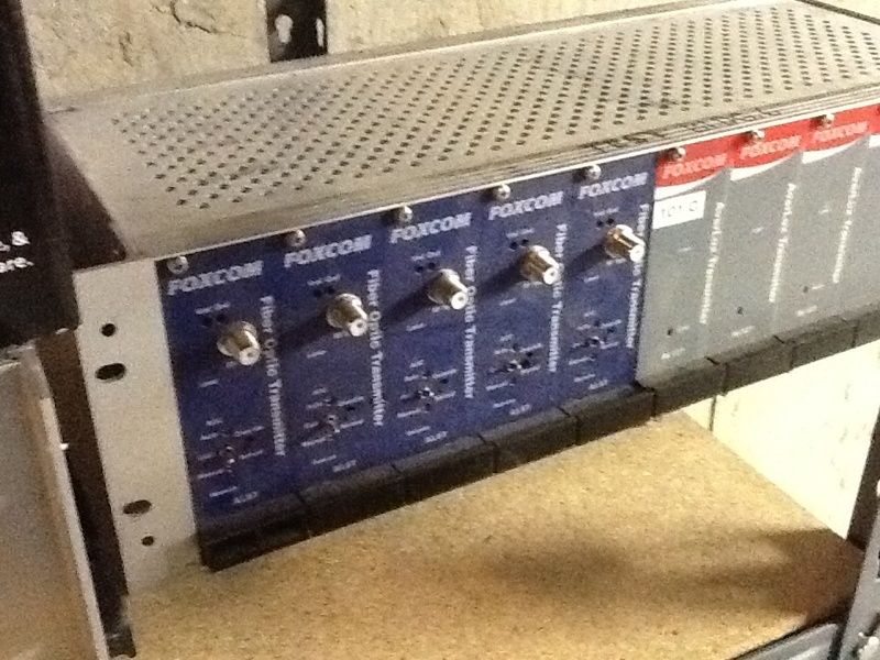

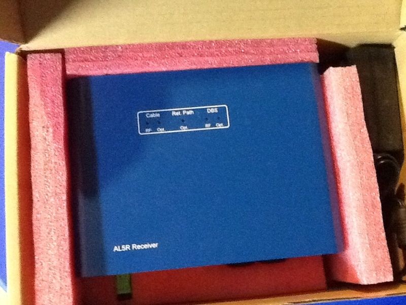

Here's fiber gear you can get cheap send 5 signals over one fiber if you use stackers you can send 10 (H and V) I love fiber :)
