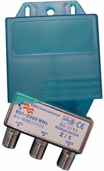

YES, you can use you Circular / Linear LNBF with your motorized set up! I use the same set up! I use a 2 way DiSEqC switch to toggle between Linear and Circular sides of the LNBF. (see below)
I use the Invacom QPH-031 LNBF.

Also IF I ever get it running; how do I configure the one and two ports on my diseqc 4 by 1 switch to handle the two channels on the Invacom qph-031 LNB.
Thanks, BIC
Not sure I'm understanding the question correctly, but you need only hook up one circular and one linear output from the QPH to the DiSEqC switch (unless you have two receivers, in which case you would use a DiSEqC switch for each receiver, or a 22k DirecTV-style 4 x 4 multiswitch)...
