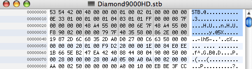

If you decompress the firm ware, and compare 131P to say 125P, you will see an extra hidden file at the end of 131. If you decompress that, from what I can read, it has to do with sound.
The Euro boxes had the same issue, but they made a "cleaner" file. DO NOT attempt to load the "cleaner" file on the Diamond, it will fry the box. I already tried.
WARNING:
Do not try to edit and load, you will need the proper cable to upload Factory Firmware via RS232 and that does not always work!
Compression is "LH5"(aka LHA) the program "7 - Zip" can decompress it.
You have to remove the Firmware "header" first, then decompress.
The "header" ends 2 places before "-lh5....."
Would look like: "..-lh5-........."
See Pic
WARNING:
See Pic
