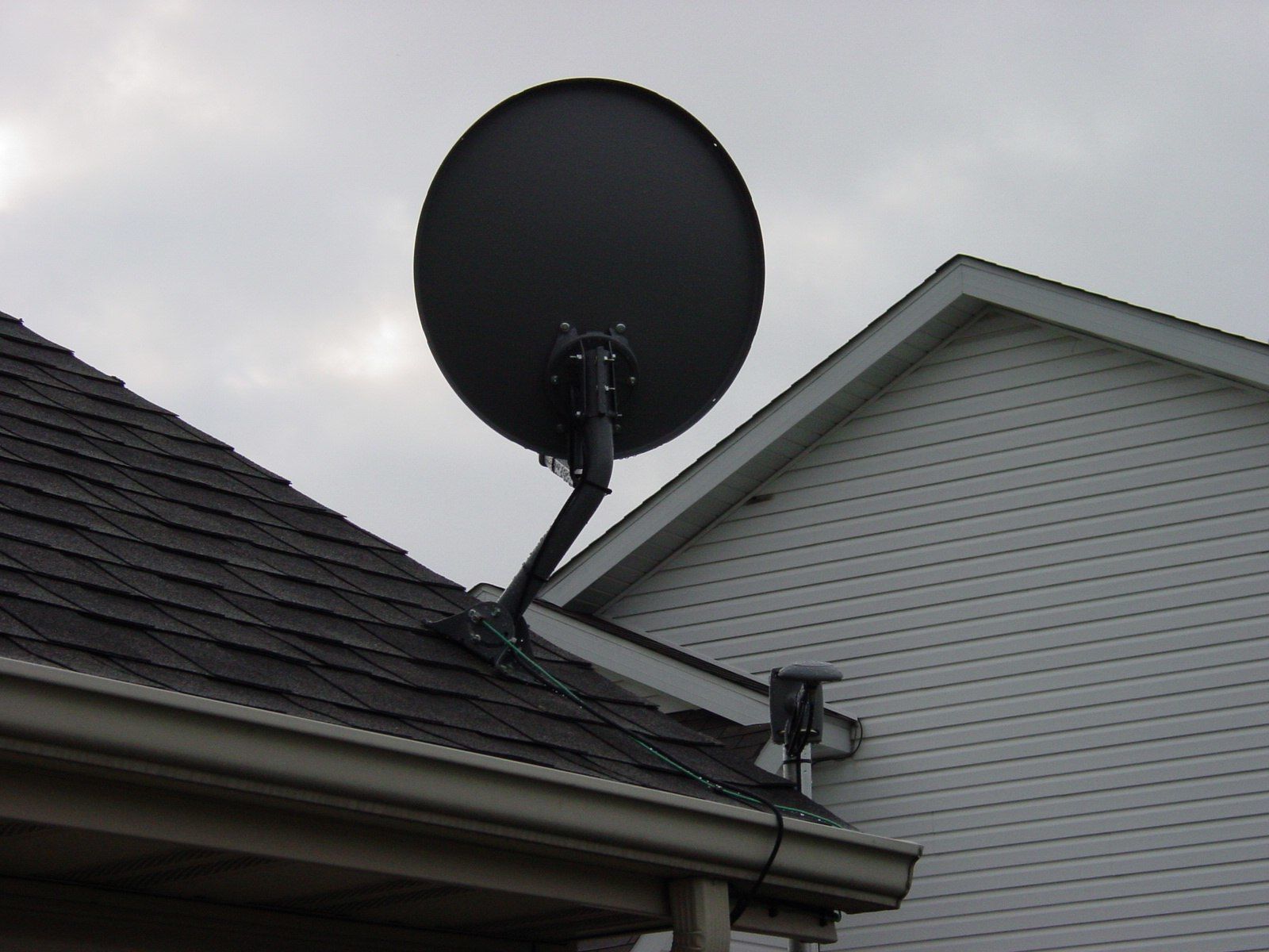

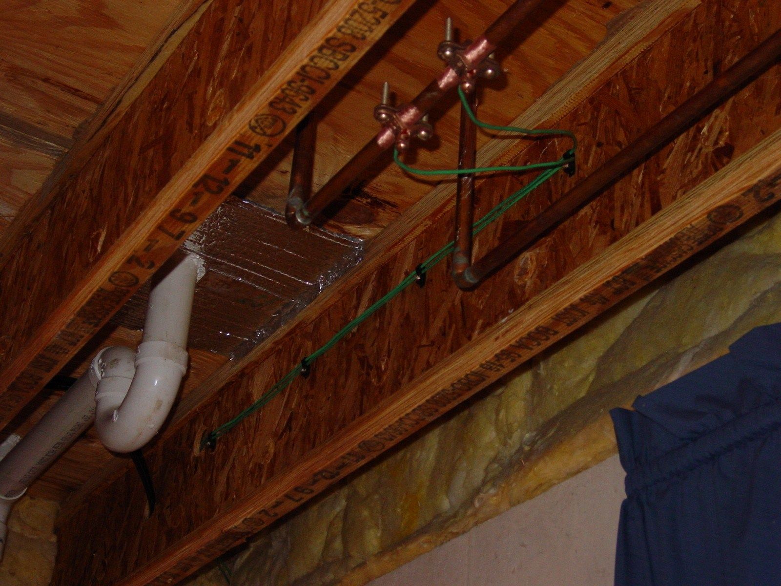

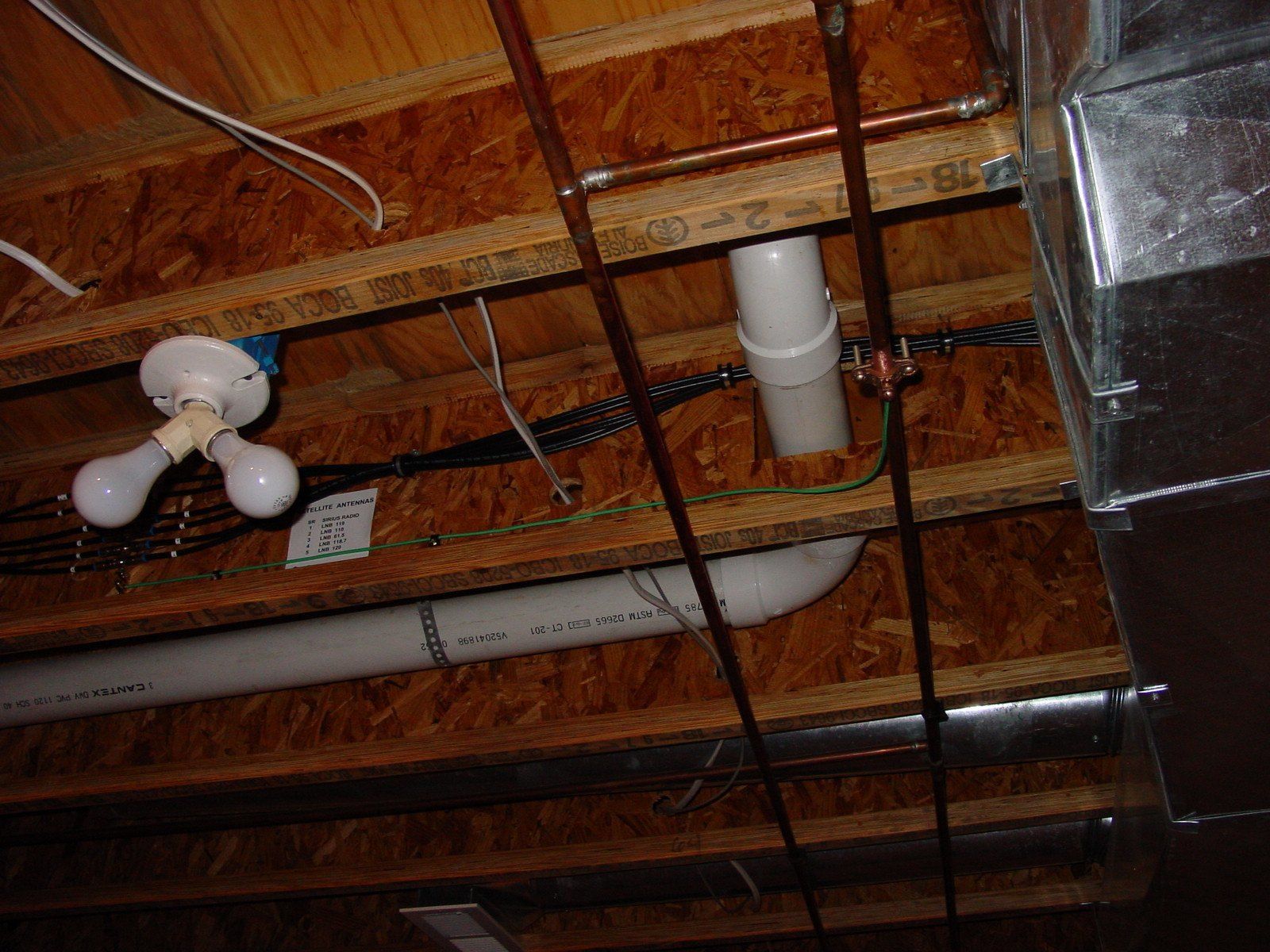

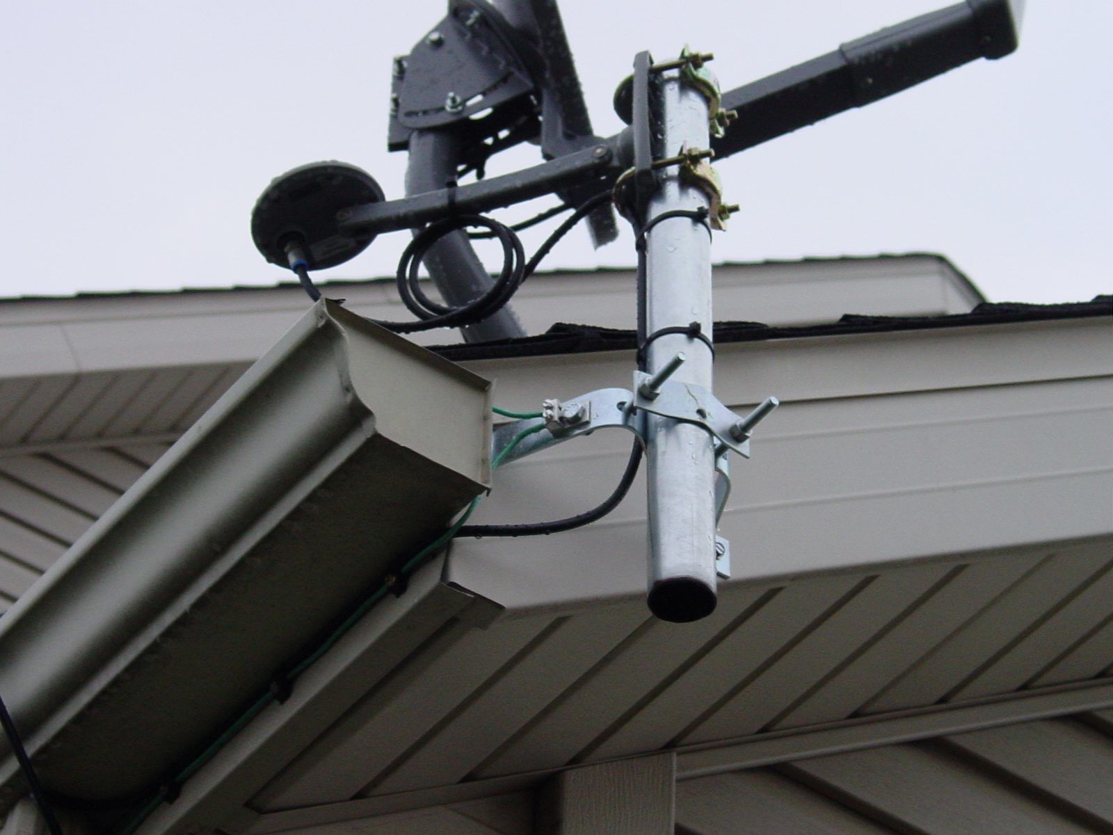

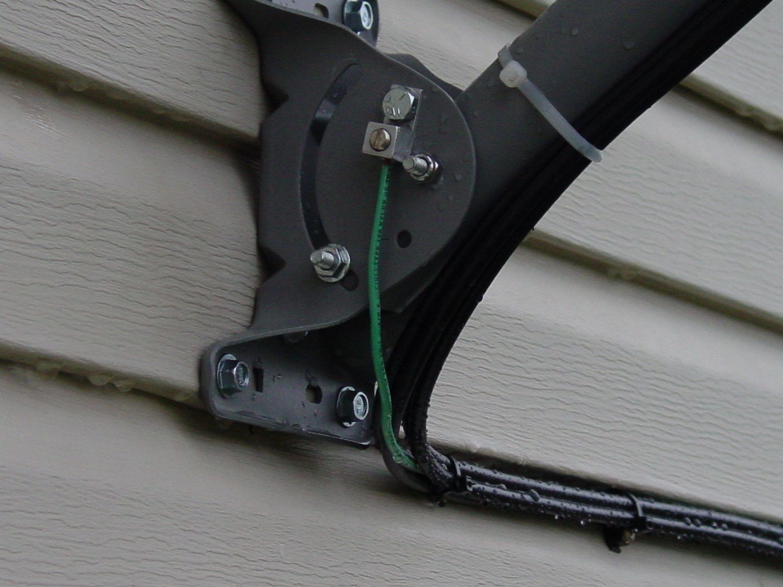

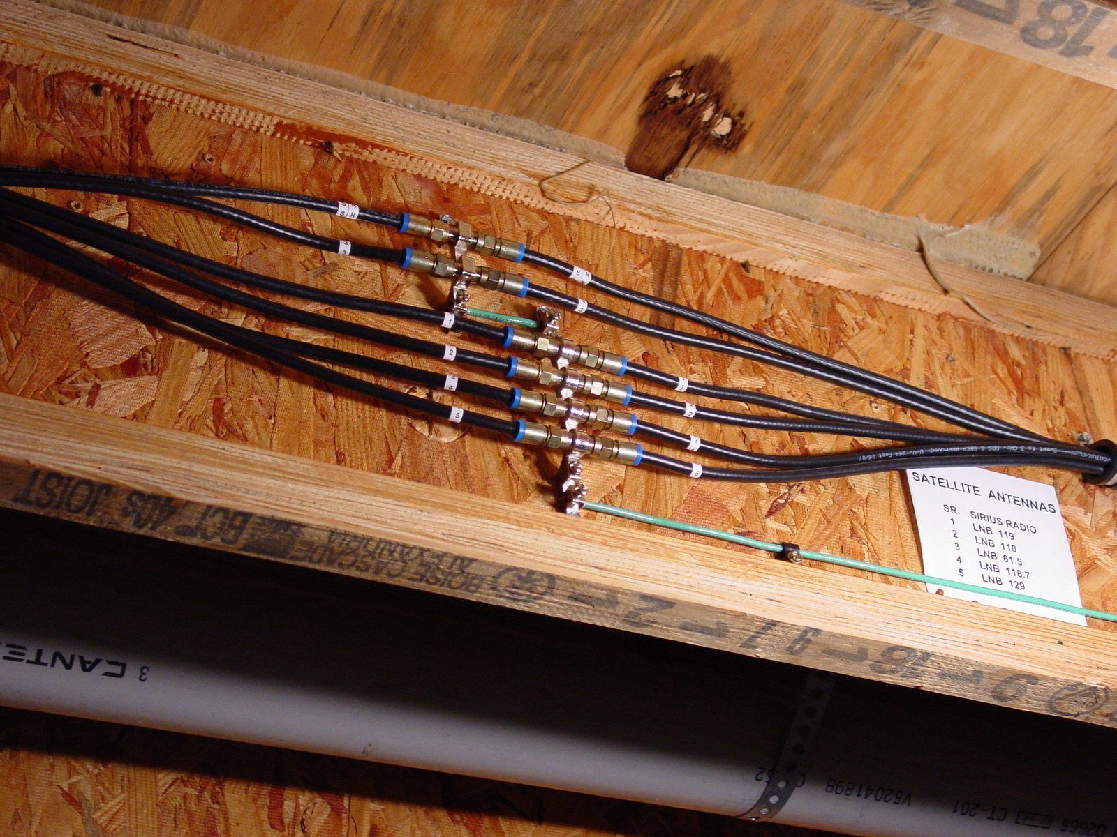

I installed the ground blocks inside too and even attached them to cold water pipes. The pipes were tested and have good continuity to the main home ground. Check out the pics. The Dish 500 and the Sirius antenna are on one ground block and the 1000+ has its own ground block. All six satellite's coax have their own ground block too. The ground wire is #10 solid and out of the three ground wires the longest one is 19 feet. I know this is not IAW the NEC, but it will have to do for now till I can work on it.
