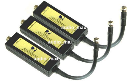

The dish is the "older style" (non SWM). The issue is the HR24 needs the BBC connectors on the back of the tuners to get the HD channels. In your dish setup its slimline 3 LNB but you need to get the BBC connectors (need 2 of them...one for each tuner). You can get them on Ebay or call Directv and maybe they can send you some
They look like this

I actually have 2 BBC connectors. I have tried the dish setup with those both connected and not connected. Each time I only saw the SD channels. :confused:
They are required on the HR24
