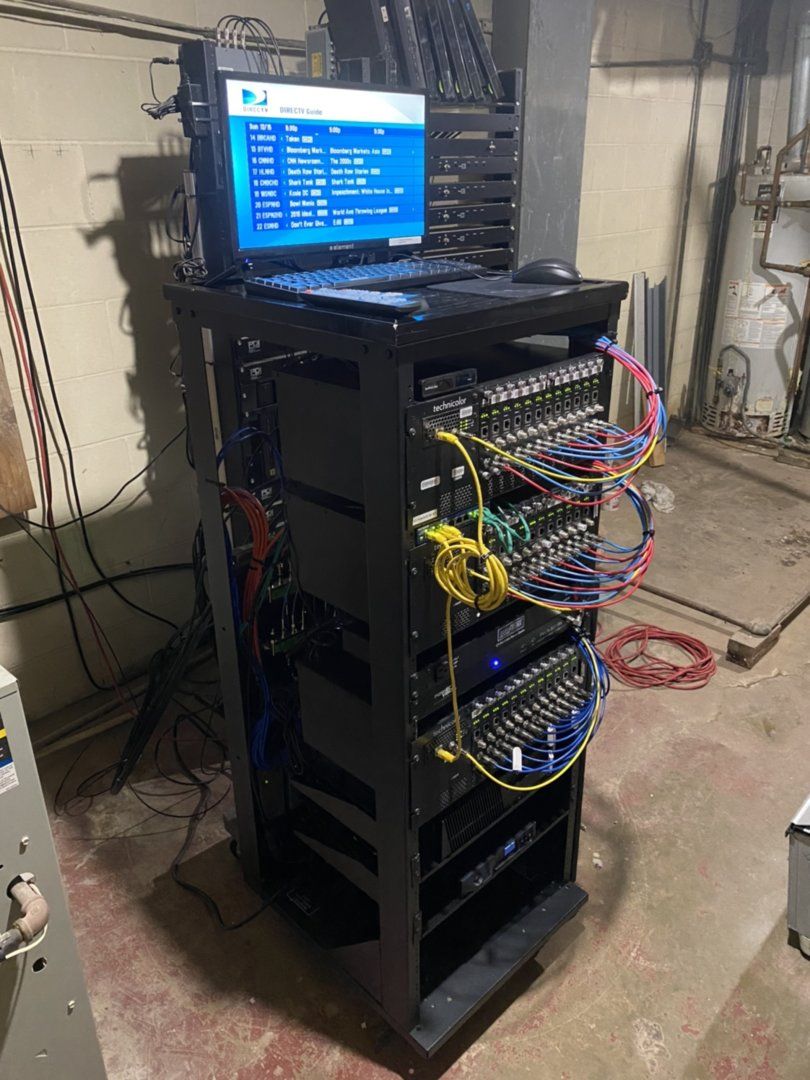

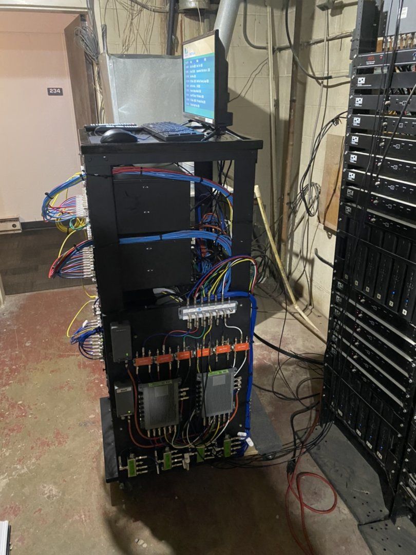

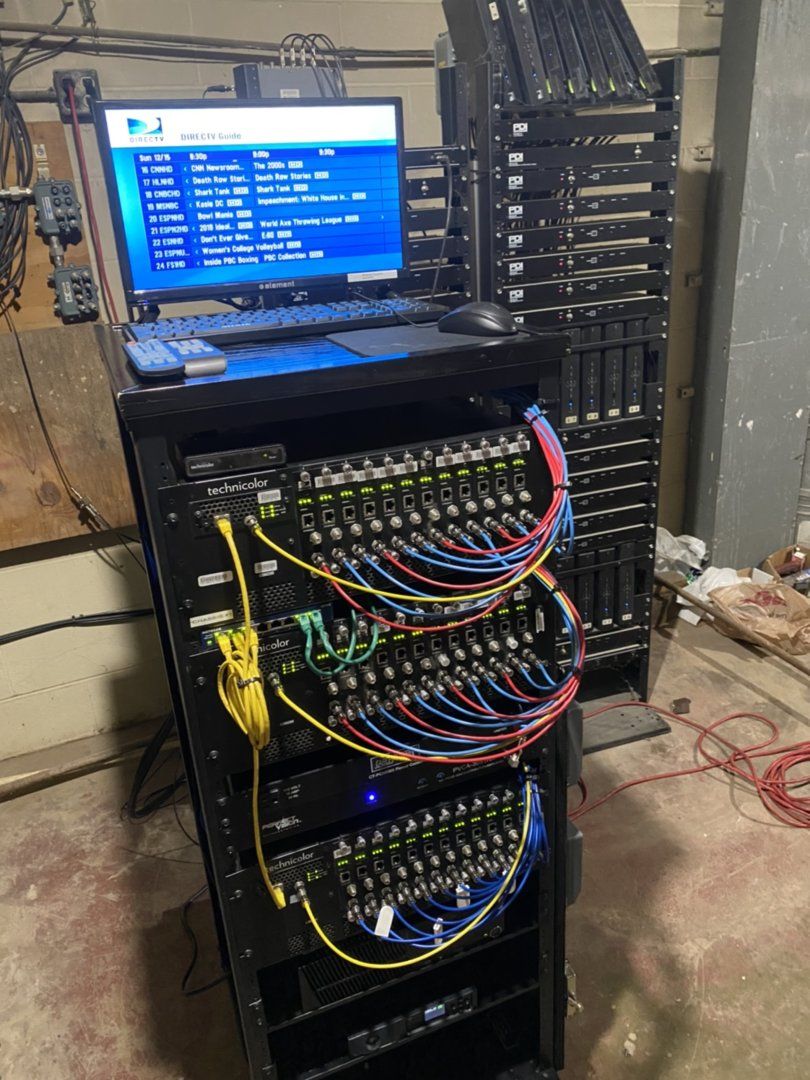

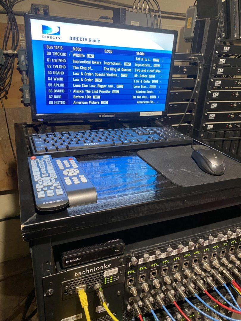

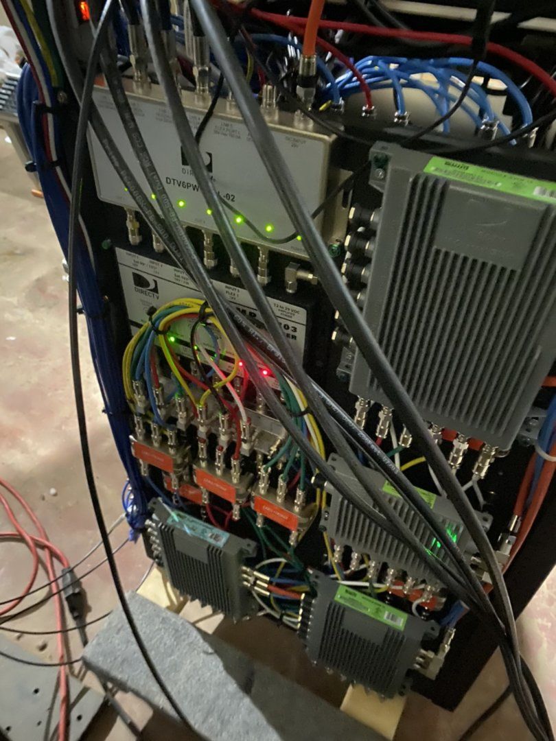

Directv Com1000 I’m building

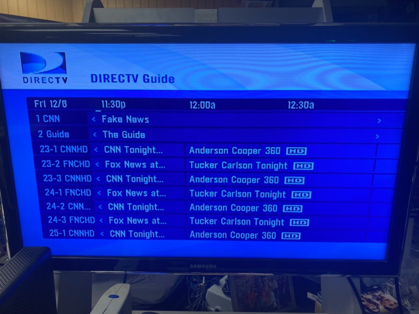

Fixed the guide today
Where did you get the colored coax? I had previously found a place that sold Gepco RG6 (designed for HD-SDI) by the foot in a variety of colors, but they don't any more. Now I can't find colored coax anywhere that isn't in bulk. I realize you're probably buying in bulk too, but maybe you know of a place that sells smaller quantities?
It’s mini RG59, sold in 250 foot spools. With such a short run the loss does not make a difference
I can also get RG6
Black
White
Green
Orange
Yellow
Red
It’s not cheap, you need to buy a 1000 box
