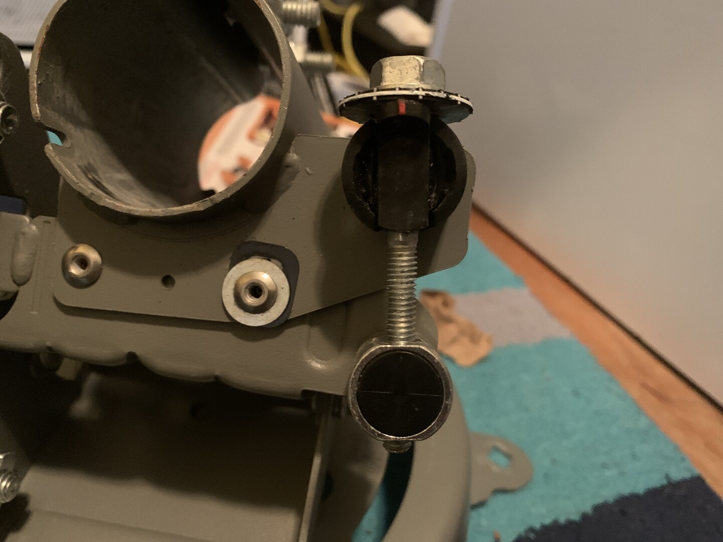

Hi there, hope all is well! All of a sudden my DIRECTV dish stopped receiving all HD channels as well as SD channels. I checked the signals and it looked as though only certain channels were being received. I tried swapping receivers all through the house with no success. All receivers have the issue. I then tried to adjust the dish and same thing. The dish only sees certain transponders, not even odd or even. It'll either be a row of transponders on 101 or maybe 10 random ones. I'm not sure if it's a bad LNB, bad bent dish, or something else. What I did see is this, look at attached pic.
One of the dithering techniques is bent and the black piece looks stressed, maybe from too much dithering??

It sounds like a bad lnb, but you removed the entire back assembly from the dish?

A bent dish will be difficult to dial in, some transponders are good, others bad. Much like a bad lnb. Dishes don't bend spontaneously. Lnbs go bad out of the blue. You can try a new dish but I still think it's an alignment issue.
Just picked up a new dish today from Mercari Local and it is working great again! It does like as those one of the dithering rods is literally about to snap in half though lol
