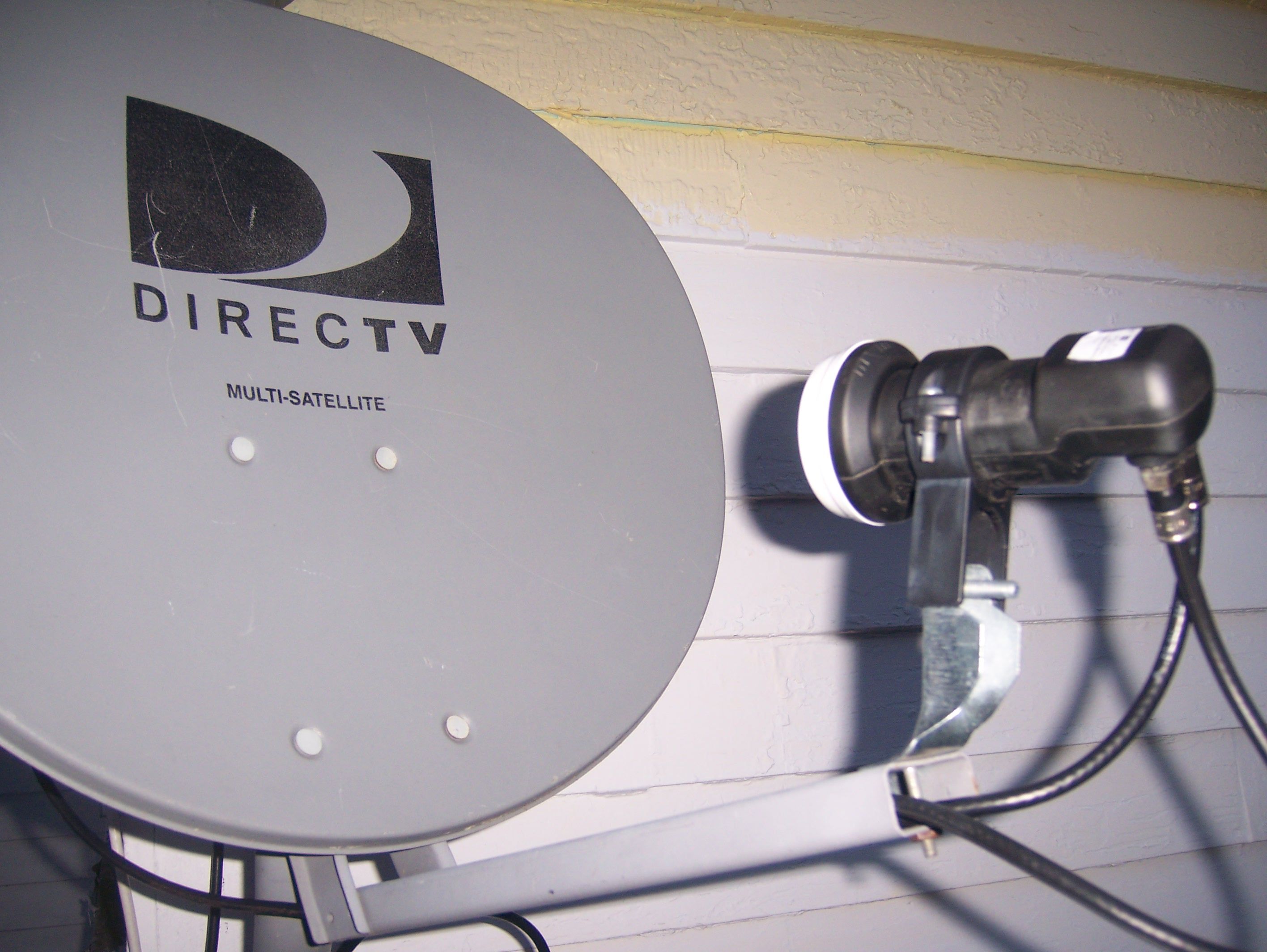

This how the lnb sits on the dish. Maybe it is not aiming at the dish properly?
It does look like the LNB is low. Looks like you may have mounted the bracket inside the arm to one of the holes in the bottom of the arm? Mount it on top of the arm, if that's the case, not inside. Or, what I did, was stick a thin board into the LNB arm and I mounted the LNB bracket to that, that way it's also centered and not slightly off by using one of the two existing holes. Your dish and bracket looks exactly like mine, but the end of your LNB arm looks like it maybe has a different mount than mine. I'll try to get a couple of pictures up of one of my Slimlines in the next day or so, so you can see where abouts the LNB should aim.

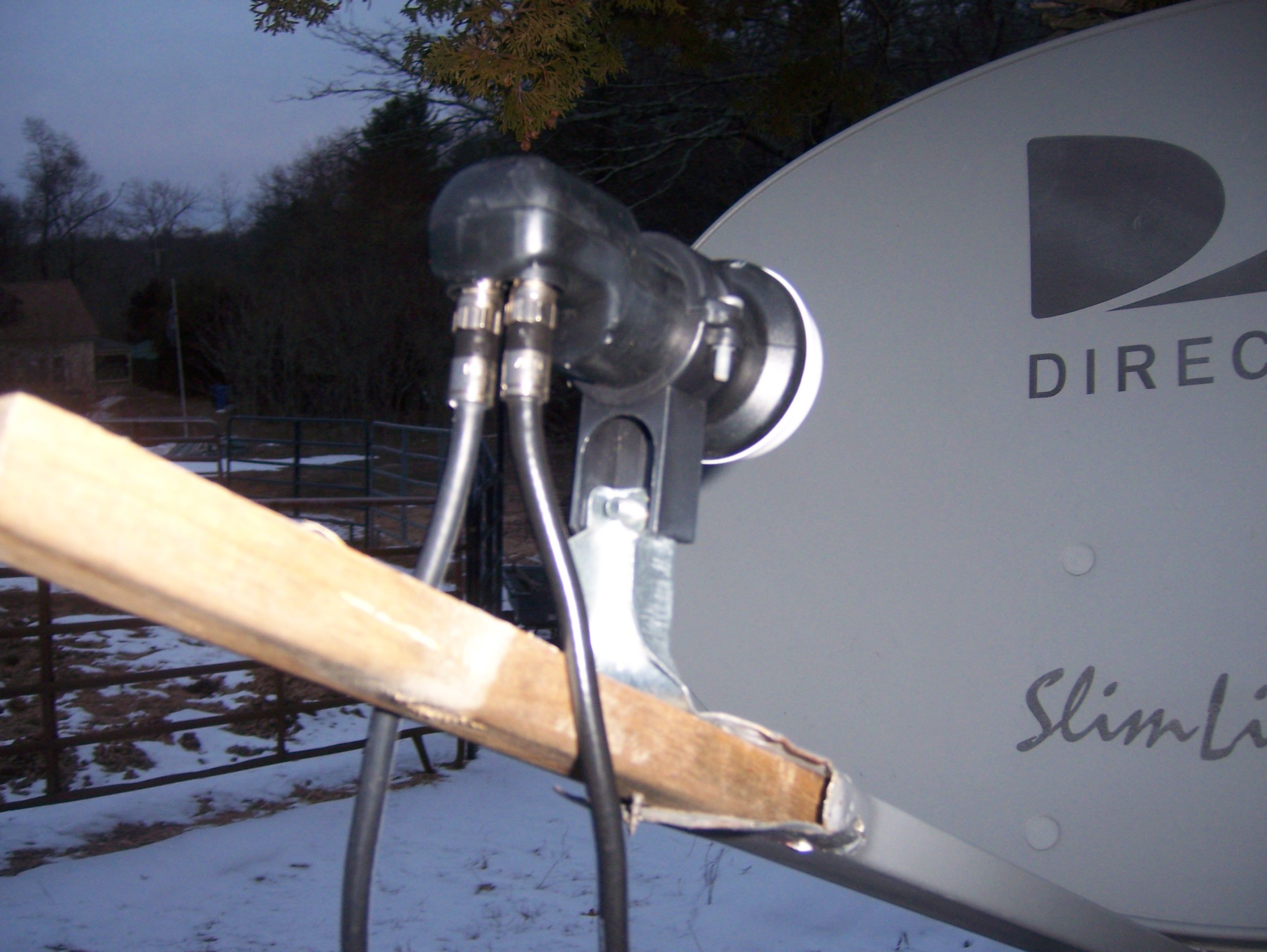

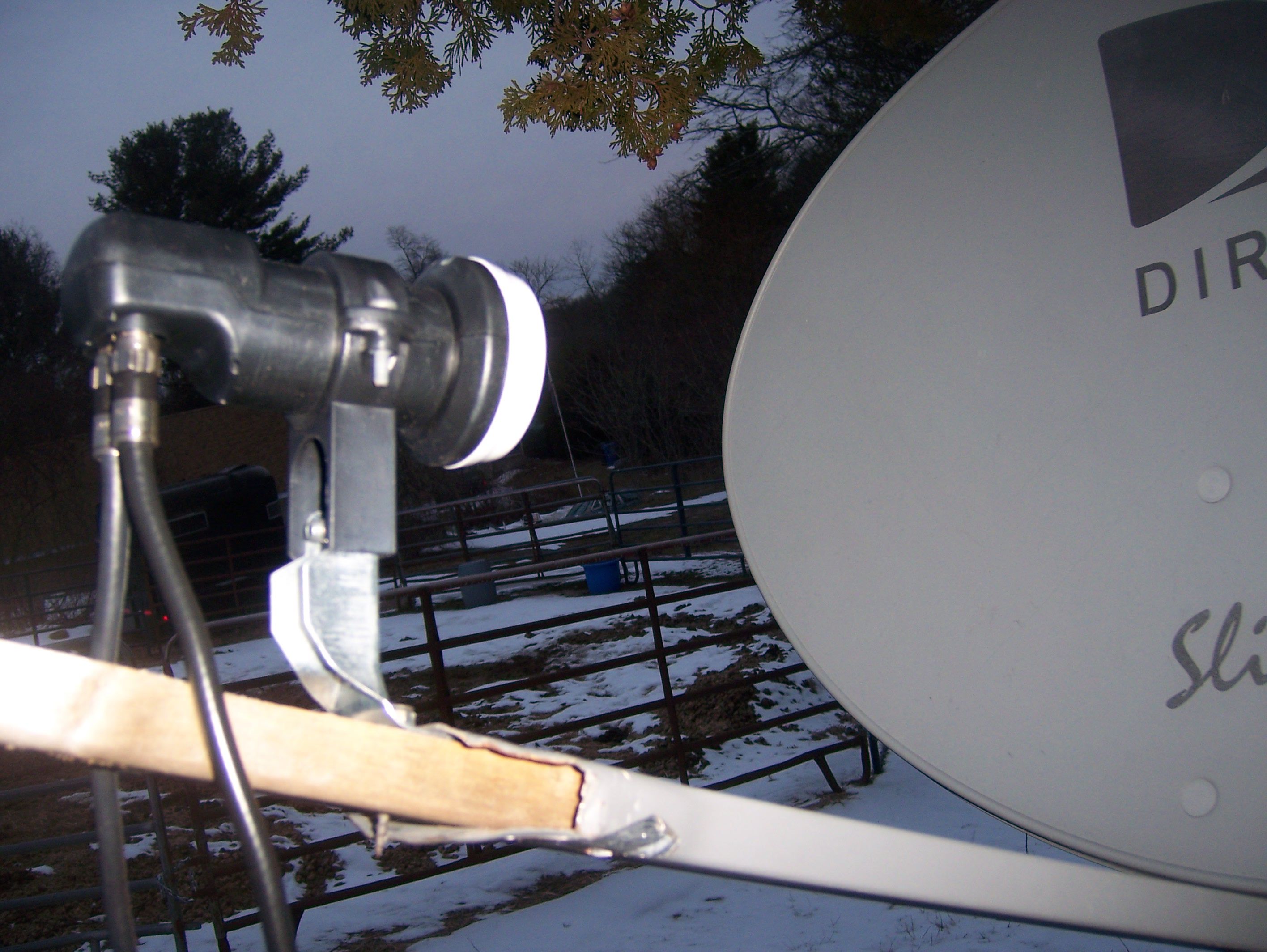

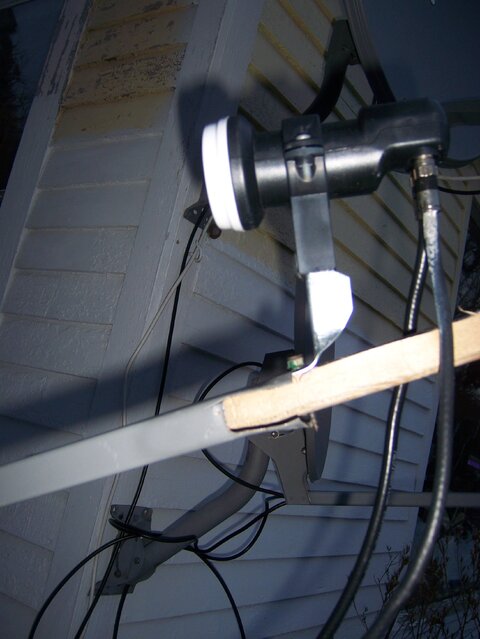

Here's a few pictures of my Slimline on 97W. It's not pretty, the person who had it before me had hacked the end of the arm up bad but it works good, even in snow/rain. The board doesn't need to stick out as far as it does, it's that way because I had another board mounted to the end of it with a block on it and a LNB aimed at another sat. It's gone now because for some reason or another, one of our horses liked to try to chew on it every time it walked by it, didn't bother with any of the others but that one, so I took it off.

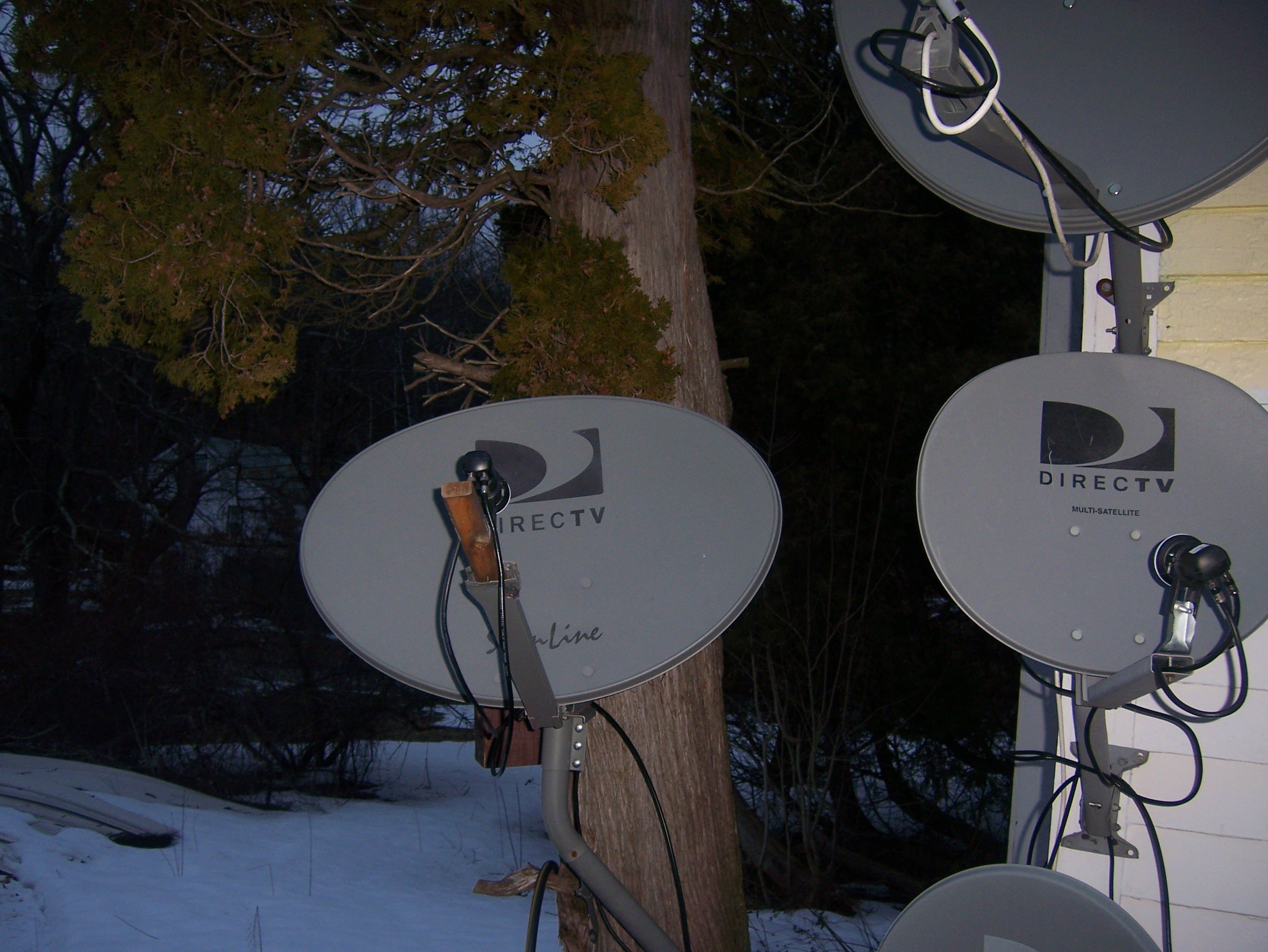

Here's my small 18X20 dish on 95W:
