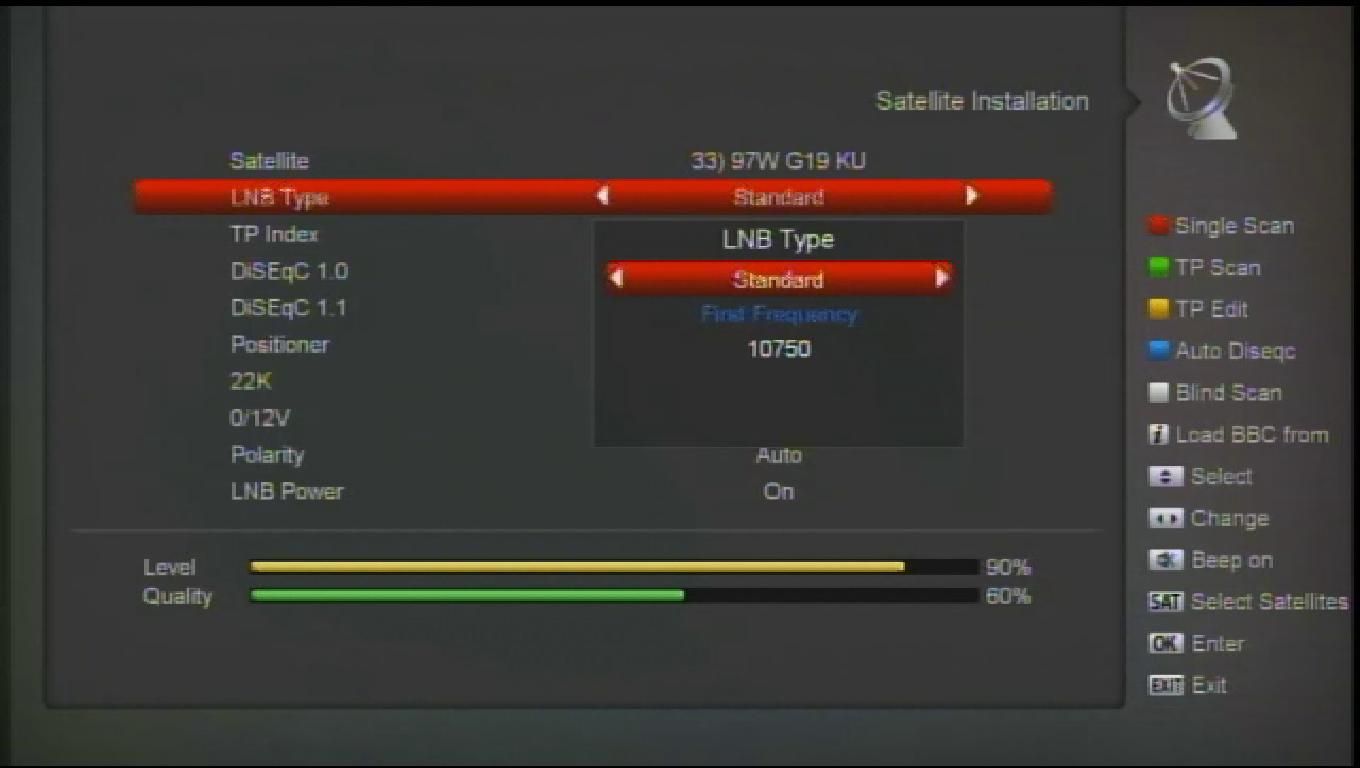

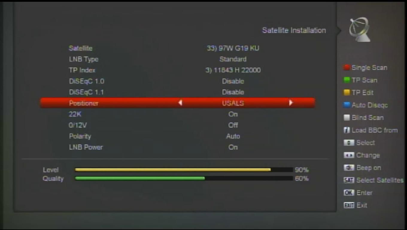

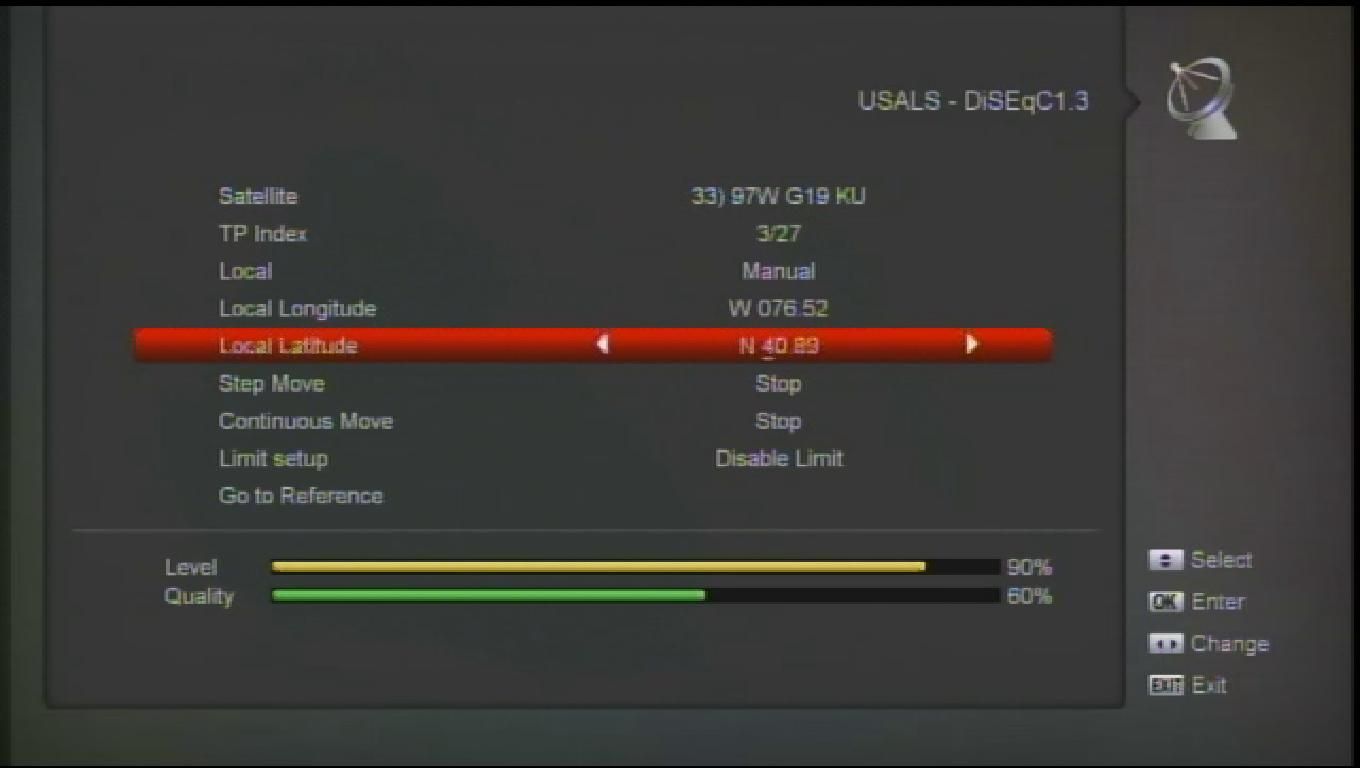

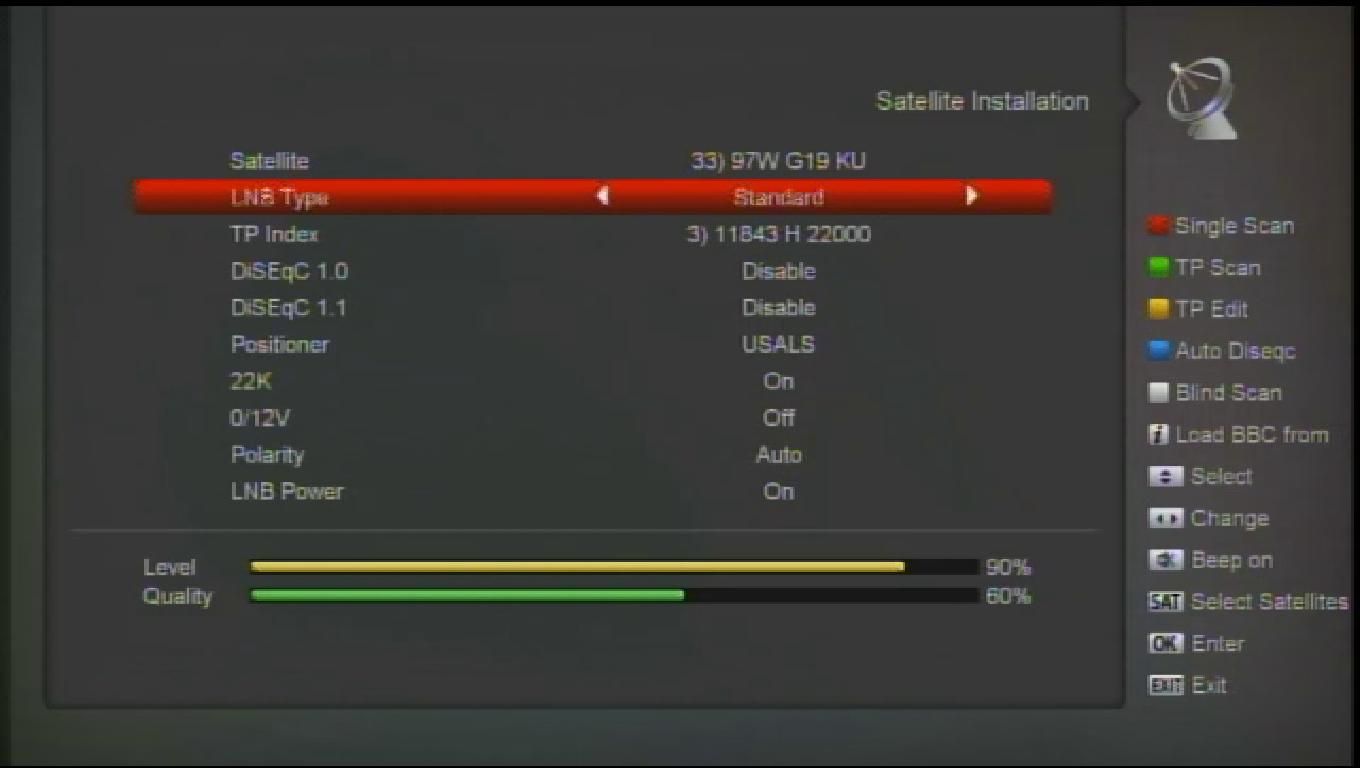

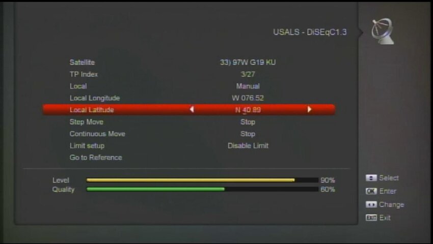

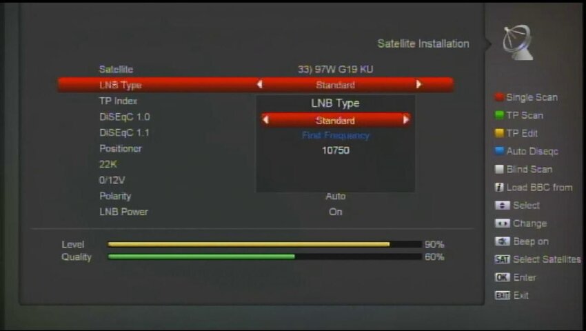

OK, the Amiko is much different from the old Pansat 3500. Can someone clue me in on settings for 97W? I have a PLL LNB, and I have my GPS coordinates. I am stumped as to what some of the settings would be. A picture of your 97W setup screen would be most helpful.
I tried to apply the same settings as the Pansat, but I must be doing something wrong.
Here are some screenshots:
Amiko Satellite Menu 97W
LNB Settings for 97W (Use arrow keys and press OK access the settings)
Next USALS and USALS Settings (Again, use arrow keys and press OK to access the settings)
You will of course need to enter your own values for lnb type, latitude and longitude. I am also using a 22KHz switch which you may not have. Press menu when done to save settings and return to previous screen. :)
I tried the calculator, and entered my data, and inserted 97.0 for the satellite So I must have done it wrong, since if I aim my dish the way it suggested, I would have to aim is south east, It did say the angle was 53 degrees, and that matched some other data I had. What I was not sure of, is if the slimline is and offset dish, would that angle be for a normal dish that is not offset? If there some way to get the proper angle from that?

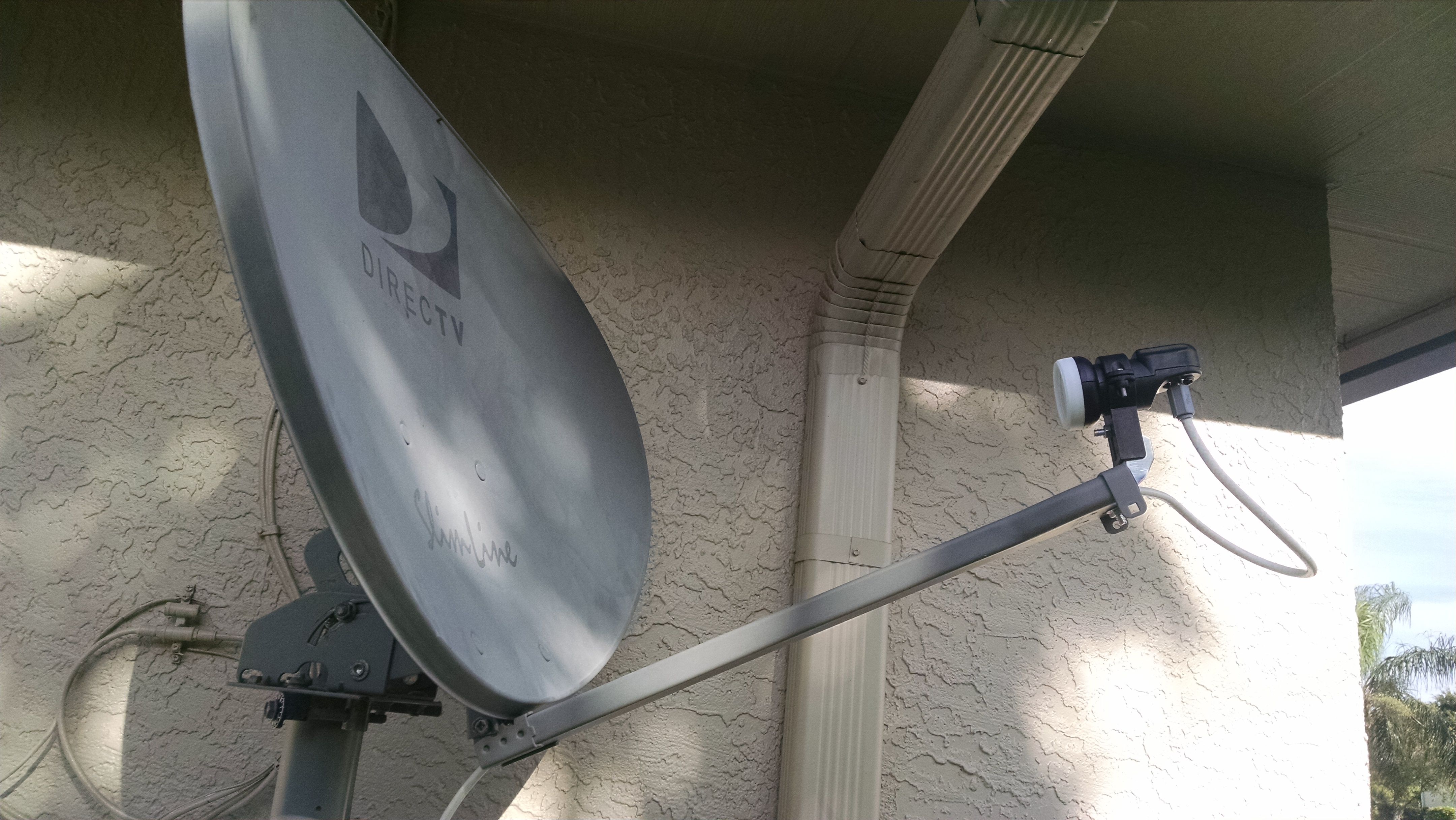

This how the lnb sits on the dish. Maybe it is not aiming at the dish properly?
Not much you can do if its the neighbor's tree unless you are on good terms with them. If you think the lnb may not be pointing properly, here is a thread from a member who did the slimline conversion. http://www.satelliteguys.us/xen/posts/3310163/
To me it looks like the lnbf is aiming low on the dish. I have two DTV converted dishes. I started off by taking measurements of where the middle lnbf was oriented. Then I tweeked for Q from there. The key is your lnbf should point to where the factory lnbf was pointing originally. Mine looks like the sweet spot is roughly in the middle. Mine is not a Slimline so I can't say 100%.
I agree you are aimed to low with the LNBF. Also your LNBF is not skewed. Go with the info FTA4PA provided above and make sure to skew that LNBF.
Good eyes Michael, I am noticing the lack of skew now.
Also in my picture the entire dish is skewed with the lnbf set at 0 degrees, in case anyone
gets confused.
