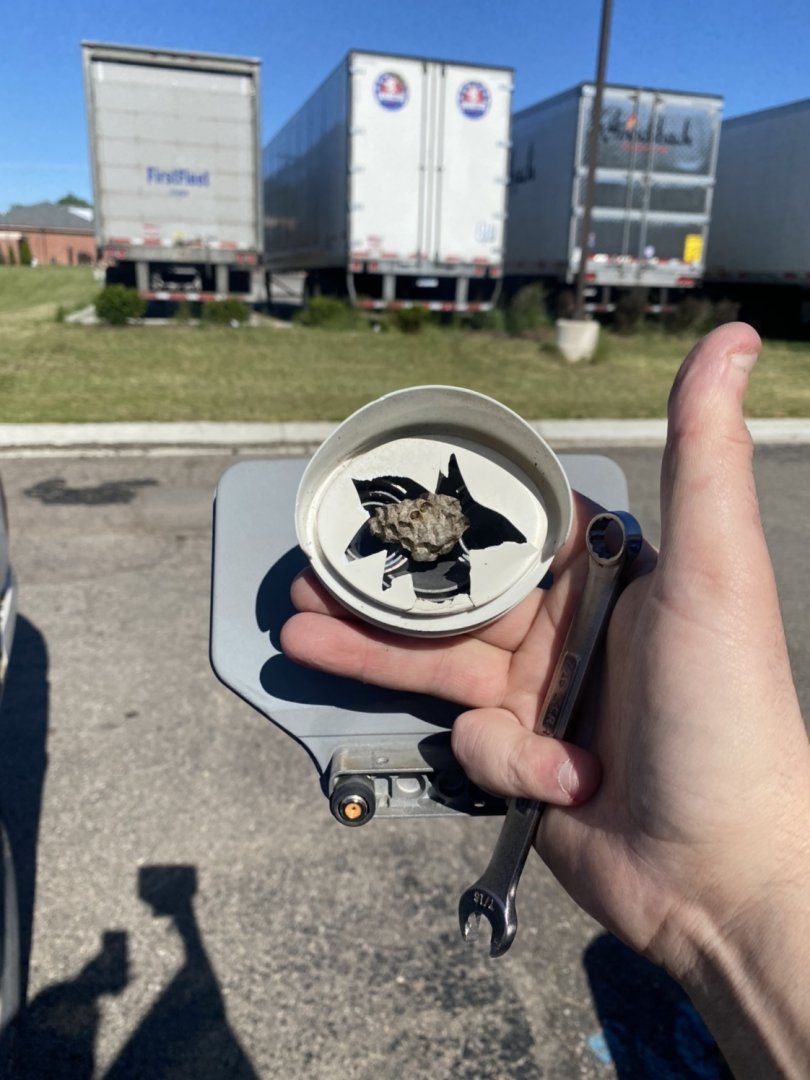

So went on a service call today because 8 rooms where not working.
It was originally wired in the walls with 1 Dish. Apparently another tech couldn't figure it out. Drilled holes in every room and ran 42 lines to the roof.
Issue was a bad LNB.
I did not do this job BTW

When I first glanced at the first picture, I thought it was a dead bird. Guess I need glasses....

I had the same problem with hornets taking up residence in my C-Band LNBF.
