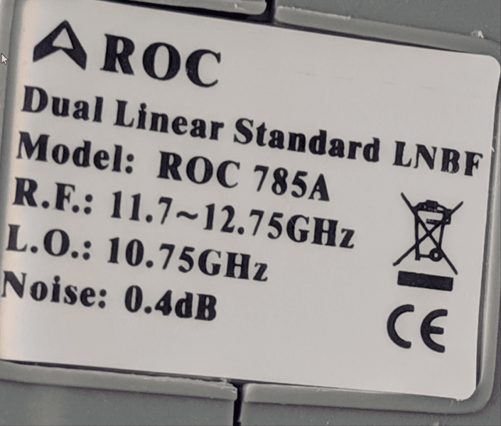

I have this LNBF, and I am not sure what to set the FTA Amico to for LNBF. The frequencies don't make too much sense to me. I will set the dish to 90 as suggested. I have a simple tone type sat meter, but it isn't helping so far, as I think I don't know exactly what I am doing. So this is a KU lnbf, and it will only get KU satellites as far as I know. Which of them with some decent content is the strongest, so i know which direction to point the dish. Also, what do i set the LNB as. I have a choice of Standard, USER,, and one of two others. Thanks to all who help. Joe
I have this LNBF, and I am not sure what to set the FTA Amico to for LNBF. The frequencies don't make too much sense to me. I will set the dish to 90 as suggested. I have a simple tone type sat meter, but it isn't helping so far, as I think I don't know exactly what I am doing. So this is a KU lnbf, and it will only get KU satellites as far as I know. Which of them with some decent content is the strongest, so i know which direction to point the dish. Also, what do i set the LNB as. I have a choice of Standard, USER,, and one of two others. Thanks to all who help. JoeView attachment 136212
It sounds like you have an Amiko receiver. Set the LNB to Standard (10750 is the starting frequency). I would start with 97W, it is a very strong satellite with many different high-powered transponders :)
I've never had much luck with those simple tone signal meters. If you are able, take the receiver outside with a portable TV. You can make your adjustments a lot more easily.
Also, in order to get any signal, you will need to add a transponder manually if there aren't any in your list. Try 11966 H 22000

Can't set it to standard and get 10750, but in universal I can set the start to 10750, but then it has a second, not sure if I have to set that. I can set the elevation to 53.2 per the dish pointer, and it shows which way to point, but I get nothing above a small yellow level. I put the dish even with the arm that holds it up, and tightened it. I am using the elevation guide on the dish, but I went from 50 to 55 and never saw the level pick up. Could there be something you are taking for granted in my ability, or understanding that you might have to mention?
