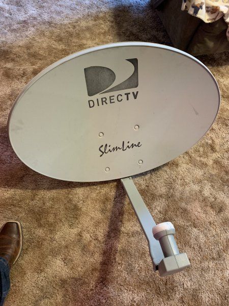

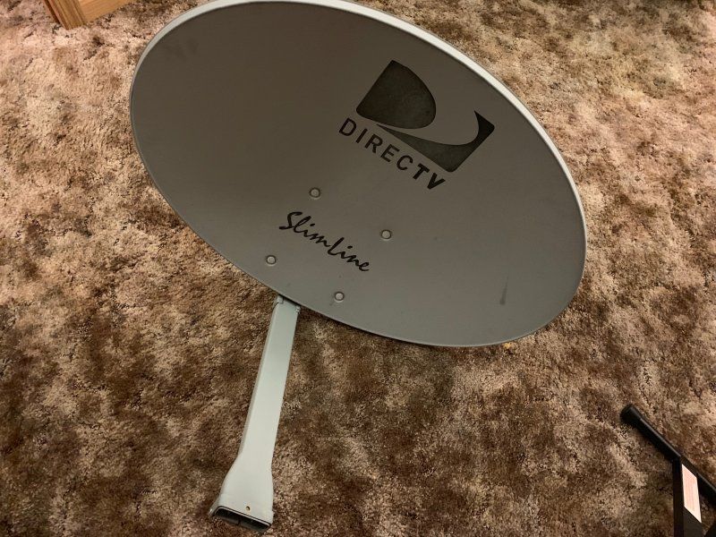

Helped a friend switch to Dish recently and the tech left the Directv dish behind, so I grabbed it and took it home. Haven't measured the dimensions yet, but it's larger than my Dish Network 1000.2 reflector. Can I do anything with this for Ku? I know 95 W has some feeds that will work, but would it work with maybe 97?

I've got 3 other larger dishes already, I'm just thinking of maybe making this Slimline a dedicated dish for 95 or 97 :)

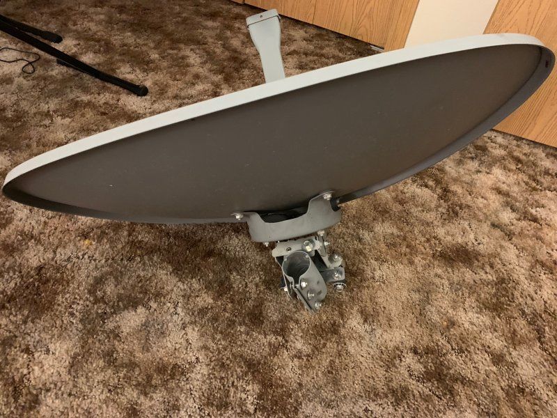

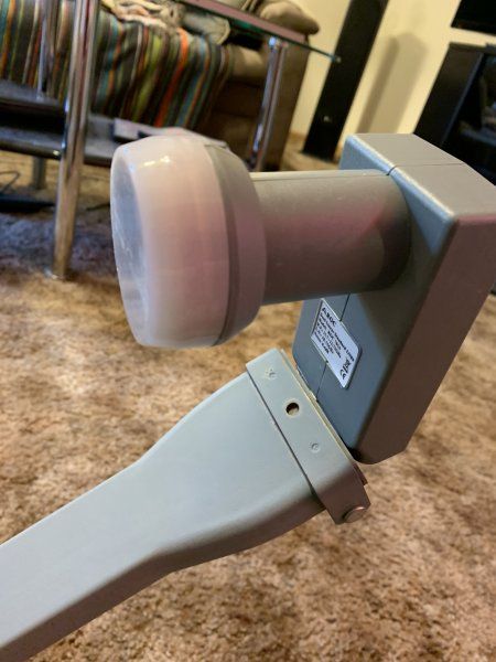

I ordered the LNB that raydio suggested and it fits the Slimline perfectly. Unfortunately I can't test it yet because the clamp is too big for any of my J-poles. So I either need to find a larger J-pole or find something to slip over the top of the existing pole.
Also, I measured this dish and it is just under 32" across. That's about 80 cm, which makes it wider than my 76cm dishes. Does that mean it will have similar performance to a 76cm dish?
Did you slip the PVC over a smaller J-pole?
You would have to determine what the difference in diameter is, then find the correct diameter of PVC pipe. If you are lucky you would be able to just slip it over the smaller pole. But that probably wont be the case. Also, PVC pipe comes in different thickness...schedule it's called. The higher the schedule number the thicker the wall of the pipe.
I believe they are about the same size as the 60E channelmasters. So they would be equivalent to a 24 inch dish or 60 cm.
I've done that... If I remember correctly, a 1-1/2" schedule 40, split lengthwise and forced open with a screwdriver blade will fit nice and tight on a 1-5/8 j-pole and bring it to about 50mm/2"

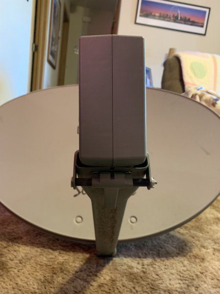

Well I picked up where CN left off with this project and finally had time to play today. I was able to get watchable channels on 87W Ku.
I used this LNBF - LINEAR DUAL LNB FSS SATELLITE LNBF FOR VIEWSAT PANSAT | eBay and it works great with the DirecTV Slimline dish.
I knew that I probably would not be able to lock LPB and I was right, it's hard enough with a 76cm dish. However I was able to lock real nice on the CNN Mux on 11960 with about 56% quality. Even better yet was The Florida Channel on 12044 - 73% Quality and even more surprising was The Patient Channel on 11800, was able to get about 58% quality. All watchable channels with no breakup.
