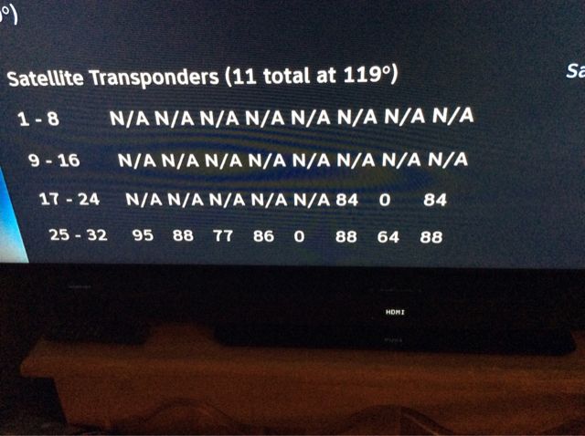

Mine is 33 for the 101 and 37 for the 119 but I have better luck putting it at 35 when I am putting the back assembly on. I thought the difference to the 119 was farther but I had to go look it up. The dB sounds like what I have got when I locked on the 119 on accident before. The transponder readings almost exactly match what the 119 will show. I just took this on my setup at home. The difference between OPs 0 on 24 and mine on 23 may be due to spot beams.

That said, OP, it would be ideal to get your zip code because the differences between the 101 and 119 can vary significantly depending on where you are. With that we can give you an accurate elevation, azimuth and tilt. Definitely sounds to me like you are on the 119.
