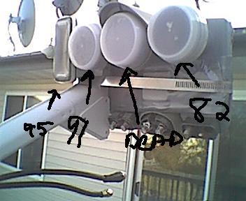

Here is a pic I had with a DIrecPC dish (same type)....the gap between LNB's is huge
in the pic I had used it for free to air for 95 and put 2 LNB's for 91 & 82 for my (at the time) bell ExpressVu subscription but to get both 91 & 82 to work I had to put a dummy LNB in between (see pic).
I had done it at the time to combine 2 dishes into 1...I didnt gain any points
