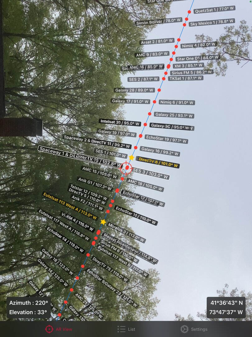

Are you 110% certain it is on 103W? How do you know for sure? When I'm on 103 W and fine tune two clicks to the east then I will get transponder 11704. However, when I blind scan directly from satellite 101W It find it there without fine tune adjustments.
I guess it's bleeding over for me from 101.

I'm kinda leaning to believe the tops of the trees have blossomed to such a point the signal is being blocked? I guess I'll know in the fall?
