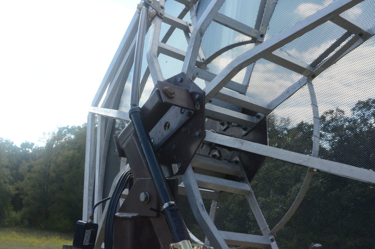

The vbox7 was purchased new September 9, 2013 and worked ok with light duty 24 inch actuator (1 5/8 diameter) until a wind gust broke the actuator.
Replaced it with my original 2 inch diameter 24 inch Thomson Saginaw Ball Actuator (
which had been stored in barn for the last 22 years) and it worked well for a couple of weeks.
When the problem was first noticed, pressing the buttons on vbox to move the dish would result in the actuator stopping movement (and counting) before buttons were released. The dish would move after the buttons were released and pressed again. Sometime the dish would move 50 or more counts and other times only 1,2,5, or 10 counts. Removed and cleaned motor, brushes, and oiled ball shaft in linear tube, but no change in operation. The actuator will run end to end on 5 volts dc and pulls a constant 1/2 amp or so from a dc power supply, so the actuator performance looks good. Put it back on dish and have same problem driving it with the vbox buttons.
Any suggestions and assistance appreciated as I have exhausted all my ideas!

Hi Magic Static. I tried the E & W buttons, but it does exactly the same thing as the pushbuttons on top. More than anything, it acts like it is tripping a current limit and resets when you turn loose of the button. That was why I ran the actuator on the bench to check the no load current consumption, which seemed reasonable. This was supposed to be the first of the HEAVY DUTY units, although if it is no more HEAVY DUTY than the first actuator, then marketing speak wins again! When I look inside the unit, there are a couple of relays which must actually provide current for the motor from an unregulated power supply inside the unit.

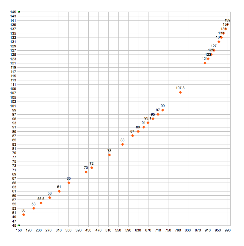

Thanks Magic Static. That would be nice. I tried again with the remote, but still same problem. I have an old Houston Tracker (Echosphere) Model 70 receiver that has never been used as I bought it new just before I moved from California and it has been packed away ever since. Somewhere the remote control is packed away in another box!!!!!! If all else fails, that is my fallback position. I sure would like to make a vbox work and they must for so many people to be using them. The reason I am using the buttons so much is that I have been recording all satellite positions so I can set up the DiSeqC 1.2 interface to my AZBox and X2 Premium HD.
