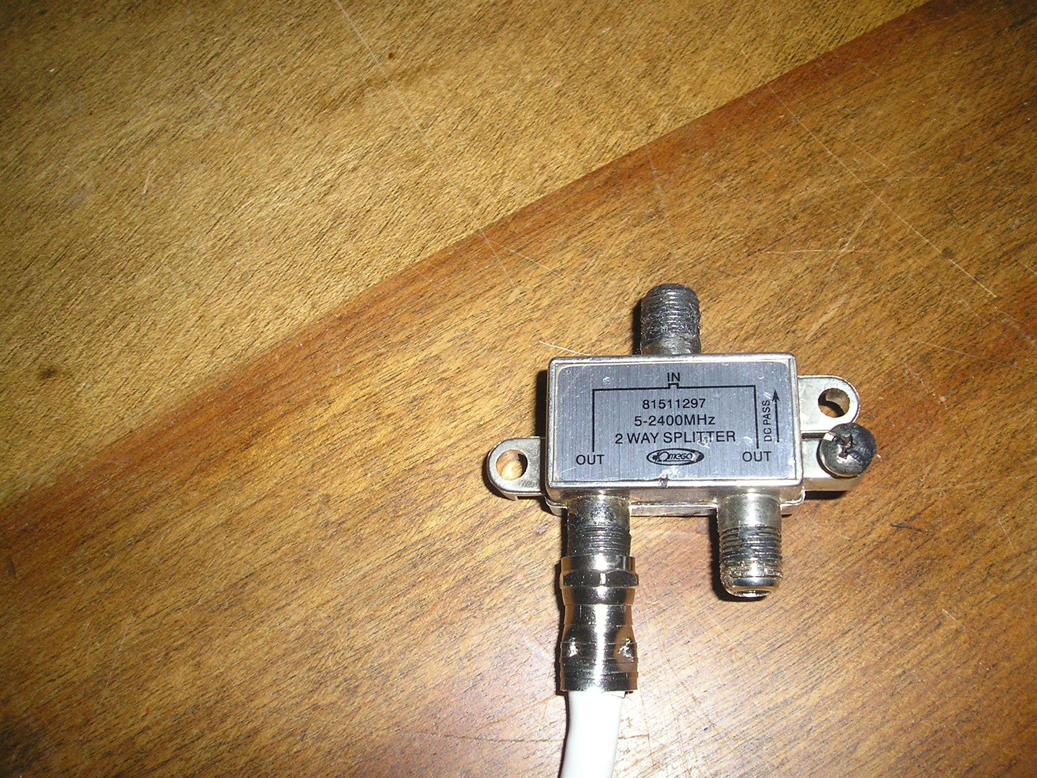

I have a C/Ku setup with a Drake 1724 analog receiver (see my sig); I use the Drake to move the dish and activate the skew of my LNBs. The system has been working properly in analog times. To use the digital signals I used for some time a PC card, and lately a CoolSat 6100 receiver; I am using the setup described here (Add a receiver). to feed the digital receiver: the IN of the splitter is connected to the LNB (C or KU), the OUT with DC passing is connected to the Drake, and the other OUT if finally connected to one feed of a diseqc switch.

"the IN of the splitter is connected to the LNB (C or KU)"
Are you using 2 splitters?
Yes, for each LNB (C and Ku), one splitter each.
