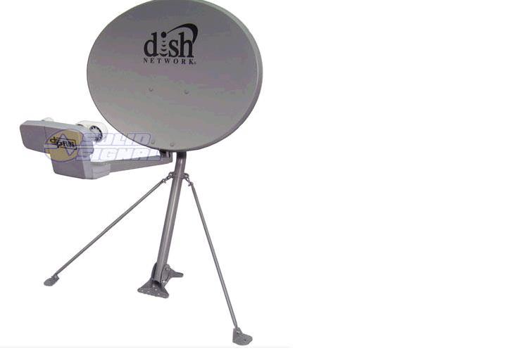

I have one dish install at one house and want to put a dish up at my other in vegas. I got a 1000.2 in a box but guy who came out to install it told me i would probably need braces to secure it, current mount wouldnt do it alone because it was going on the eve of 2 story house (neighbour has one) and wind could whip it around. He didnt have any at the time so he went. However after 6 months putting it off i go to call him and hes out of business. So can anyone recommend what braces i need - pic attached of what i am after (on the wrong dish).
URL good place to pick one up be great or reference to what i need.
And any good recommendations for someone to climb 2 stories up a ladder and install it :) One story was enough for me on my other place.

The "struts" will indeed fit the mast. However I am wondering why you believe you need them.
With the 1000.2 masts are not required nor needed provided the mast foot is securely mounted with 6 bolts into solid material. Wood ,brick or (not recommended) cement fiber board(Hardyboard)
Now, what do you mean by "eave"?..is it on the facia of the roof? The facia is the part which is perpendicular to the roof. Pictrue the edge of the roof where it overhangs the exterior of the outside wall of the house. The proper term for the overhang is the "soffit". MOst folks call this the "eave".. Not an improper term. Soffit is more accurate....

Warning. Unless the construction of your home has at least 2x8 roof rafters, the mast foot cannot be properly secured to the facia. The outermost rafter that makes up the last rafter is known as the facia board. All 4 corners of the mast foot have lag bolts thru them and into wood.
If the tech mounted the dish in such a manner that it is not secure, it is NOT to Dish specs. It is my recomendation that you call dish and request a service visit due to improper mounting of the Dish.
Bottom line...For an install to be complete, the job MUST be to Dish Network specifications.

Go ahead and get the struts if you can. .4 and .2 , as well as 500's have same mast size. Don't listen to the crazy talk about not needing them. Those guys live where there isn't wind. You might want to make sure there are four bolts on they skew plate as well. They are regulation, but are rarely used around here. It might take 30 seconds and these brilliant tech's. cant waste their time on that!

Look Mr.Knowitall the 1000.2 never required struts. It is only a bit larger than a Dish500, and not much heavier.
The 1000.4 is a much larger and more important, a much heavier dish than the Dish500. Thus the 1000.4 required struts.
Although the 500, 1000.2 and 1000.4 all use a 1 5/8" mast, so the struts for the 1000.4 could be used on any of them. The only reason to use struts on a 1000.2 is a poor mount, or maybe the need to have a very extended mast.
