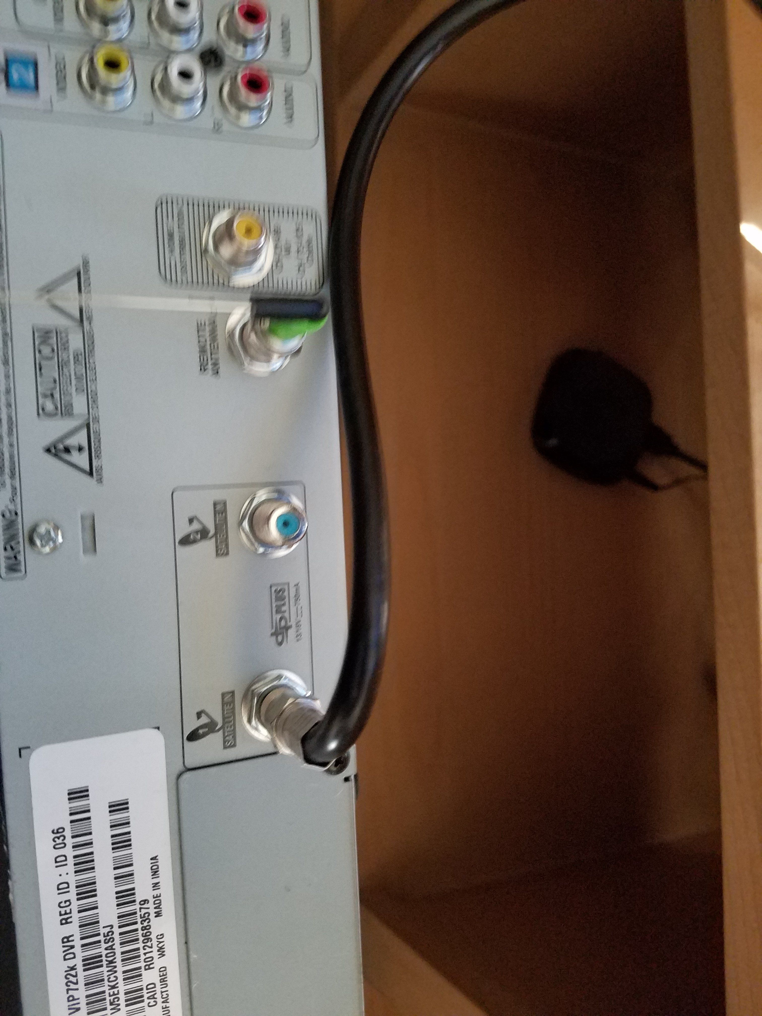

Hello am new to this so i only have one reciver its a vip 722k only using it for one tv no duo i need help so i got a lbn plus the has port 1 2 3 and 4th says lbn which one do i contect to i have the package latino i need help
This is how it is i have contect to port 1

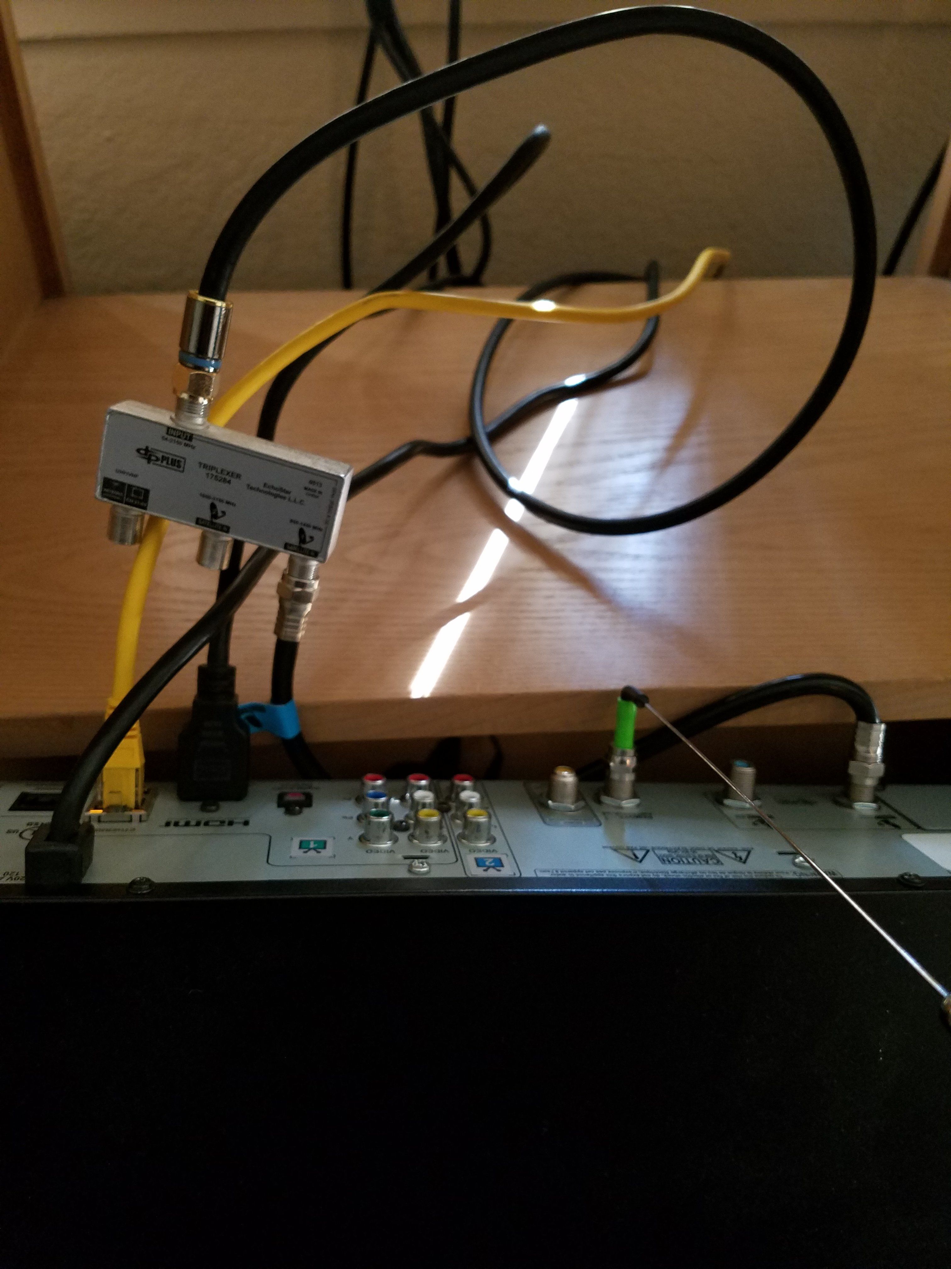

No a Separator takes a single line, and splits it into 2 to connect to Sat 1 and Sat 2.
That avoids the need to Run 2 lines from the dish.
But Ive never seen 1 coax to the back of a duo receiver.
You need to use Port 1, 2 or3 on your LNB, take off that tripleplexer, put in a Separator, and have 2 small coax jumpers going to 1 and 2 on the back of the 722.
Or if you insist on using that tripleplexer, you still need a jumper from sat 2, going to sat 2 on the 722

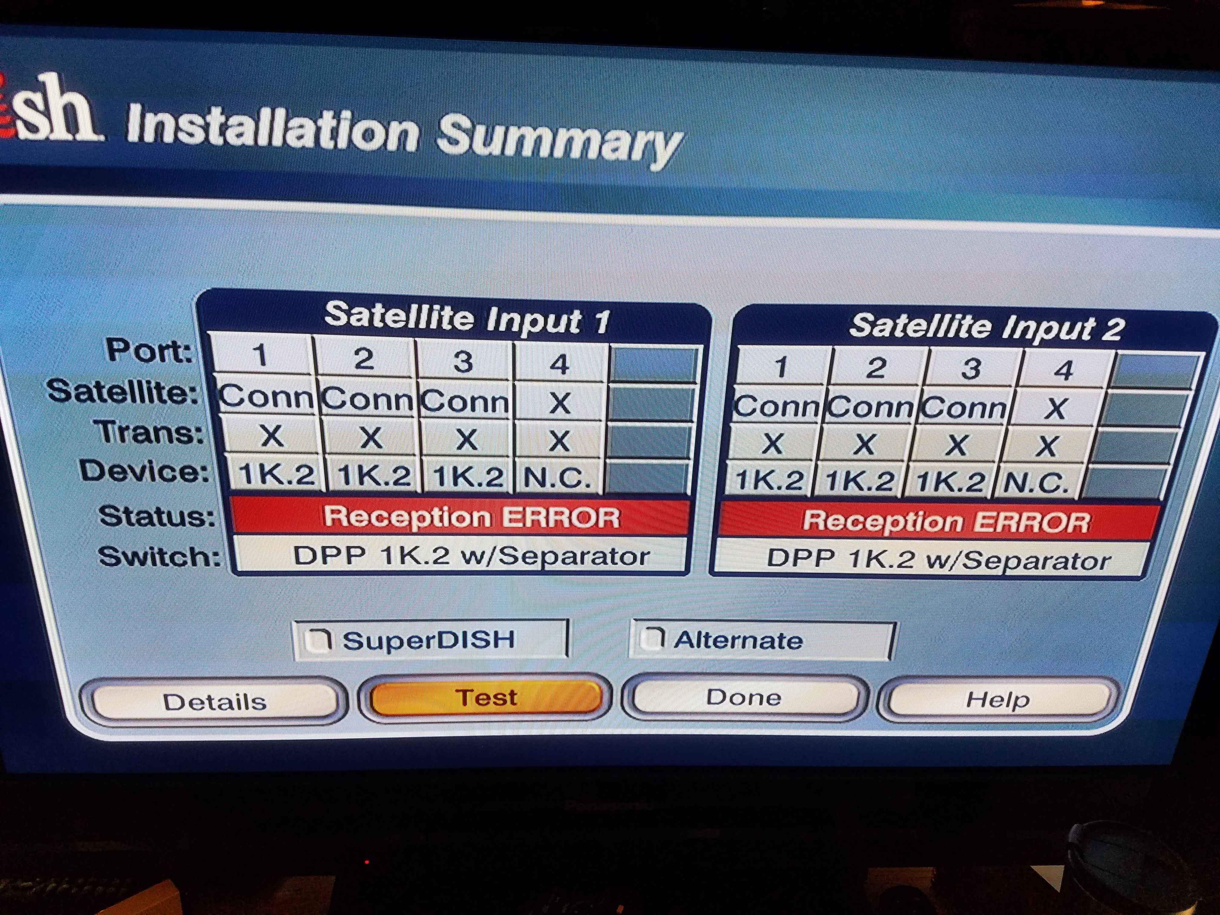

Another issue I see, your Check switch shows you have a Separator, when in fact you equipped a Tripleplexer .
I dont even see OTA connected to it.
So there is another issue.
You just need one more cable from the triplexer "satellite in 2" to the back of the receiver. After that you need to run "check switch" again.
