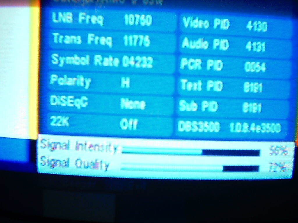

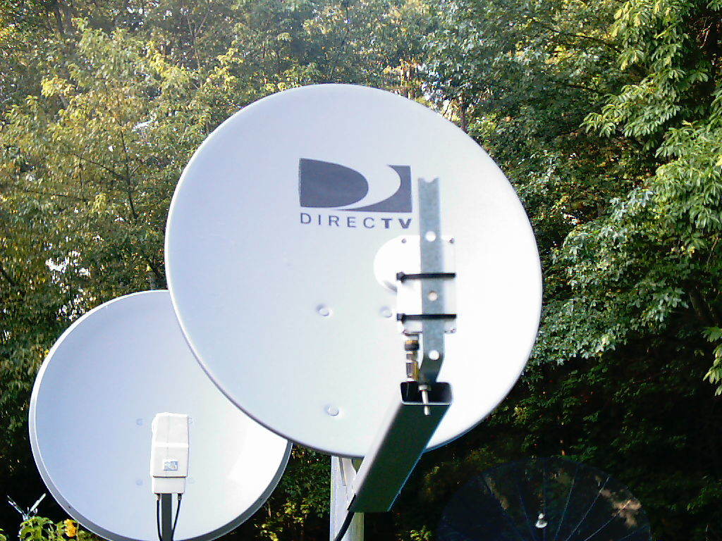

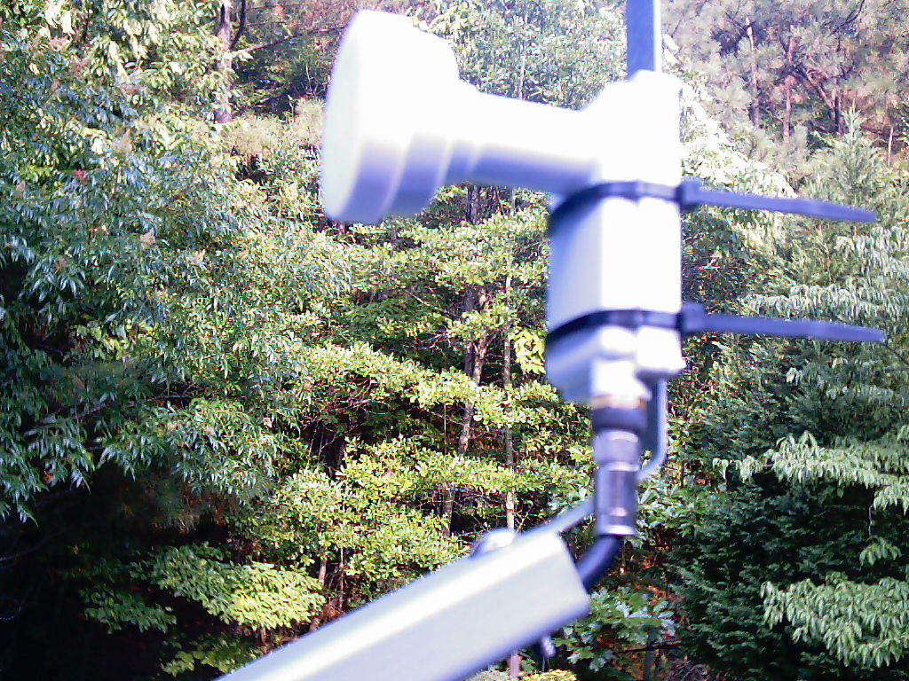

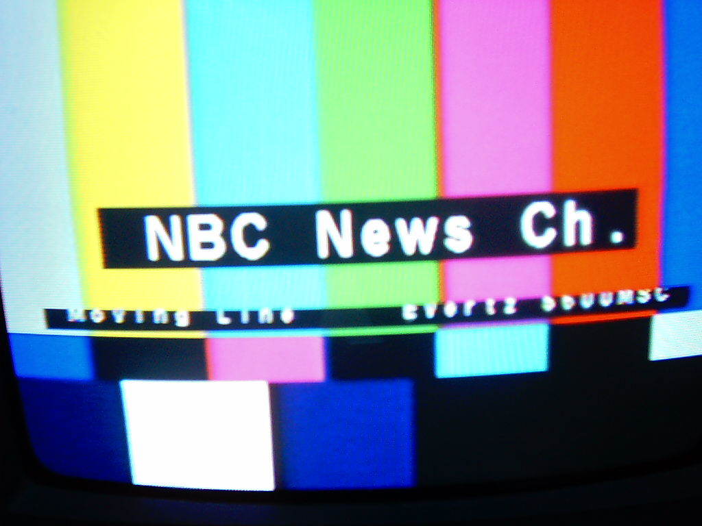

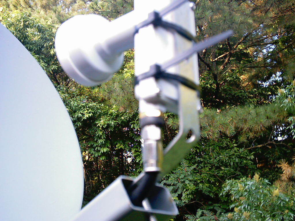

Some decent weather has moved in and I got a chance to play until the mosquitos decided to eat me for dinner.
I was able to get AMC9 easily. I will try for a few more sats tomorrow if the rain stays away.

For me prob about 2hrs work LOL-I will look for that metal thing on my next trip to
the building supply. Seems like something you should always have on hand.
For experiments.

"by the throat" ?
That will NEVER work for the long haul.
Wanna know why?
Well, do ya?
Because unless you put that sucker on a motor, you'd better be able to skew the dish itself.
That's why we usually grab the LNB by the throat - so we can twist it where necessary. :cool:
Actually, both the Dish 500 and the Phase III dishes will skew, so that saves your bacon! :up
. . . and not to be a heretic, but I favor green tie-wraps for some reason . . .
Yea I thought about the skew issue but figured it won't matter for a little experiment with my true south sat and a few nearby. I can actually do a slight skew with the way that bracket is set up.
