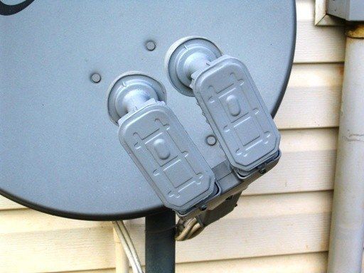

Here is a photo of my Dish500 with two used DirecTV lnb's. The mounting is very stable.
Wow, that will do trick.
