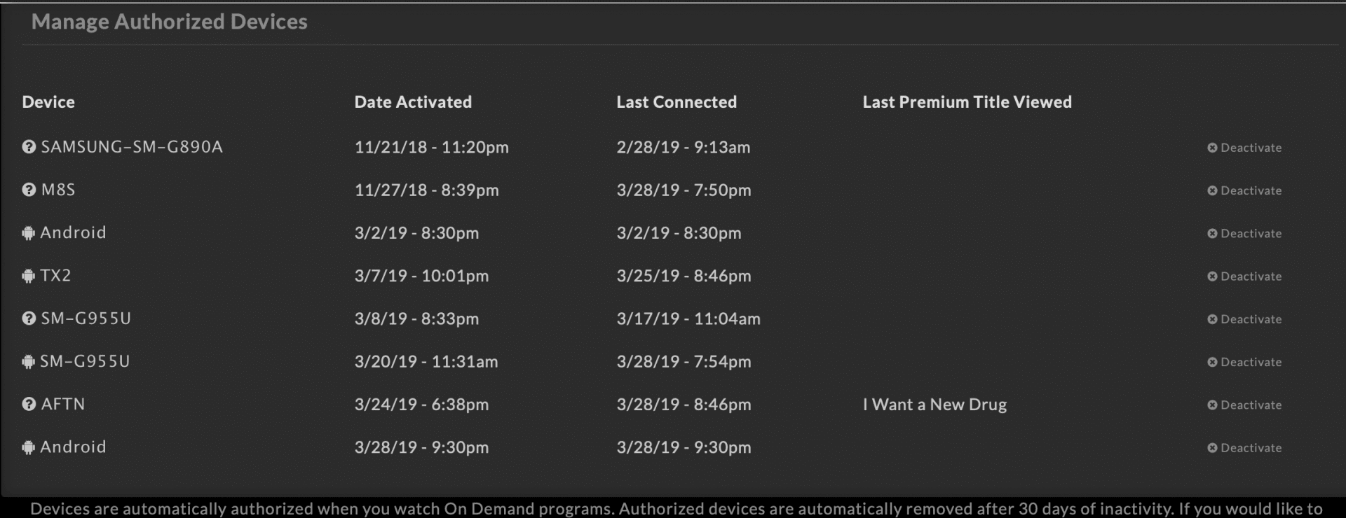

well i was able to login into dishanywhere and i noticed allot of different logins. I'm the only person that has the password and i use dish anywhere on a fire tv in another room. so i deactivated everything that was login in.
And if it reoccurs, it's time to change the password as mentioned earlier.
