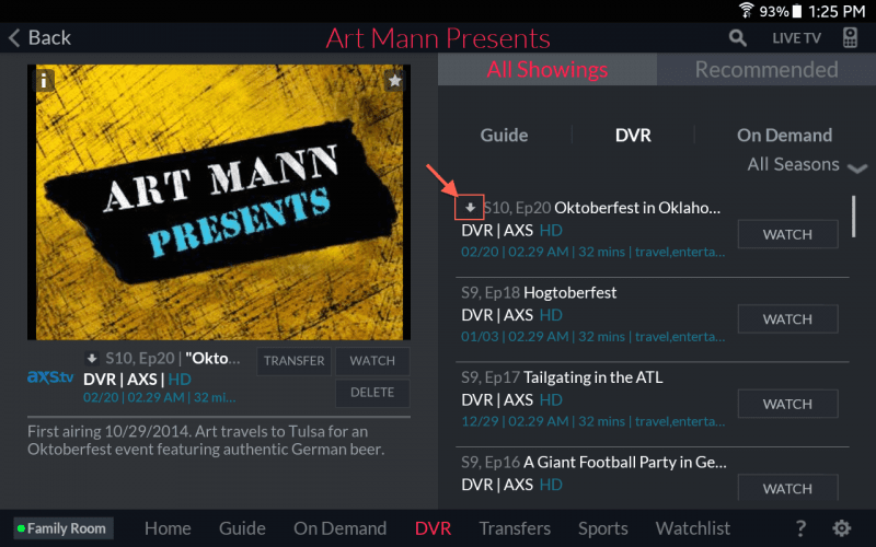

In case anyone finds this post. I thought that the Hopper will keep the prepared files until the recording is finally deleted. I guess not. Did not notice the little down arrow icon which means you can transfer immediately as it has been processed on the Hopper. If no icon then there is no prepared file on the Hopper.
Looks like the prepared file will be available for a few weeks then it is purged. You have to go through the prepare file process again if you want to download it.
