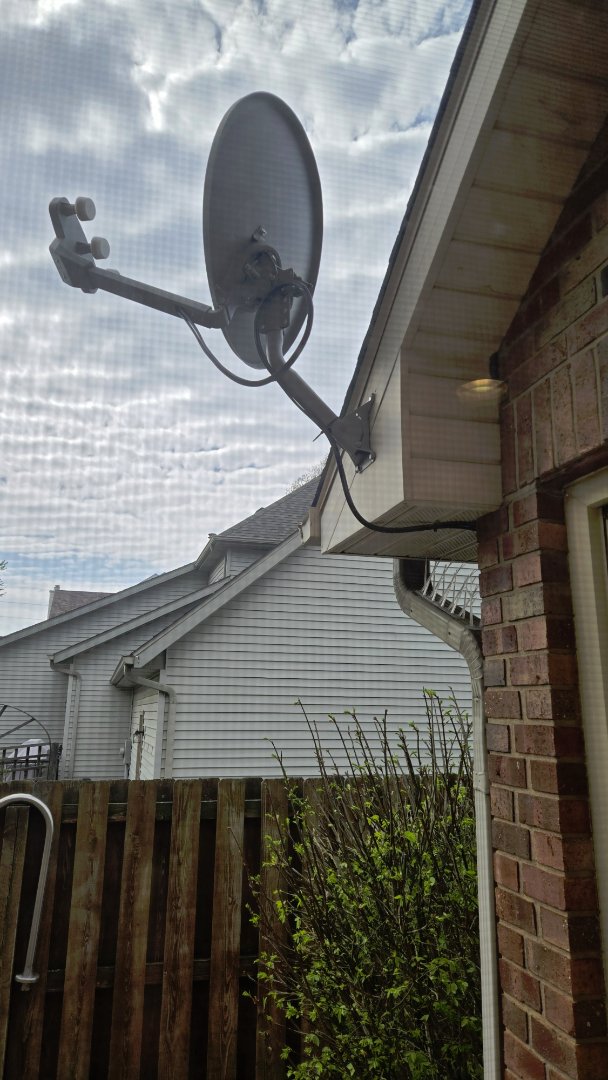

Also, isn't there any parts of your house that have a solid, flat mounting surface, that you could have the dish mounted on instead? Like a fascia area, etc.? It would sure make things a lot quicker/easier & you wouldn't have to deal with burying the cable... ;)
(my mounting pic)
I don't know for sure, as I don't work for DISH, but I would think they would...but you'll need to confirm with whomever does it.
OK, thanks. No, all my stuff is in the basement. See my Avitar. The wall is the best area. When ever the satelittes run out of fuel, the pole mount would be easy to remove and no holes left in the wall.
