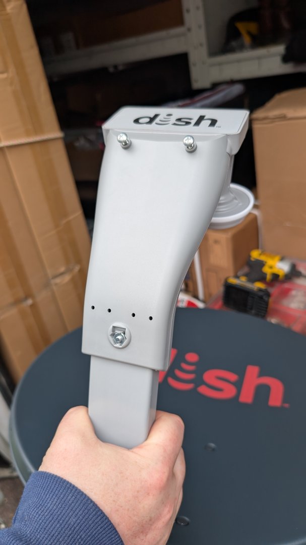

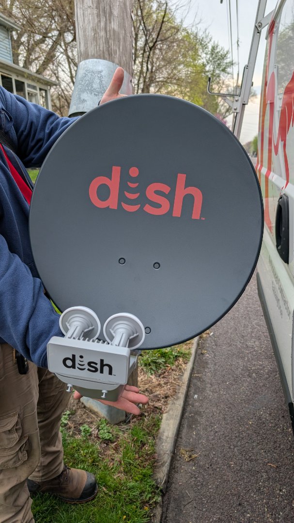

You probably seen the reflector, but not the LNB
Thank you much for all the pics...
I'm particularly glad you posted the whole dish, as I did not know that the new WA LNBF would use a different mounting yoke than the previous "Y" mount from the earlier D500. It appears to be a new yoke that is specifically for this new D500 DPH WA LNBF, correct?
Does the LNBF come with the new yoke, or is it a separate part that must be ordered?
It's a separate part. When I get back to my shop next week, I can pull the DN numbers

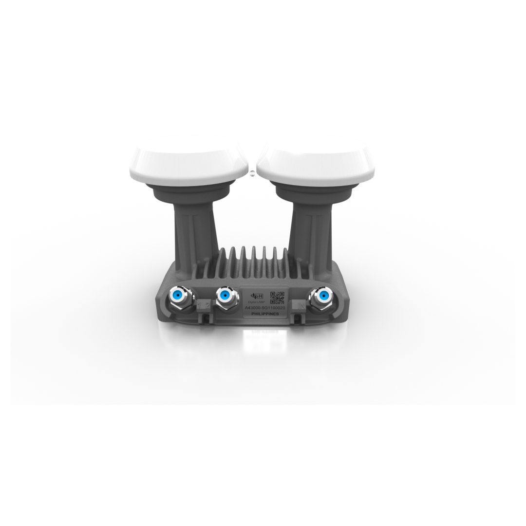

Thx - one last question, what are the connections on it? I would assume there are 2 outputs, like on the other DPH LNB's, correct?
And like on those others, when you connect an H3 to the 1st output, the other output is disabled, correct?
I also assume there is NO input, since obviously all the other orbital slots are/will be gone, correct?
Correct on the outputs, but for some reason, it does have an input
