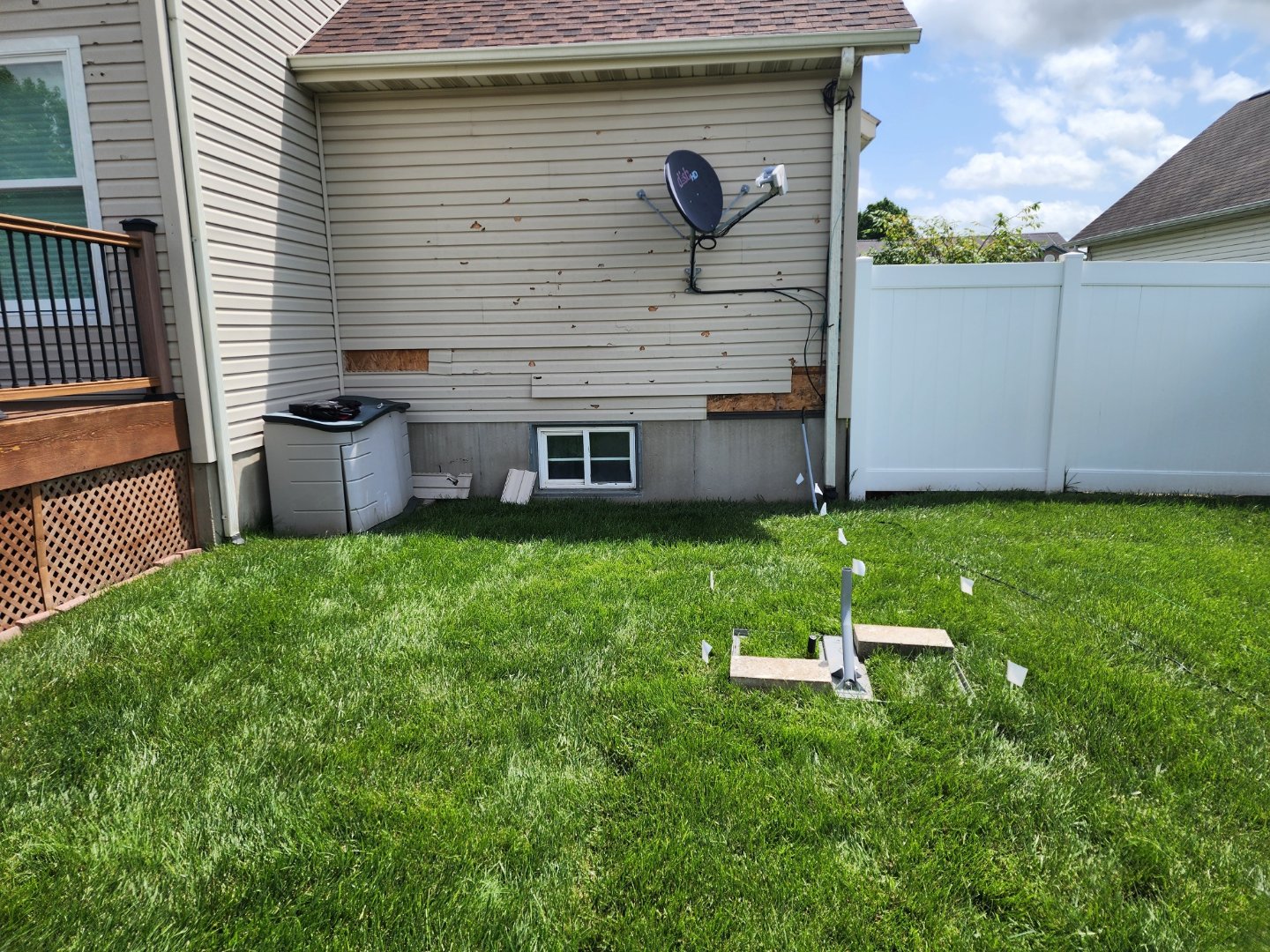

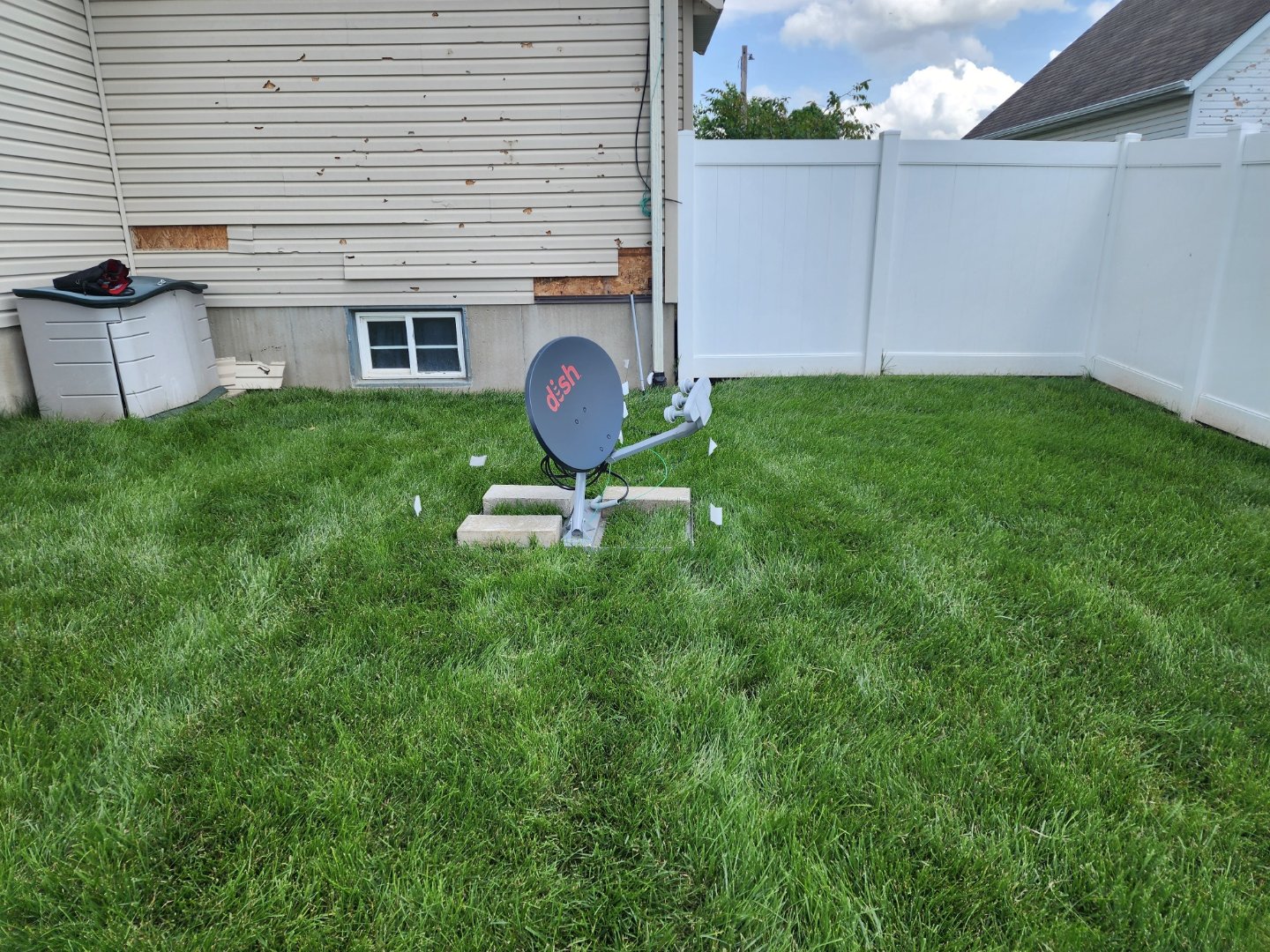

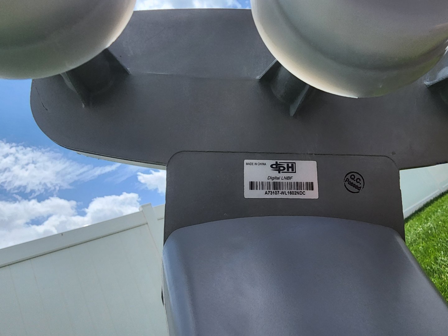

Dish stopped by today to install a pole mount. No one called Jule to mark utilities, he will come back for the pole mount next week after utilities are marked. So, he temp installed a 1000.2 western arc with three Hybrid LNBs. I told him that I needed DPP LNBs because I have a DPH42 switch that feed both Hopper 3s. He said no switch is required anymore that the 119 and 110 coax go direct to a Duo Hub. So, after he temp installed the dish we went to the basement to bypass my DPH42 switch and connect coax direct to my Duo Hub. He saw the switch and noticed it said DPH on it and said he doesn't need to bypass it. I said I didn't think the DPH LNBs shouldn't have a DPH42 switch in the mix. He said it was OK. So, we checked the Hopper 3s out and they both work OK with signal strength in the lower 70s.
Installers, is it ok to have Hybrid LNBs connected to a DPH42 switch? Both Hopper 3s don't have any problems so far. Will this cause issues down the road? Also, is someone at Dish suppose to call Julie to mark utilities for pole mounts or was I supposed to call them?

The DPH42 switch should be used with DP or DPP LNBFs, not DPH, it's on page 5 of the DPH42 manual.

Technician was an internal tech from the Dish office in St Charles, MO, just outside of St Louis. He clearly needs more training for two Hopper 3s setup. I am going to reach out today to Dish tech support in Colorado and let them know about my install venture. The technician acted surprised that utilities weren't marked yet. I never got a clear answer from him about why Julie wasn't called. After he got done yesterday, he called Julie to set up the utilities work order. Suppose to be done by Friday and Dish pole mount install is scheduled for next Thursday.

Unless YOU are doing the work, you do not call in the locate. The company that is doing the work is required to make the call
I talked to Dish tech support. She said there isn't any problems using DPH LNBs with a DPH42 switch. She went in and looked at my Hopper 3 Plus electronic readings and said everything looks good. Also, she said they are still developing a new two LNB setup for the Western Arc 1000.2 dish since 129 is gone.
