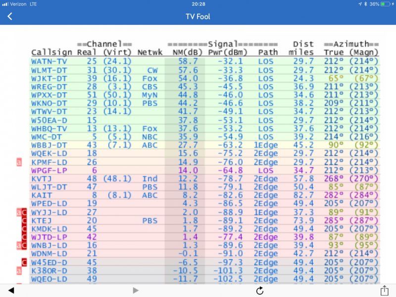

I don't understand all that mess....but I do understand enough to know that it says I'm only about 35 miles.....The station I'm looking into is WMCTV. I'm attaching the info here:

Your TVFool report looks much better than the generic I got, but you still need an all channel antenna to get WMC and the other stations because WMC is channel 5 VHF low.
Not necessarily a Winegard 8200 but there are many other all channel antennas out there that aren't 15ft long that would work for you like the RCA ANT3036 - about $80.
I'd buy something like that at a place where it can be returned and put it up and see if it works.
Remember - DTV reception is more of an art than a science..
