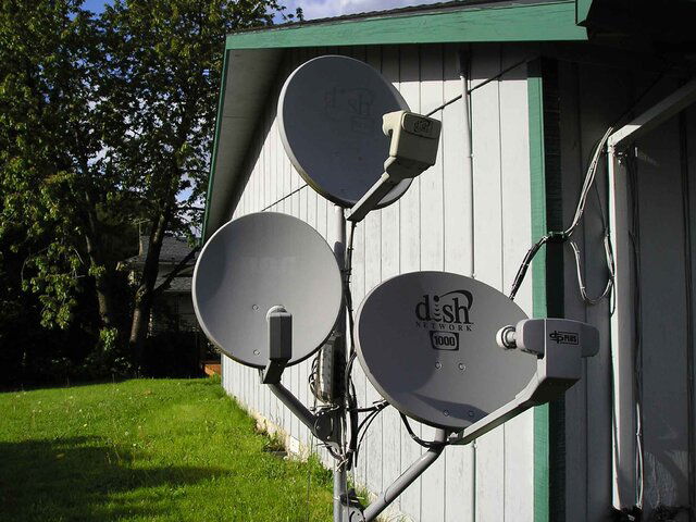

Dish made and branded equipment is also not working with the current release, it has nothing to do with third-party equipment. It's the 22khz switching matrix code that is hozed. Somebody screwed up the even/odd logic for sat 3 when using 129. The SW64 is a supported switch for DPP equipment.
Dish just screwed up a software release. This is not the first time they have done it either. Legacy switching is not being phased out. This whole thread is a way to make a stink so they will fix it faster.
DPP 3 sat, legacy 3 sat SW64 110,119,129

Well, if this wasn't Dish's problem, their latest software release for the VIP211 and VIP211K sure fixed it. I noticed earlier this week that a new software releases were rolling out for those two receivers. I told my neighbor to keep Dish for a few more days and to watch for the new software. When he called this morning to say he had L456 on his K, it was showtime. We cleared the switch matrix, took it out to the RV, plugged it into the CarryOut and it immediately went to a check switch. Upon completion both odds and evens were okay on 129, the switch was identified as a SW64 and all HD channels worked.
I did some nosing around and found out new releases will be forthcoming for the rest of the VIP series to "correct some issues with 129 Ciel II."
Yes, the purpose of this post was to get Dish's attention. Vindication is oh so cool.
