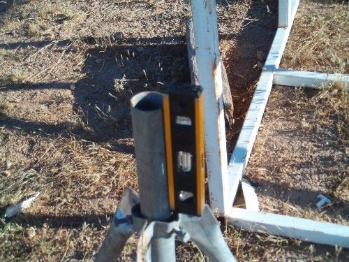

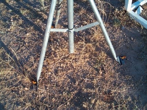

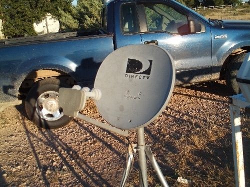

Heres the tripod I take tent camping... use tent stakes to keep stable and a magnetic level...on my old campers I found places to mount 2 x 6's to put a regular mount on...(I only go to the hills with my campers..)
