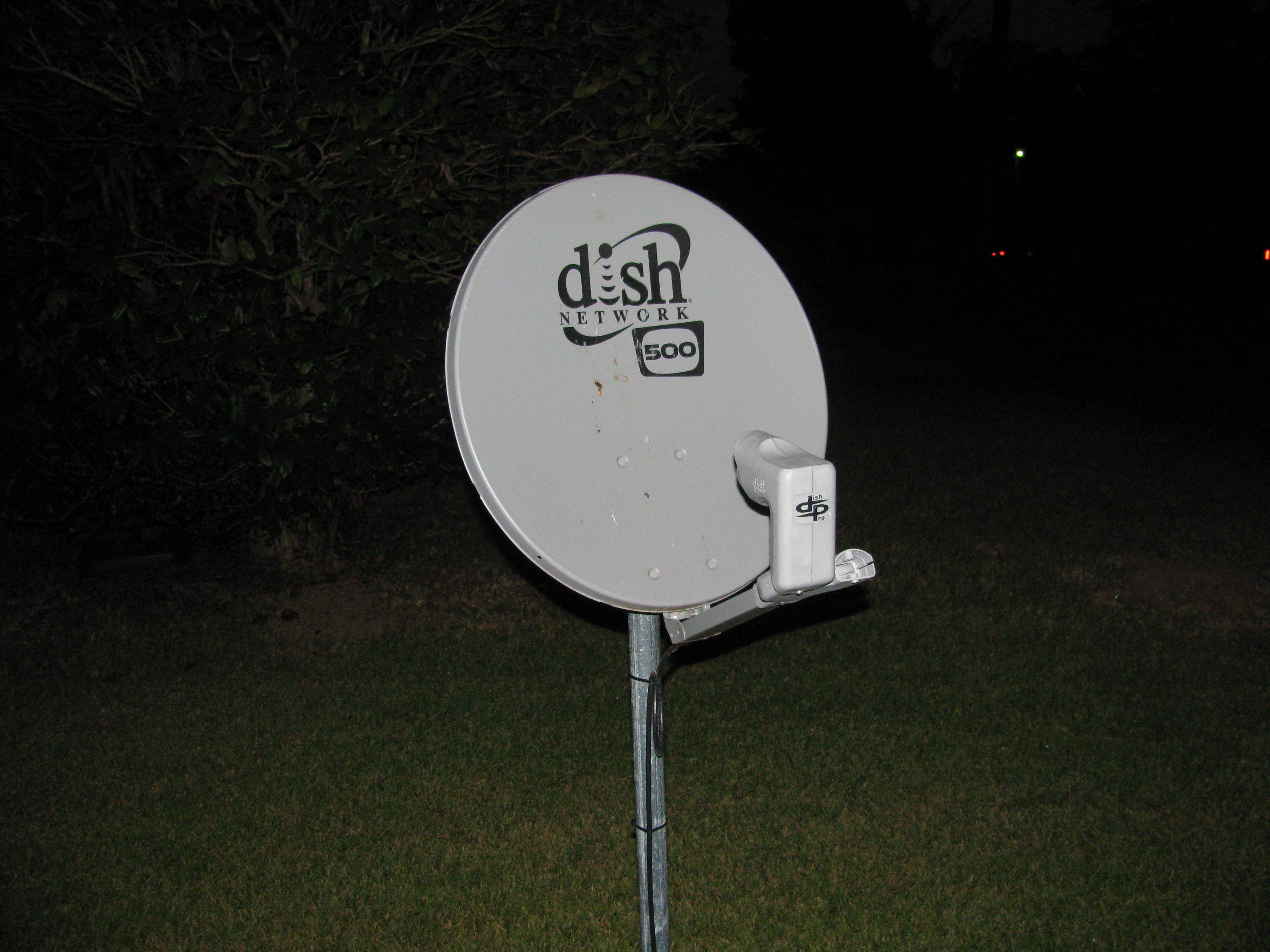

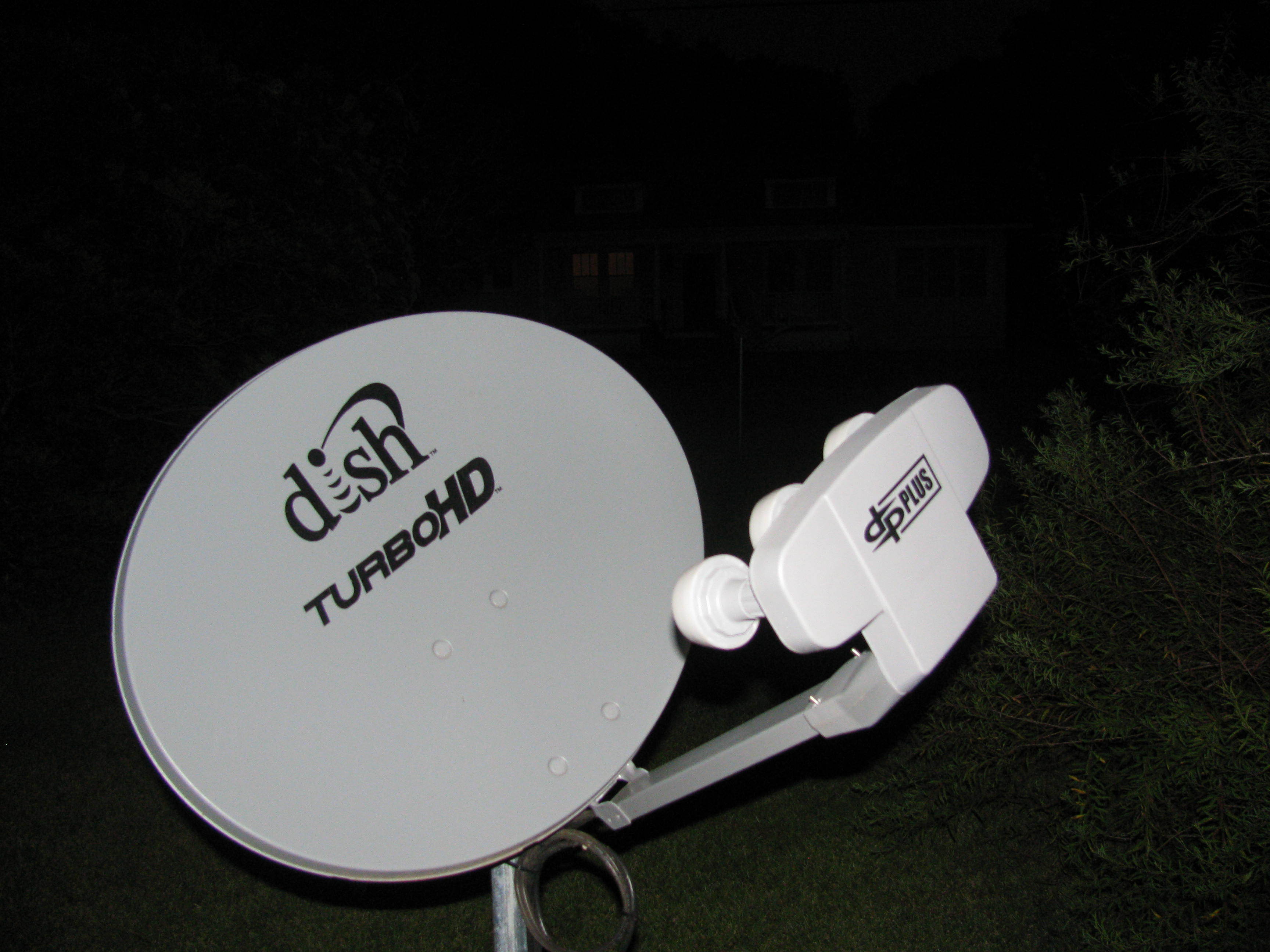

Here are my dishes. Small 61.5 I guess. Big 110, 119, 129????? What will happen to my service with this setup.
Birds big fan of the wing dish. Or not.

OK thanks. Yeah the wing dish is an eyesore in the middle of the yard but the eyes feel better watching local HD. All I need is one good hurricane to take down a few trees and my LOS will open up and I can just use 1 dish for everything. This site rocks. Type in a question/problem and have an answer in minutes.
OK. My installers connected a big dish saying(TURBO HD) 110, 119, 129 and after connection I realized I wasn't getting my locals in HD so they came back the next day and added a smaller dish (wing I guess you call it) so I could get locals in HD. I assume the smaller dish is 61.5? So with this setup, what will happen to my service?

You got setup with the wrong dish... The Jackson, MS DMA is an eastern arc city...you should have had a 1000.4 installed.

They said they couldn't use the dish I was supposed to get because of line of sight issue so I got this one plus the small wing dish for my HD locals. Is that not right? Will Dish come fix it for me the right way?
Apparently you had line of sight to 61/72/77 so they put you 110/119/129 and found a spot for 61.5. No issues there. You won't miss a thing.
