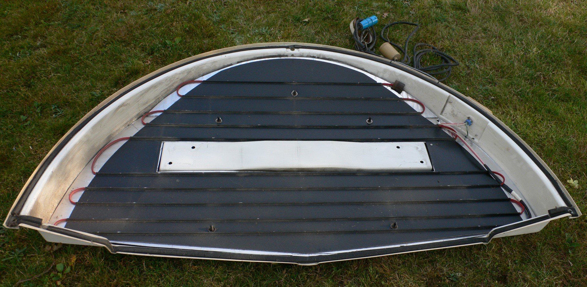

I've just installed 1.8m Prodelin. It had heating element with sensor. Picture attached:
