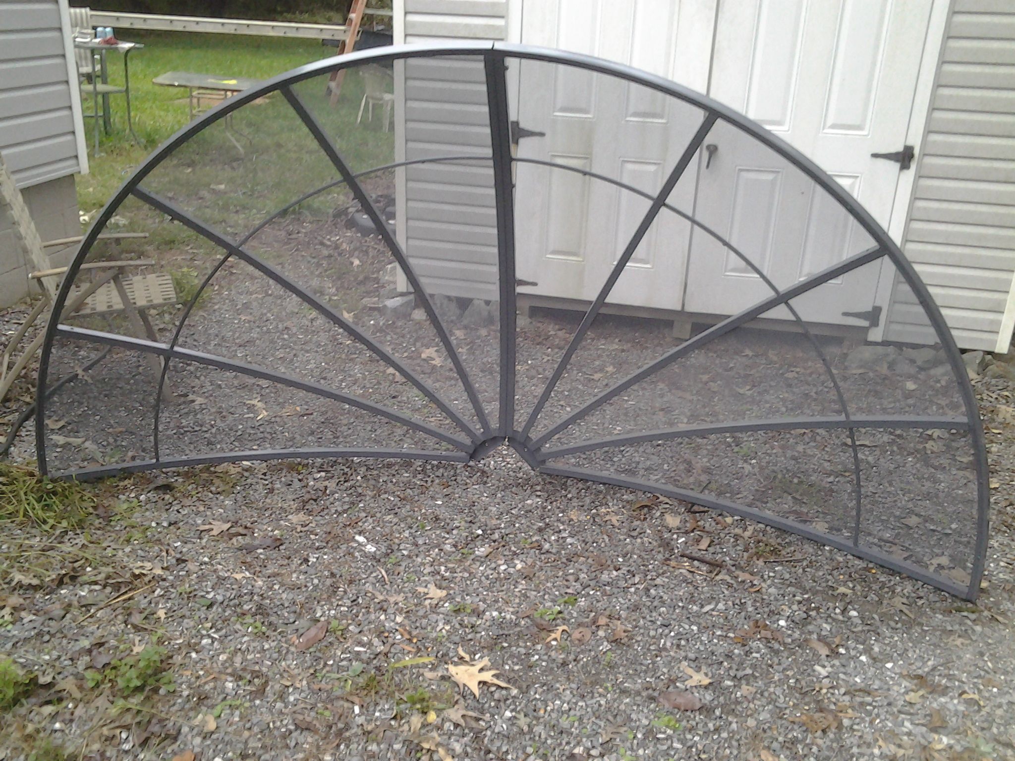

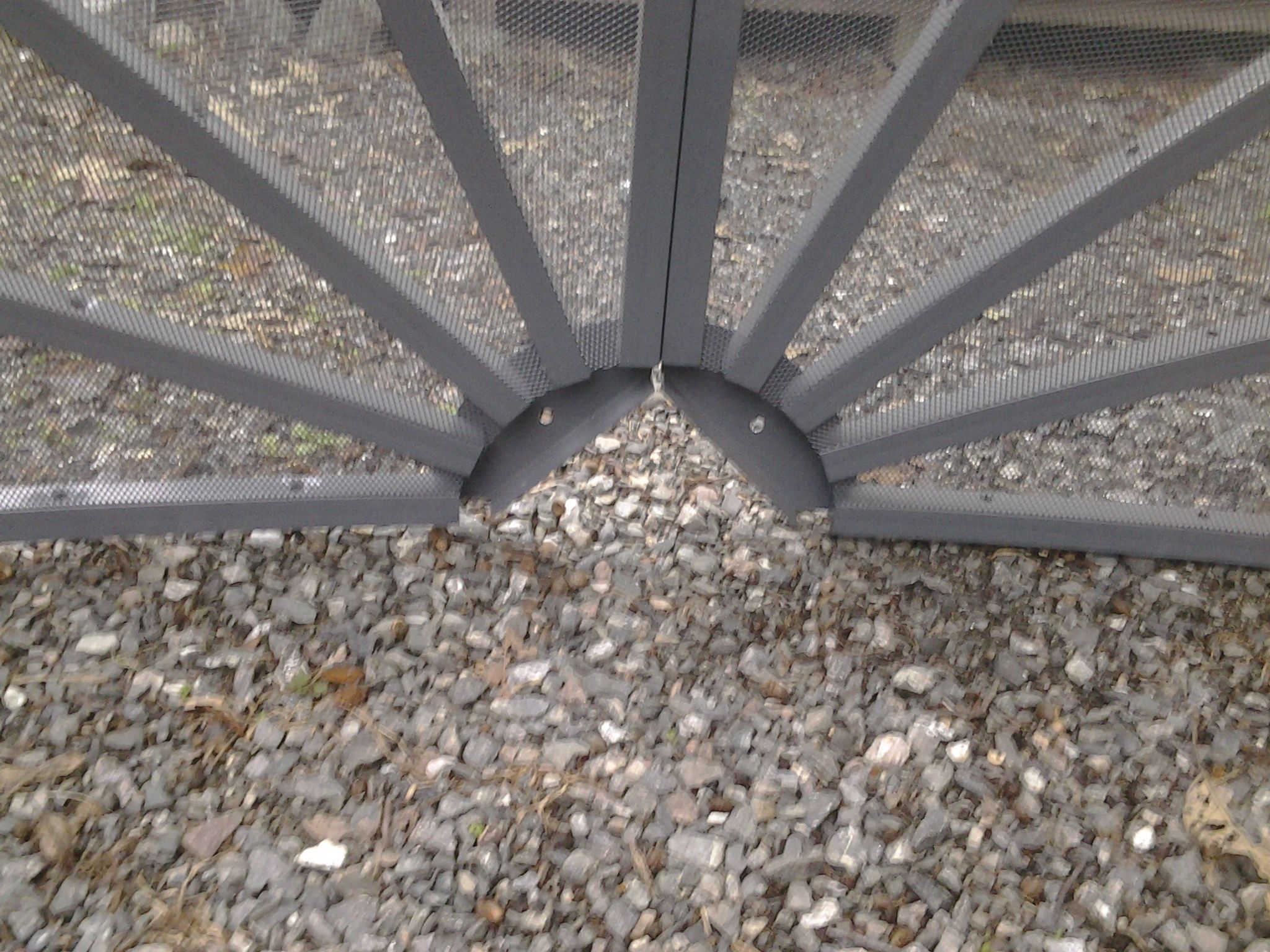

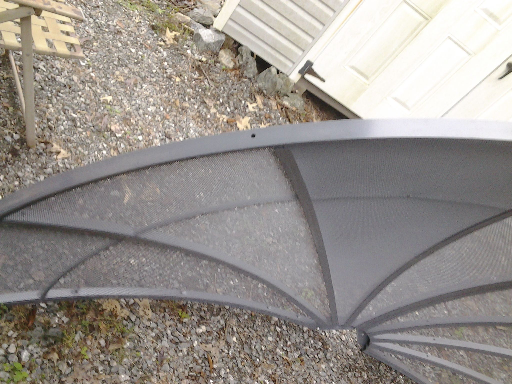

Need help to identify my latest free dish score. I know the following:
It is a 10 footer.
Depth is 22 inches
Focal length is 41 inches.
FD ratio is .34.
(I will try to attach pictures, I dont post things on the interwebs much so I hope they come through.)
It came in a box marked KTI but the specs calculated above dont match published specs found
online. I plan on using 1/2 emt to fabricte support legs. I guess I will need the feed horn support plate that the legs bolt to and a polar mount. I could also fabricate the plate and a fixed mount if I had to as wife will allow multiple fixed c band dishes. I have a Titanium C2w-pll meant for a mini bud project I can use . 20141012_081447.jpg20141012_081251.jpg20141012_081356.jpg20141012_081240.jpg
I would appreciate any info you guys have. The wife wants it in operation asap, along with the existimg 3 ku dishes she demanded.
Interesting...The Winegard Quadstar QD-1000 has a specified focal lengrh of 41 imches also.
Thanks for the info. Was your Winegard a good performer?
Sure looks like a Winegard QuadStar. The mounting ring should have 8 mounting tabs.... 4 welded to the ring, and 4 bolted to the ring. The 7-1/2 foot version uses the same mount but only has the 4 welded mounts.

IMO, the QuadStar is one of the better built units. Normally, the mount would be with the reflector when you get it but I guess that's not the case with yours. I probably have an extra mount, feed legs, and hardware that you could have but shipping is a killer on big dish parts. If you can find one locally it would be way less expensive. The reflector you have looks to be in excellent condition. If you could salvage another with the mount, locally, that would be ideal. A Winegard 7-1/2' mount will work too.

Nice dish. It looks exactly like my unimesh (branded echostar). I think back in the day that same reflector (dish) was used by Sami, Perfect 10, unimesh, etc. They where shipped with a chaparral C band only with a fixed F/D ratio of .38 (are you sure yours is .34). The feedhorn support legs fastened directly to the scalar ring. The polar mount was more or less brand specific.
Those dishes where all good performers, even for Ku if you choose the right feedhorn.

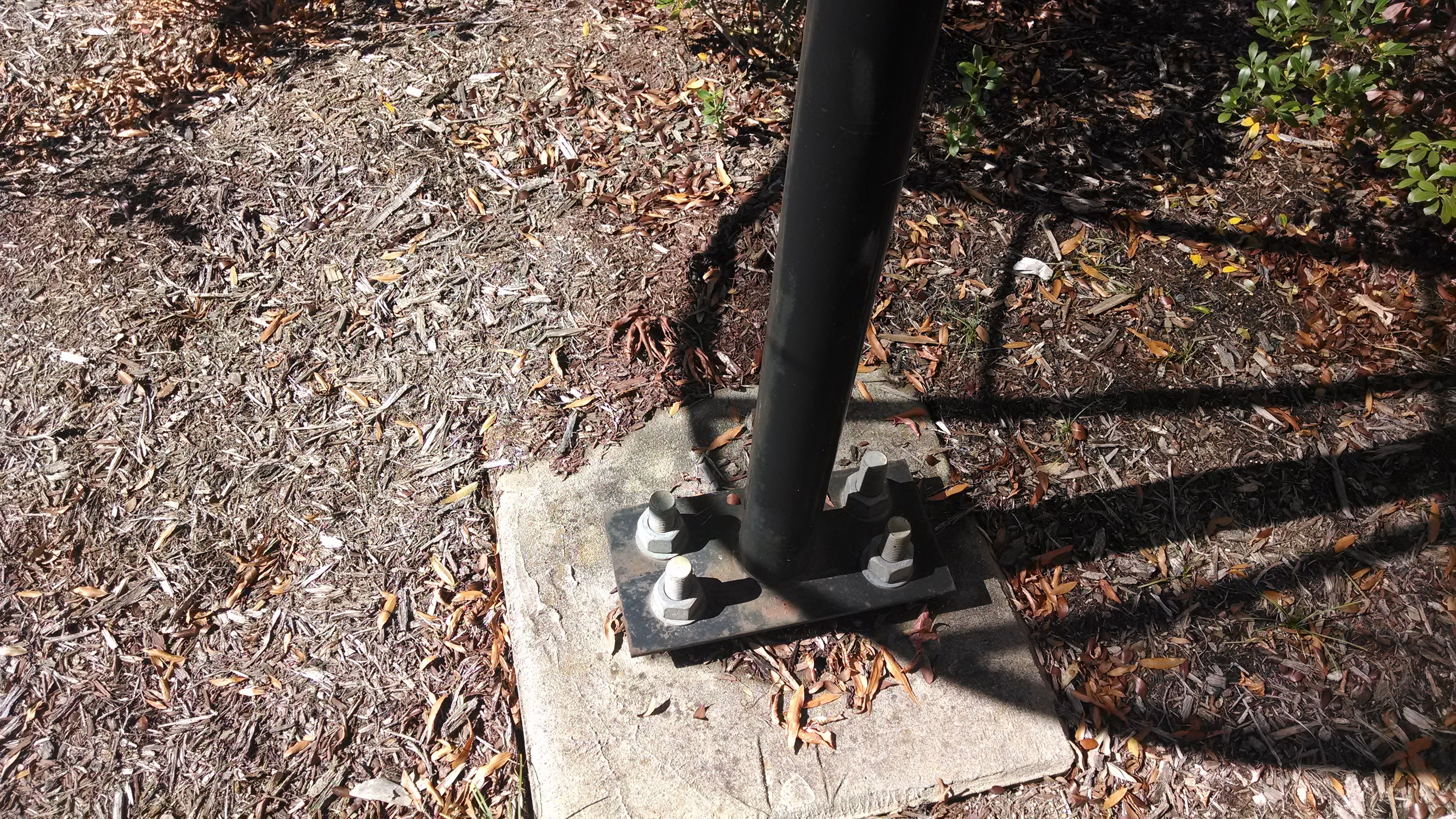

For a fixed mount I would probably use 2''x2'' thick walled square steel tubing as the "ring" if I have to go that route.
As for the pole I will copy the setup in the picture. I will increase the size of the plate to at least 12''x12'' or bigger and
weld in four solid triangular supports on the pole to the baseplate of at least 1/4 steel. Setup will have 1'' threaded rods imbedded deeply in the slab, a nut, washer, baseplate then another washer and nut, to adjust level. This is also the way they level streetlamps and stoplight masts around here.

Based on your pictures I'm pretty sure it's a Winegard but, just to be sure, check the 4 center tabs on each section (where the center plat attaches). Each should have a 2 digit (year) and a 3 digit (matching set) numbers, probably separated by a dash. If so, it's near certain a Winegard QuadStar. PM me your addy and I'll get the parts out and get a quote on shipping. I should have most everything you'll need to complete the assembly. It's great that your wife is interested. I put up a 10 footer for my wife (faux subscription) and she loves it.

Code looks like 03-94. So this dish is 20 years old? Someone kept it stored well.

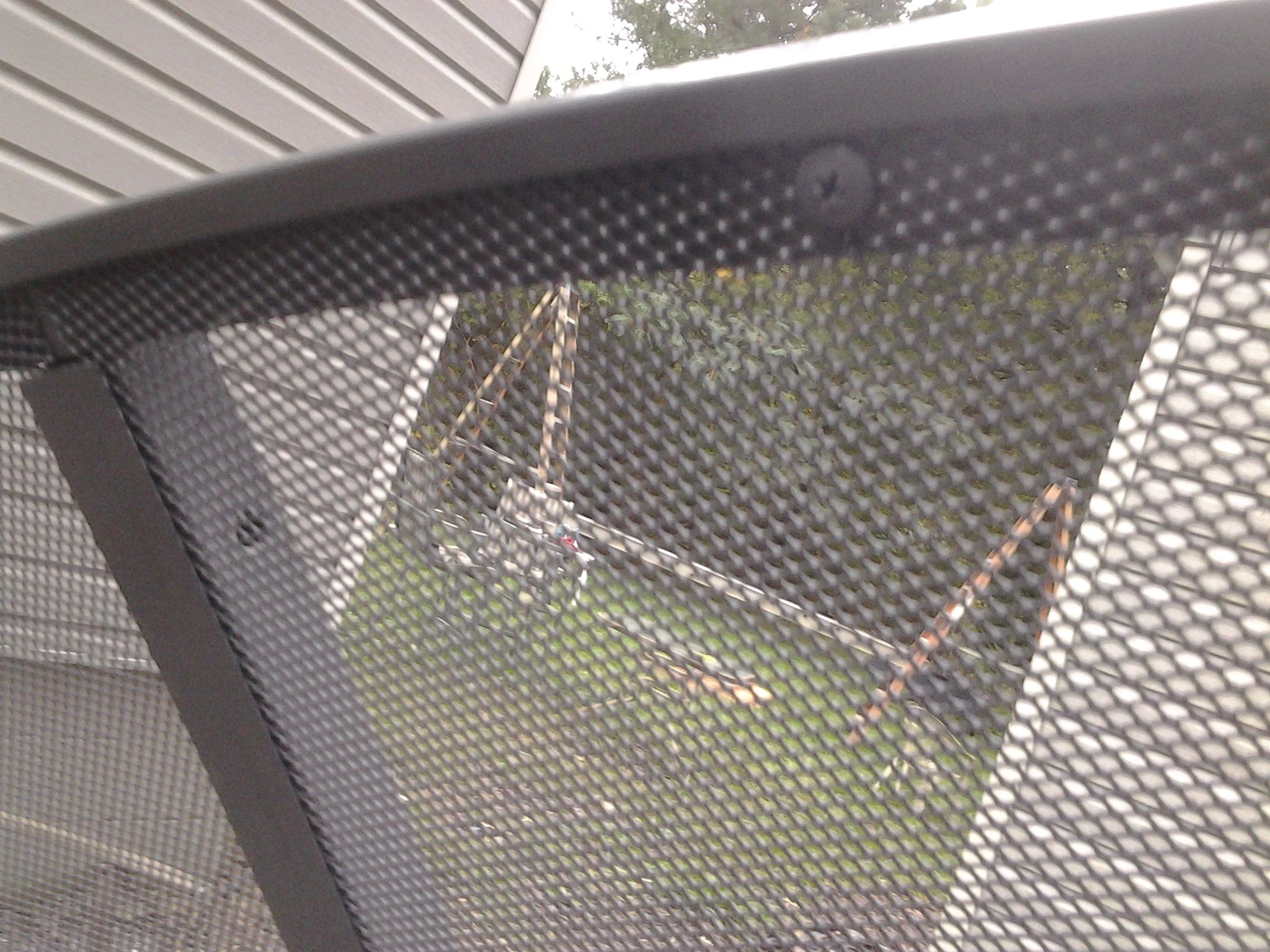

Yup, that one looks like the 10ft Winegard dish I have. The mesh in mine is held in place the exact same way as this one. That and the small round circular support tube looks like mine also.
