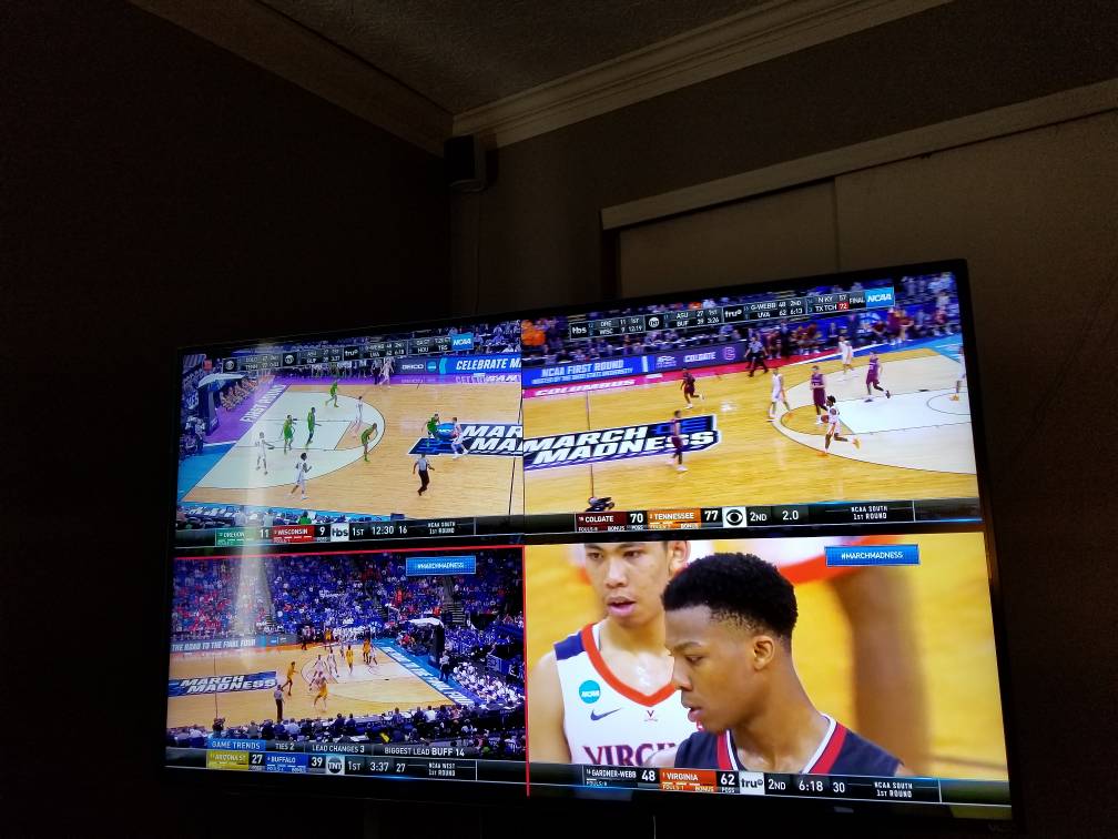

Enjoying the Hell out of my Hopper 3. Love multi view.
