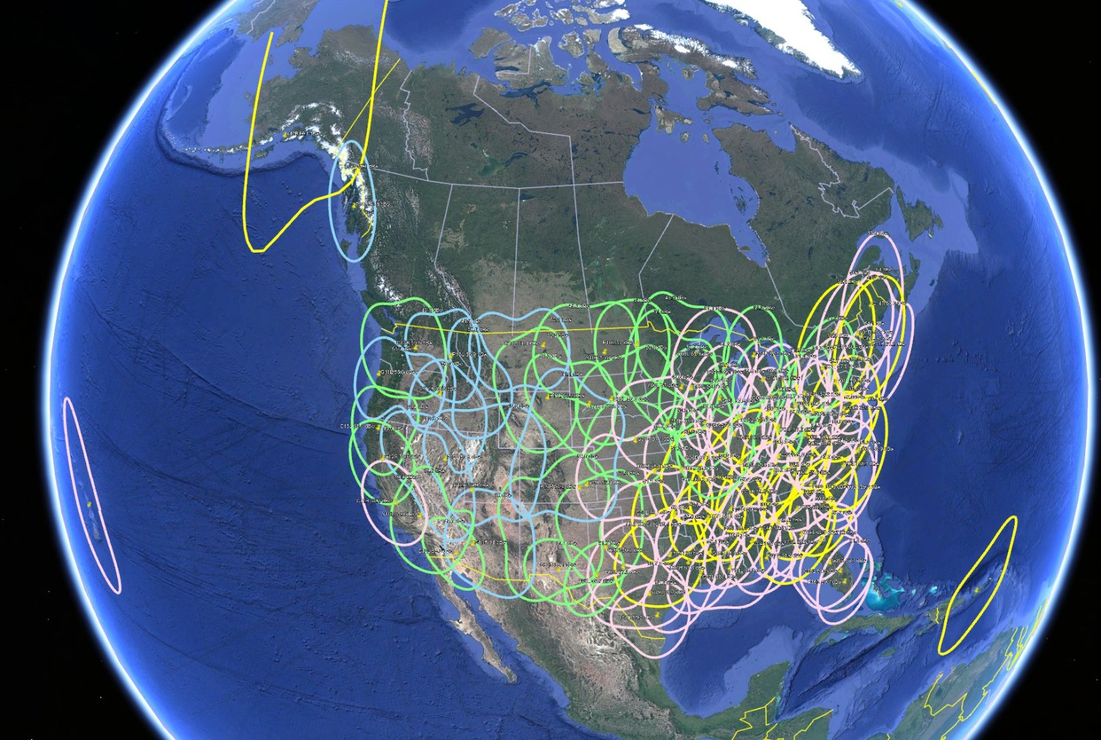

EchoStar 25 at 110W
Ninety-three (93) spot beams
51 active transmitters
212 DMAs can be served simultaneously
Possible launch - 1st quarter 2026
Google Earth photo illustrates EIRP 50dBW coverage for each spot (50 probably covers reception with a standard diameter dish.)>
Half of the spot beams with transponder links are included in the Schedule S pdf and the other half will have similar transponder linkages.
For those that like these things, This link has the downloads for the 93 Google Earth beams.

Are spot beams used only for local channel feeds?
I do not subscribe to any locals since I get them all OTA. So does this mean that down the road, I will only need to worry about signal strength and dish alignment from 119 and that none of my channels will be on the new 110 satellite?
Possibly for a while, but you never know.
Correct. 110 will be 100 percent spot beams for locals. 119w is the Conus satellite that will provide everything else.
