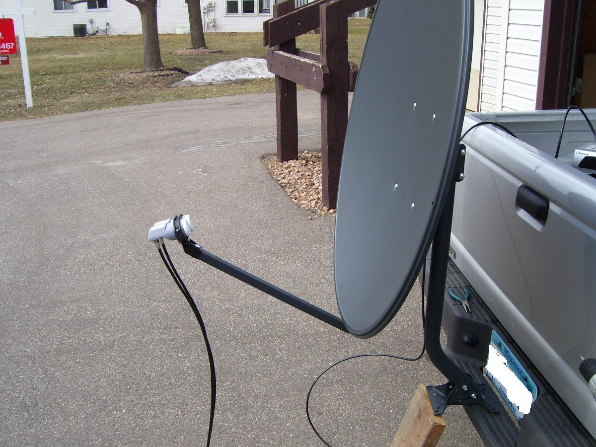

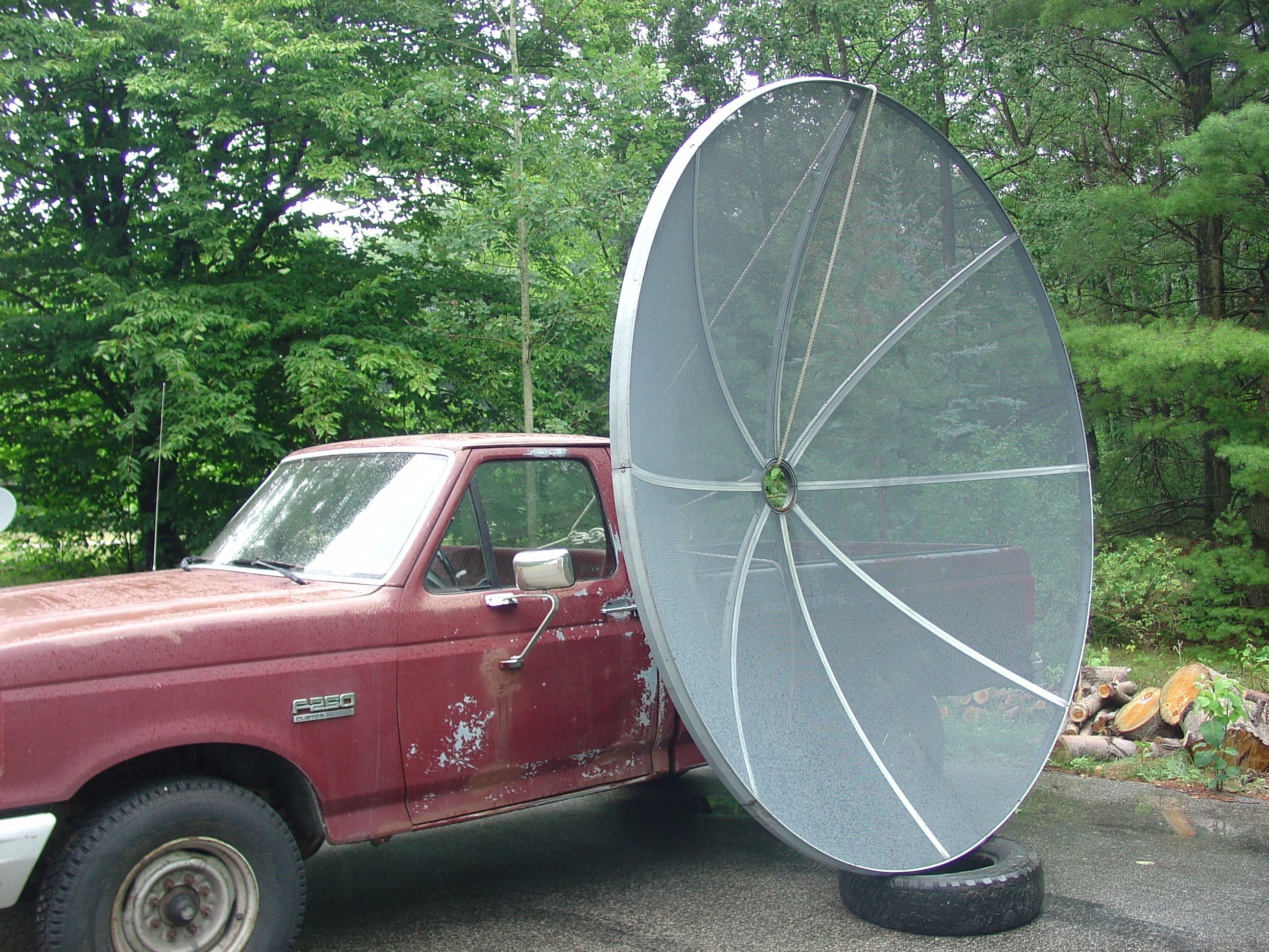

So when you make the attempt to convert a bud from a button hook to rods to hold up the ring and the feed you gotta get to the front of it. Lay it on it's face will not work. Lay it on it's back and you can't reach across it. So you stand it up and rope it to your truck!:eek:
Well.......it is working! Almost done with them.
RT.

What was wrong with the button hook? I have one on my dish, works fine?
Nice looking dish.
Arm very rusted, feed horn clamp rusted, base plate rusted, back plate rusted, most of the studs rusted and broke when removed, would have taken more hours to clean and repair than I will have spent making the rods. More fun making than cleaning. If it would have been in much better condition I would have used it. It is going to take enough time to clean up the frame and the mount.
Dish is in great condition.
RT
Right, lean it up against something and tie it off so you can reach the buttonhook. But take it off? Convert it to rods? I wouldn't.
Easier and maybe more secure to wire the scalar to the dish edge in three places. You can get thin stranded wire and steel loops with two inch rods coming off them which would work perfectly for adjusting the scalar exactly centered.
Edited
Ah I see. It's a rust bowl.
I have a Pinnacle dish with the same "rust bowl" problem. Buttonhook mount is just too far gone at the base.
Will have to convert this dish to quad legs but have already done so with an 18 panel Orbitron buttonhook. It really wasn't that difficult to fab up 1/2" emt conduit legs - it's choosing the attachment points on the edge of the dish for strength, rigidity.
Let us know what length legs & how you attached them - there are just a few of us with the same dish.

Well, I had a great day putting up the Winegard dish today. Not having too many leaves on the money tree, I could not gather the material needed to build a real lifter, so I used what I had. The only item I had to buy was the 12 foot 2 x 6 for the boom. All went well. Lots of up and down when you work alone on something like this. Managed to pick up one sat before dark. Will work on it more on Sunday.
Brex2001-I will post pics and leg lengths on Sunday and how I attached them without messing with the mesh support arms.
RT.
Nice construction crane :). Great idea. Safe and functional. A bit if ingenuity goes a long way.
This is what I came up with to mount the arms.
Brex2001, The rods/arms I made are 57" long. They will, as expected, change depending on where you mount them to the dish.
RT.
