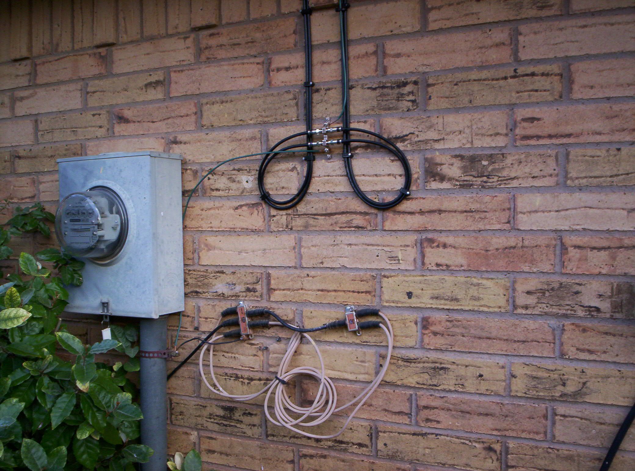

you can see cox cable and thier bond below mine

sheridan said:
Okay, I didn't specify. But I did say earlier that mine is on a metal pole. I am about to do some rewiring and make a few changes, and one of those would have been to put the blocks on the pole. That's why I was asking why you felt they should be inside.
inside, and grounded to a non interrupted cold water pipe, the entrance panel ground, the meter socket ground or a doublewide/trailer frame. and the ground wire HAS to be shorter coax run from the dish to IRD if it isnt it is worthless.
