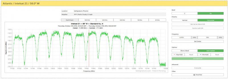

https://satsignature.com/plot/atlantic/intelsat-21
Sat Signature website Spectrum shows both H and V KU transponders for Sky Mexico, but I can't see 58W from my location. Not sure if it has any FTA KU channels?
I've never seen anything ITC on 58W Ku. Almost everything is on the Brazil beam anyway.
I believe there is 1 scrambled tv channel on the america/europe beam and there are a few data streams
