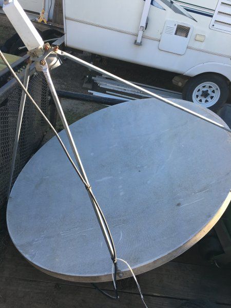

Was at the lumber yard this afternoon returning a few things and i noticed a dish on the roof. I asked the owner what that was for and apparently they used to use it for tru-value radio several years back. He then says to me ill lift you up there in the man lift if you want it. So now i have a test unit. got it down and it is infact a 1.2m dish. Havent figured out the manufacturer yet.

That's a nice Channel Master dish, great find and a keeper! I have one trained on 103W for Ku.
The fellow that had my aformentioned dish had been using it as a mini-bud, and had fabricated a bracket that I didn't think worked properly. It held the C-band LNBF too high and above the designed focal point, so when the dish was re-focused to compensate the focal pint would be a bit distorted. If one were to shorten the bottom support rod (or fabricate another one that is about an inch shorter just for C-band mini-bud testing) about an inch that would drop the LNB mount assembly about 2-3 inches, making it possible to find the poroper focal point for the feed horn placment. Might make up another dB of signal, when every dB counts!

Thanks for the tip! I'll fabricate a new one for my tests. Its been out in the open for a while and is in dire need of cleaning. I havent touched it yet as i spent pretty much all day yesterday working on the BUD.
I was over at the shop yesterday messing around and i started looking at this dish. I have my titanium scaler kit and lnbf so ill buy some square aluminum tubing to make the new lower lnb support so that it will accept the lnb bracket from the scaler kit and would presumably accept the ku bracket like what is on my geosat pro 90 cm. Looks to me like i will also need to fabricate new side brackets as well and attach them also similarly to how the support brackets attach on the 90cm dish. my question is this do i need to record the angle the lnb that is currently on the dish? The dish is textured but there is a smooth round dot (maybe 1/4 to 1/2 inch diameter) just below what center of the dish would be. Is this the focal point? and should i measure the distance from this point (or what ever area the focal point is) to the lnb currently installed on the dish? I would guess the distance would be similar with a c-band lnbf. Hopefully someone with mini bud experience could chime in and give me a little direction. Thanks.
